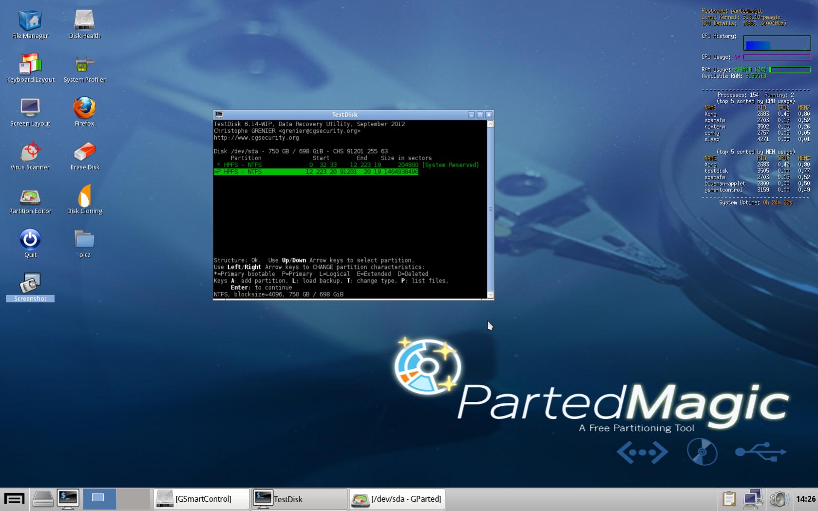

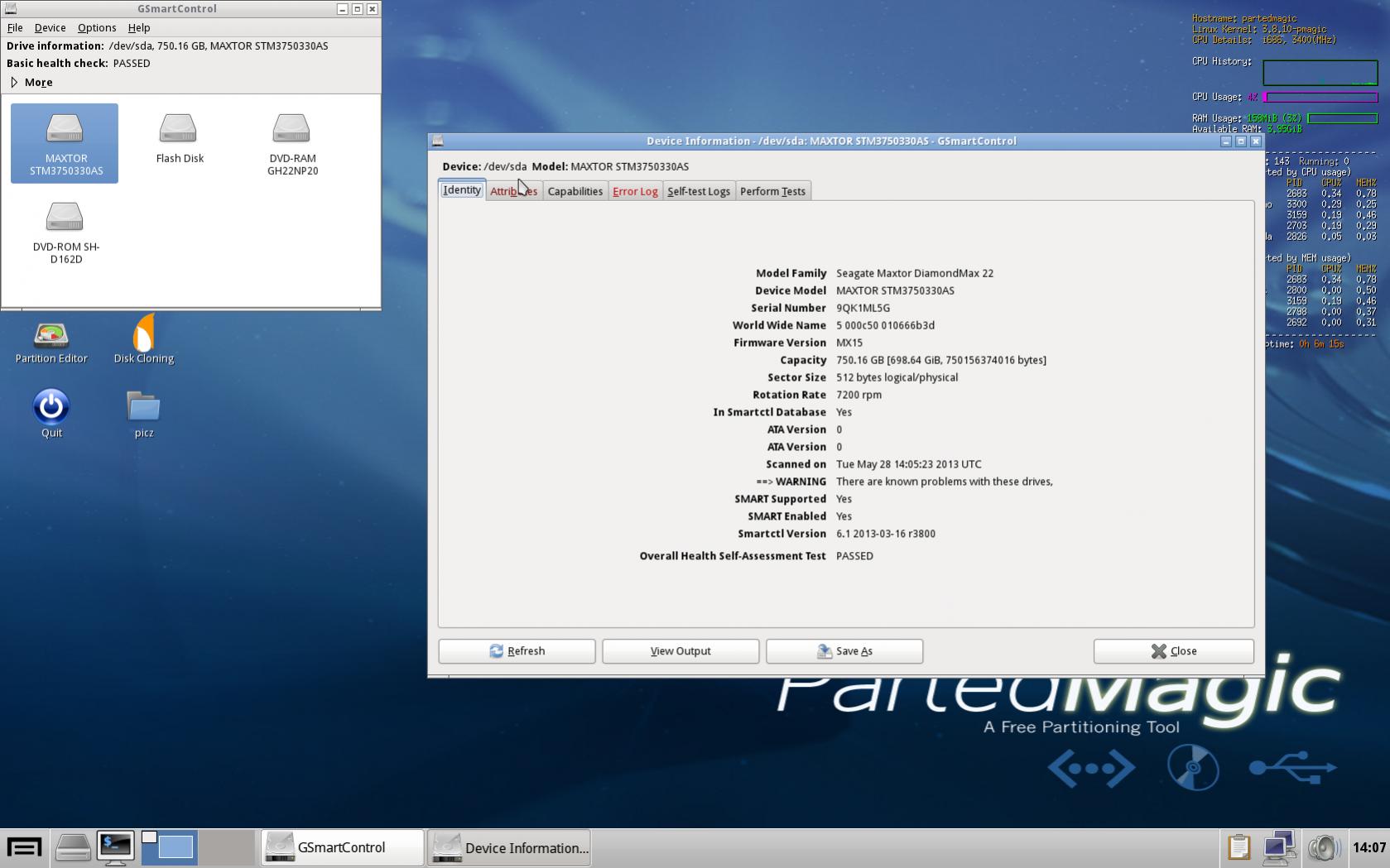

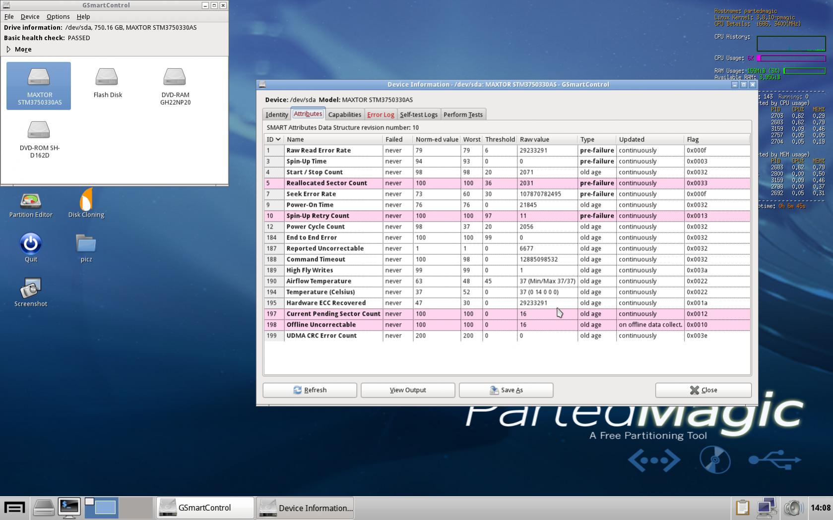

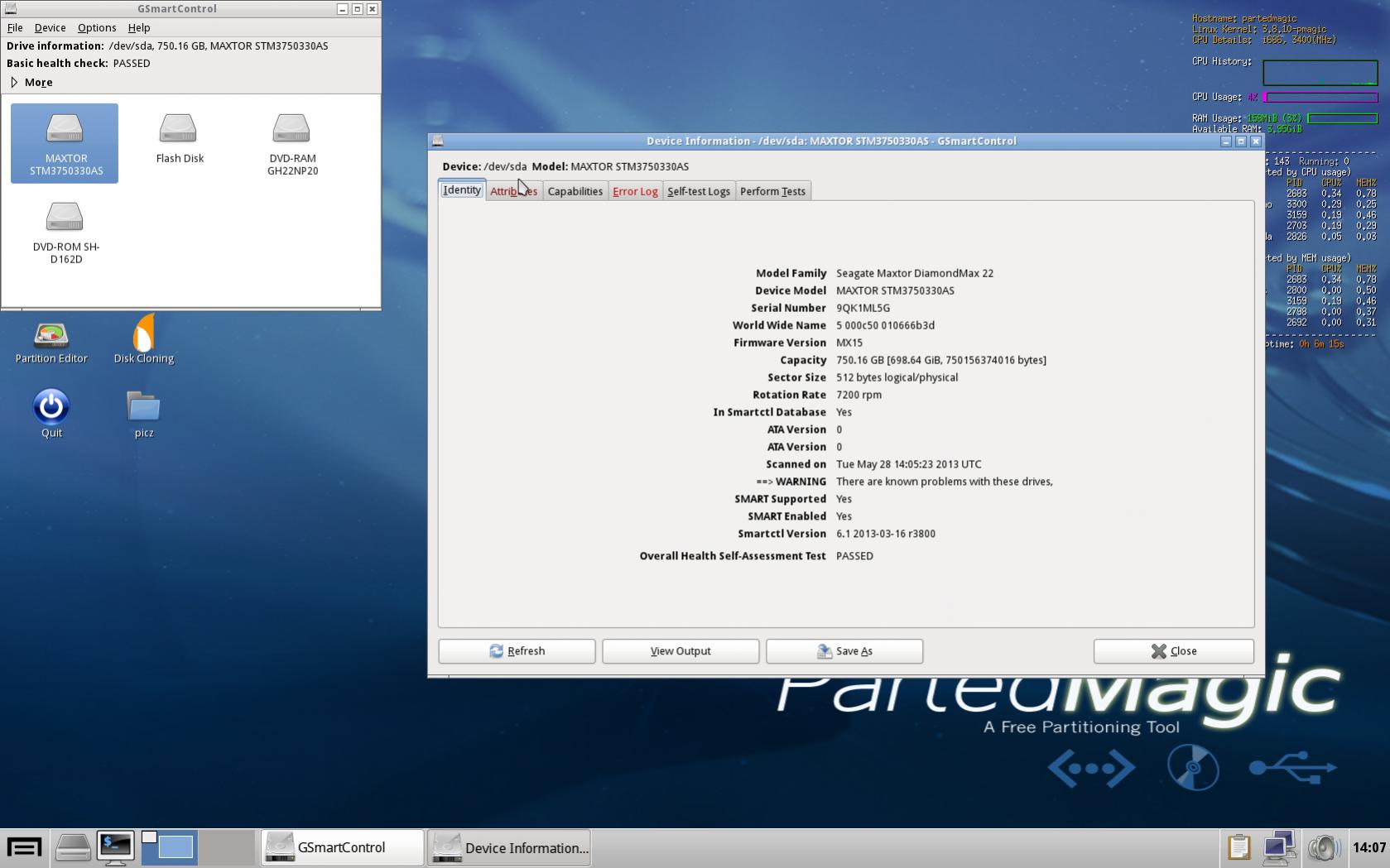

Bin grad mit PartedMagic mal drin und paar Screens gemacht. Sau komisch ist vor allem das bei TestDisk mal die Partitionen angezeigt werden und mal nicht.

=== START OF INFORMATION SECTION ===
Model Family: Seagate Maxtor DiamondMax 22
Device Model: MAXTOR STM3750330AS
Serial Number: 9QK1ML5G
LU WWN Device Id: 5 000c50 010666b3d
Firmware Version: MX15
User Capacity: 750,156,374,016 bytes [750 GB]
Sector Size: 512 bytes logical/physical
Rotation Rate: 7200 rpm
Device is: In smartctl database [for details use: -P show]
ATA Version is: ATA8-ACS T13/1699-D revision 4
SATA Version is: SATA 2.6, 3.0 Gb/s
Local Time is: Tue May 28 14:10:10 2013 UTC
==> WARNING: There are known problems with these drives,
AND THIS FIRMWARE VERSION IS AFFECTED,
see the following Seagate web pages:
http://knowledge.seagate.com/articles/en_US/FAQ/207931en
http://knowledge.seagate.com/articles/en_US/FAQ/207969en
SMART support is: Available - device has SMART capability.
SMART support is: Enabled
=== START OF READ SMART DATA SECTION ===
SMART overall-health self-assessment test result: PASSED

SMART Attributes Data Structure revision number: 10
Vendor Specific SMART Attributes with Thresholds:
ID# ATTRIBUTE_NAME FLAG VALUE WORST THRESH TYPE UPDATED WHEN_FAILED RAW_VALUE
1 Raw_Read_Error_Rate 0x000f 079 079 006 Pre-fail Always - 29233291
3 Spin_Up_Time 0x0003 094 093 000 Pre-fail Always - 0
4 Start_Stop_Count 0x0032 098 098 020 Old_age Always - 2071
5 Reallocated_Sector_Ct 0x0033 100 100 036 Pre-fail Always - 2031
7 Seek_Error_Rate 0x000f 073 060 030 Pre-fail Always - 107870782771
9 Power_On_Hours 0x0032 076 076 000 Old_age Always - 21845
10 Spin_Retry_Count 0x0013 100 100 097 Pre-fail Always - 11
12 Power_Cycle_Count 0x0032 098 037 020 Old_age Always - 2056
184 End-to-End_Error 0x0032 100 100 099 Old_age Always - 0
187 Reported_Uncorrect 0x0032 001 001 000 Old_age Always - 6677
188 Command_Timeout 0x0032 100 098 000 Old_age Always - 12885098532
189 High_Fly_Writes 0x003a 099 099 000 Old_age Always - 1
190 Airflow_Temperature_Cel 0x0022 063 048 045 Old_age Always - 37 (Min/Max 37/37)
194 Temperature_Celsius 0x0022 037 052 000 Old_age Always - 37 (0 14 0 0 0)
195 Hardware_ECC_Recovered 0x001a 047 030 000 Old_age Always - 29233291
197 Current_Pending_Sector 0x0012 100 100 000 Old_age Always - 16
198 Offline_Uncorrectable 0x0010 100 100 000 Old_age Offline - 16
199 UDMA_CRC_Error_Count 0x003e 200 200 000 Old_age Always - 0

CR FR SC SN CL CH DH DC Powered_Up_Time Command/Feature_Name
ec 00 00 00 00 00 a0 00 00:16:58.537 IDENTIFY DEVICE
00 00 00 00 00 00 00 04 00:16:58.386 NOP [Abort queued commands]
00 00 00 00 00 00 00 ff 00:16:57.778 NOP [Abort queued commands]
a1 00 00 00 00 00 a0 00 00:16:57.757 IDENTIFY PACKET DEVICE
ec 00 00 00 00 00 a0 00 00:16:57.719 IDENTIFY DEVICE
Error 25191 occurred at disk power-on lifetime: 21844 hours (910 days + 4 hours)
When the command that caused the error occurred, the device was active or idle.
After command completion occurred, registers were:
ER ST SC SN CL CH DH
04 71 04 9d 00 32 e0 Device Fault; Error: ABRT
Commands leading to the command that caused the error were:
c8 00 08 c8 ff 65 e0 00 00:16:44.589 READ DMA
c8 00 18 e0 e9 64 e0 00 00:16:44.588 READ DMA
c8 00 80 60 e9 64 e0 00 00:16:44.588 READ DMA
SMART Self-test log structure revision number 1
Num Test_Description Status Remaining LifeTime(hours) LBA_of_first_error
# 1 Short offline Completed: read failure 90% 21845 701200
# 2 Short offline Completed: read failure 90% 19880 713713
# 3 Extended offline Completed: read failure 90% 19880 713713
SMART Selective self-test log data structure revision number 1
SPAN MIN_LBA MAX_LBA CURRENT_TEST_STATUS
1 0 0 Not_testing
2 0 0 Not_testing
3 0 0 Not_testing
4 0 0 Not_testing
5 0 0 Not_testing
Selective self-test flags (0x0):
After scanning selected spans, do NOT read-scan remainder of disk.
If Selective self-test is pending on power-up, resume after 0 minute delay.
