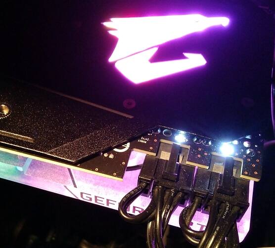

Hello.
Gigabyte 2080 Ti Aorus Waterforce Xtreme
The LED lights are located above the PCIe power connectors on the card.
When card is underload i can see white lights near pcie 2 connectors. Not blinking. Just white lights continuously. No problem in stability,clocks are normal.
Psu is Seasonic ULTRA TX 750W Platinum. Anybody have the same card?
Card is plugged by 2 separate pcie cables.
Anyone is this normal or not?:)Card is performing excellent. Just that lights under load
ok :) yes card working excellent,just that lights confused me a little.

I am using two separate cables from PSU. They are connected to card 2 slots. Still 2 white lights. Also not only me have that lights under load,there are some peoples with the same card and the same 2 white lights.
My psu is Seasonic 750 W TX ULTRA TITANIUM. No problems with stability and no issues. So why i have that 2 lights?

HEY! I restarted pc and now logo on gpu are moving ( before was constant pink colour on aorus logo )and no white lights near 2 pcie connectors. So no worries?
So. The power led indicators light up for some reason and do not turn off until i restart pc. After restarting PC, they do not light up. At the same time, the logo stopts to play with colors, and burns constantly.
Even if I load the card heavily, the indicators do not turn on.
It happens sometimes on loading screen in 3dmark Port Royal. Also performance and clocks are not affected. Just that 2 constant power led white lights and gpu aorus logo stuck on 1 colour.
When i reboot pc ,gpu logo is changing again colours and i dont see that power led pcie 2 white colours.
Can i ignore this??
Ok i resolved. I know why that happens sometimes in 3dmark loading screen time spy or port royal. because card is hitting power limit ( green on gpuz ) and then card pop up that 2 white lights. Nothing to worry about. I think its bios or something. anyway thx
