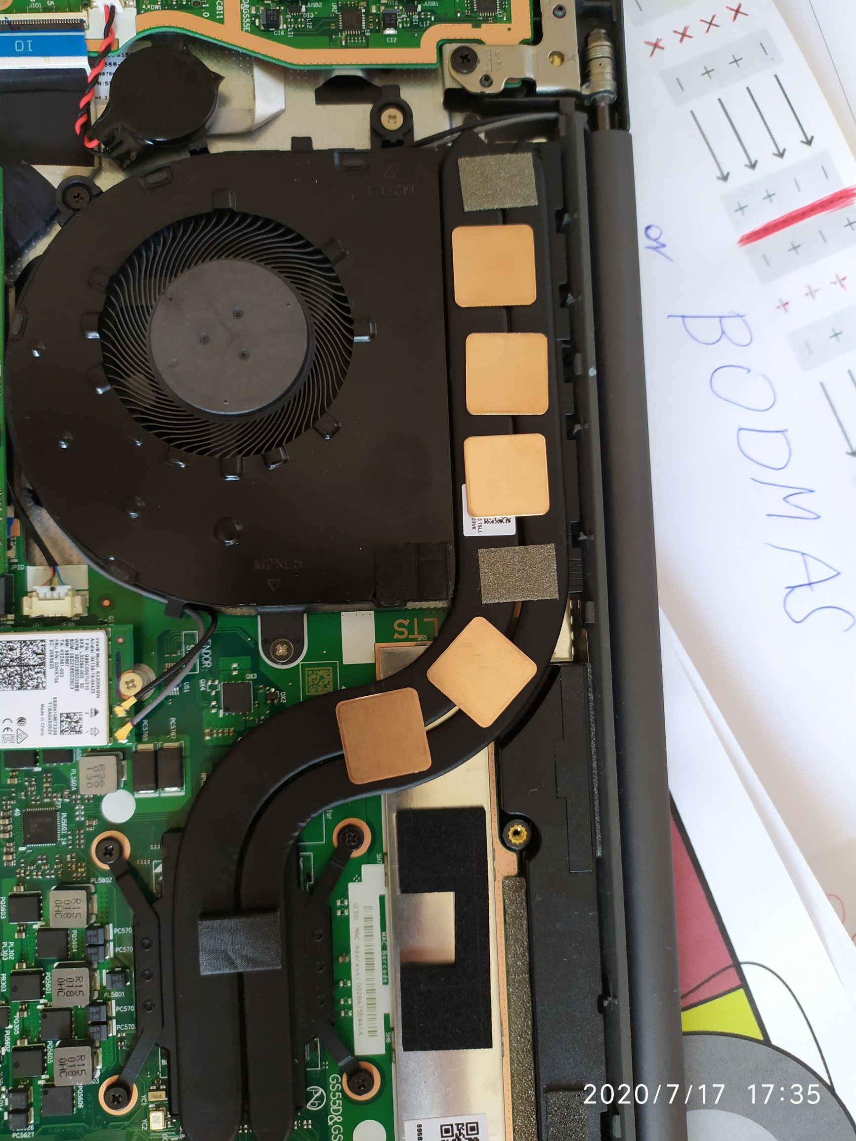

nutsandbolts schrieb:Will a heat sink modification help the temperatures come down? I have the below copper squares and thinking of sticking with thermal pads. It may be possible to stick some on the shiny copper surface and some on the painted one. Any thoughts? Sorry about writing in English
I did exactly that with the exact same copper. I did spread 10 of them on the Heatsink and after few tests im getting around 3-4° lower Temps....os it really worth....i dont know....to me it was fun to do and only took me half an hour......if you have the copper and the thermal pads...go for it.
Its pretty simple physics...at the end you get more area for the heat to spread....in this case...the more the better.
Sure, but ... sticking copper pads on a surface will not significantly increase the surface area. The top surface of the copper pad has the exact same area as what it is sticking on, the only additional surface is the edge of the copper pad. How can this possibly lead to such a dramatic difference in temperatures, in an unventilated space within the case no less?BusiG schrieb:Its pretty simple physics...at the end you get more area for the heat to spread
Also, those new Ryzens are temperamental beasts, temperatures fluctuate wildly. I can run multiple tests just to see more than 5°C difference between them, both at the bottom and the top end of CPU load, and even tiny usage spikes will bump the temperature around by 10 or 15°C. Not saying you are wrong, but how would you be able to consistently tell a 3 to 4°C difference?
(Edit, just to note: I would love to be wrong on all of this, and I will gladly stand corrected.)

But without any circulation these will not do anything..
The only way I could imagine an improvement is to thermally couple the heat-pipe to the lower cover of the chassis. But that is plastic... If it was from aluminum, it would work.

henfri schrieb:But without any circulation these will not do anything..
Greetings,
Hendrik
Puhh... if you like experiments

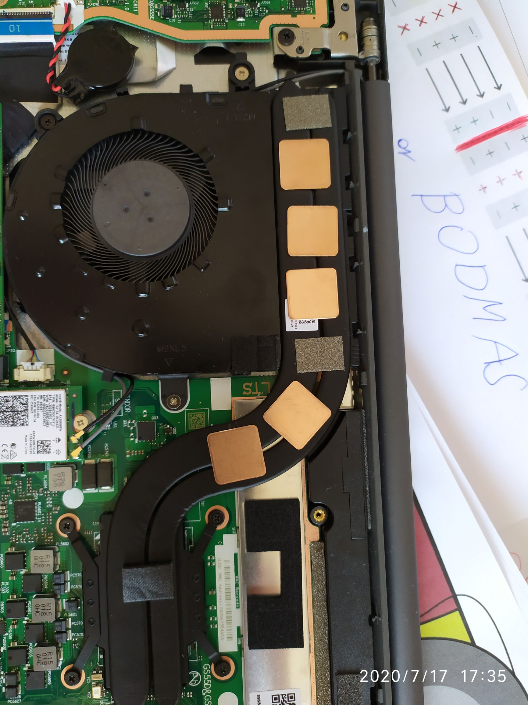

How about these copper tubes
https://www.aliexpress.com/item/329...00300f7c&algo_expid=037ecdf--1995cc-50d506509
I have ordered one (15 cm). I took measurements and would try to stick it on the shinny side.
If these could be glued together with other two copper heat pipes, they might dissipate heat quicker and reduce tempratures ?
did you check whether their 3mm height will fit? They might improve the cooling capability of the system, but only if the current bottleneck of the cooling system are the heatpipes. It's possible that right now the heatpipes aren't the limiting factor but instead the fin-stack cooler's ability to dissipate heat fast enough. I guess you'll find out soon. If the additional heatpipe doesn't give you any improvement, then you have to increase fan speed for it to matter.nutsandbolts schrieb:I took measurements
nutsandbolts
- Juli 2020
- 4
I did check they would be tight. There is some gap between the two copper heat pipes. they might come in a month or so. Any how will give it a try...
Those are not "copper tubes", I mean they are, but more specifically: those are heatpipes. Heatpipes transport heat from one end to the other. The thing you are planning to stick them onto ... is also a heatpipe: It transports heat from the CPU over to the fins of the cooler. It is not meant to cool, it is not good -- or even supposed to be good -- at cooling. Any cooling it does is purely a minor side effect.nutsandbolts schrieb:How about these copper tubes
Again, I would love to be wrong about this, but I think I am not: Sticking random things to the middle of a heatpipe, especially in an unventilated area, will not make any significant difference.
Edit: On the other hand, the heatpipes in our Ideapad are extremely good at what they are supposed to do. If you look at the temperatures, it is no problem for them to shove 20, 30°C from the CPU to the cooler fins in a matter of seconds.

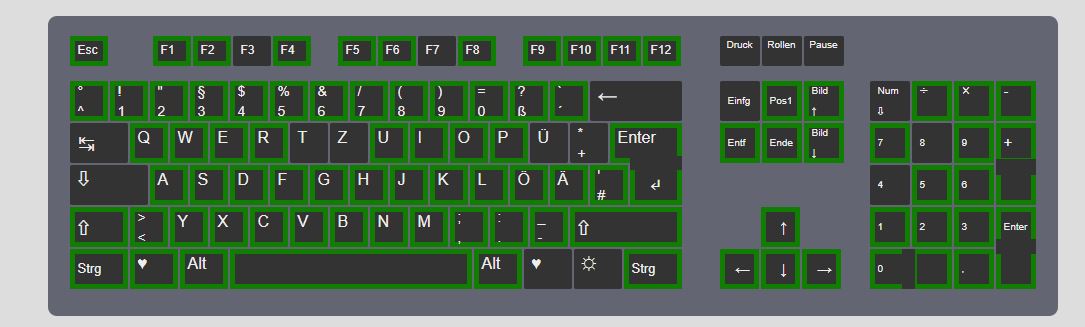

Hatte von euch schon jemand Probleme mit der Tastatur?
Sitze gerade im Büro und kann mich nicht ins Windows anmelden weil einige Tasten nicht reagieren.
t, z, ü und Rücktaste gehen nicht.
Es ist keine Flüssigkeit über dem Laptop ausgelaufen.
Edit: Mit einem Tool gerade getestet:
linke Shift-Taste geht auch nicht, wurde nur grün markiert durch die rechte Shift-Taste
Schnipp959 schrieb:Hatte von euch schon jemand Probleme mit der Tastatur?
Und vorher hat alles funktioniert? Wurden irgendwelche Updates installiert?
Vielleicht kannst du mal ins BIOS gehen und gucken, ob die entsprechenden Tasten dort funktionieren? Z. B. versuchen ein User-Passwort zu setzen. Du kannst ja mit Esc noch abbrechen. Mit F2 kommst du ins BIOS. So schließen wir aus, dass irgendwelche Treiber da etwas verpfuscht haben.
Schnipp959
- Apr. 2011
- 930
Versuche gerade mit einem Ubuntu-Live USB Stick es zu probieren.
Externe Tastatur funktionierte unter Windows.
Ok, irgendwie wollte Ubuntu wohl nicht so recht, bin gerade ins Bios um zu versuchen ein Passwort zu setzen, auch da gehen t und z nicht.
