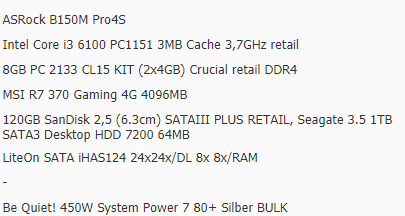

789775
Monitor:
ASUS VS248HR Full-HD Monitor (, 60 Hz)
