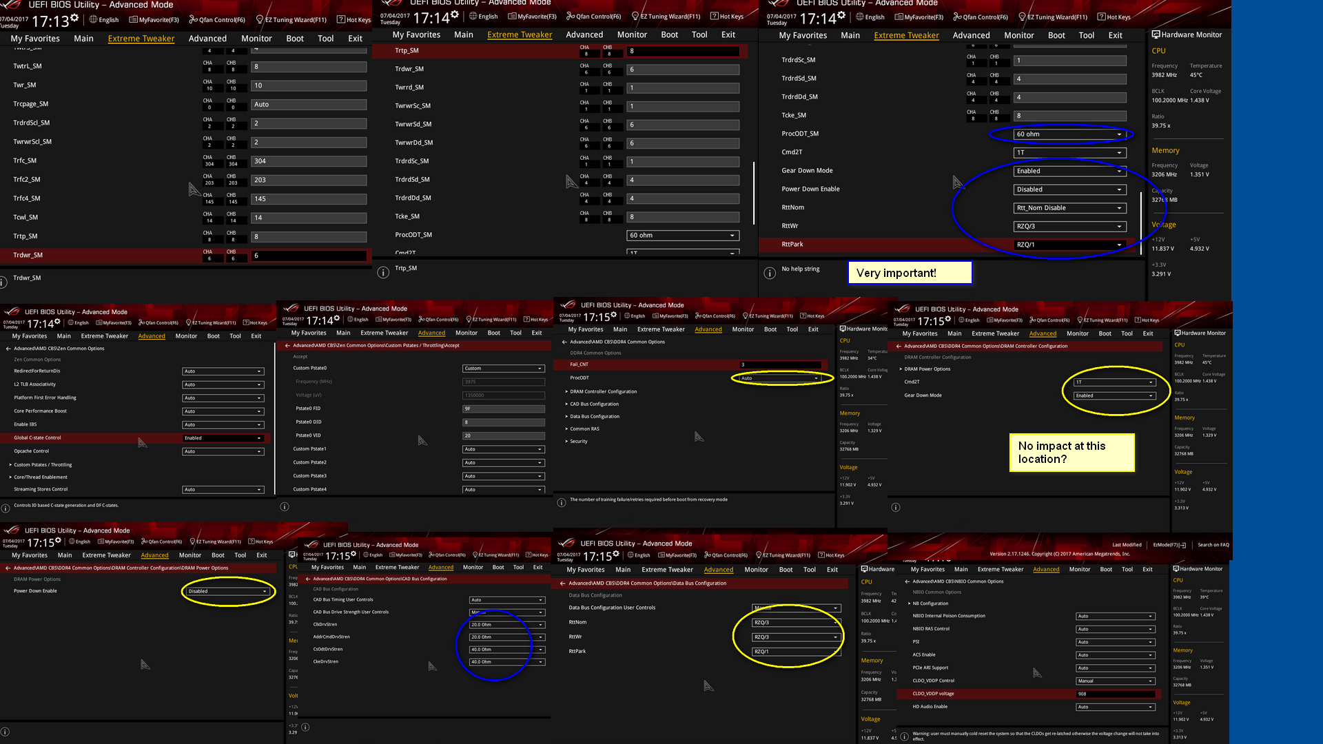

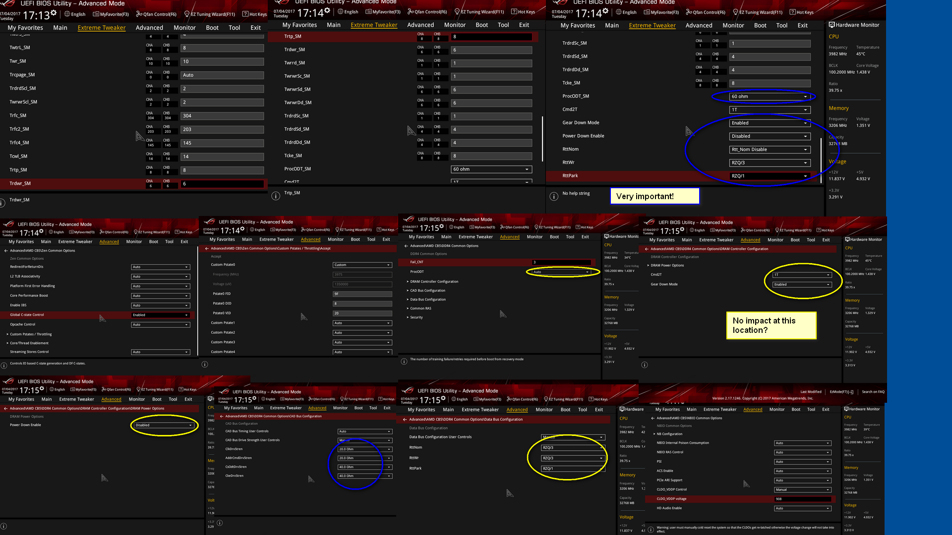

Im Grunde so wie schon gestern nur jetzt mit Tfaw@ 29
1800X@3980MHz mit PState OC @1,395V
2x16GB G-Skill Trident Z(Samsung B) @3205MHz CL14 13 13 13 26 42 | 5 7 29 4 8 10 Auto(0) 2 2 304 203 145 14 8 6 1 1 6 6 1 4 4 8
Euler3D Benchmark avg aus 5 Messungen 10624MHz bei 20 steps 16 threads
Aida64 gestern aus 5 Messungen gemittelt:
read: 50046 +-73 write: 48965 +-115 copy: 49123 +-351 [MB/s]
Latency 68,14 +- 0,11 [ns]
ProcODT@60, RTTxxx@(Disabled, RZQ/3, RZQ/1), CAD BUS@(20 20 40 40)
Gear Down Enabled, Power Down Disabled, Bclk@100.2 CLDO_VDDP Voltage @ 908
CPU Voltage + 0,1V
soc Voltage@ 1.05V
DRam Voltage@1.355V(Auch Bootvoltage 1.355V)
EPU Power Saving disabled

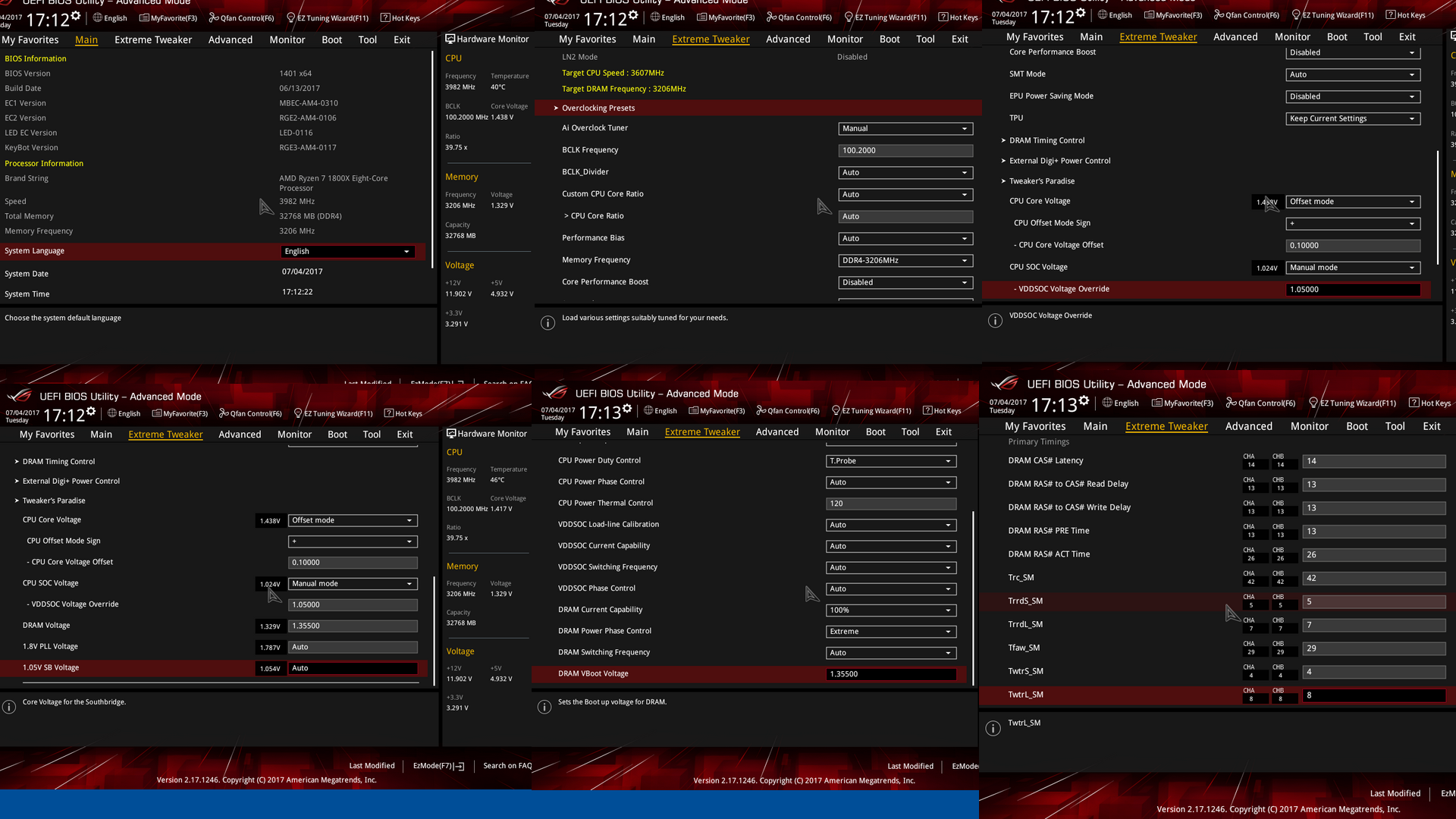

[2017/07/04 18:42:04]
Ai Overclock Tuner [Manual]
BCLK Frequency [100.2000]
BCLK_Divider [Auto]
Custom CPU Core Ratio [Auto]
Performance Bias [Auto]
Memory Frequency [DDR4-3206MHz]
Core Performance Boost [Disabled]
SMT Mode [Auto]
EPU Power Saving Mode [Disabled]
TPU [Keep Current Settings]
CPU Core Voltage [Offset mode]
CPU Offset Mode Sign [+]
- CPU Core Voltage Offset [0.10000]
CPU SOC Voltage [Manual mode]
- VDDSOC Voltage Override [1.05000]
DRAM Voltage [1.35500]
1.8V PLL Voltage [Auto]
1.05V SB Voltage [Auto]
Target TDP [Auto]
TRC_EOM [Auto]
TRTP_EOM [Auto]
TRRS_S_EOM [Auto]
TRRS_L_EOM [Auto]
TWTR_EOM [Auto]
TWTR_L_EOM [Auto]
TWCL_EOM [Auto]
TWR_EOM [Auto]
TFAW_EOM [Auto]
TRCT_EOM [Auto]
TREFI_EOM [Auto]
TRDRD_DD_EOM [Auto]
TRDRD_SD_EOM [Auto]
TRDRD_SC_EOM [Auto]
TRDRD_SCDLR_EOM [Auto]
TRDRD_SCL_EOM [Auto]
TWRWR_DD_EOM [Auto]
TWRWR_SD_EOM [Auto]
TWRWR_SC_EOM [Auto]
TWRWR_SCDLR_EOM [Auto]
TWRWR_SCL_EOM [Auto]
TWRRD_EOM [Auto]
TRDWR_EOM [Auto]
TWRRD_SCDLR_EOM [Auto]
DRAM CAS# Latency [14]
DRAM RAS# to CAS# Read Delay [13]
DRAM RAS# to CAS# Write Delay [13]
DRAM RAS# PRE Time [13]
DRAM RAS# ACT Time [26]
Trc_SM [42]
TrrdS_SM [5]
TrrdL_SM [7]
Tfaw_SM [29]
TwtrS_SM [4]
TwtrL_SM [8]
Twr_SM [10]
Trcpage_SM [Auto]
TrdrdScl_SM [2]
TwrwrScl_SM [2]
Trfc_SM [304]
Trfc2_SM [203]
Trfc4_SM [145]
Tcwl_SM [14]
Trtp_SM [8]
Trdwr_SM [6]
Twrrd_SM [1]
TwrwrSc_SM [1]
TwrwrSd_SM [6]
TwrwrDd_SM [6]
TrdrdSc_SM [1]
TrdrdSd_SM [4]
TrdrdDd_SM [4]
Tcke_SM [8]
ProcODT_SM [60 ohm]
Cmd2T [1T]
Gear Down Mode [Enabled]
Power Down Enable [Disabled]
RttNom [Rtt_Nom Disable]
RttWr [RZQ/3]
RttPark [RZQ/1]
VTTDDR Voltage [Auto]
VPP_MEM Voltage [Auto]
DRAM CTRL REF Voltage on CHA [Auto]
DRAM CTRL REF Voltage on CHB [Auto]
VDDP Voltage [Auto]
VDDP Standby Voltage [Auto]
1.8V Standby Voltage [Auto]
CPU 3.3v AUX [Auto]
2.5V SB Voltage [Auto]
DRAM R1 Tune [Auto]
DRAM R2 Tune [Auto]
DRAM R3 Tune [Auto]
DRAM R4 Tune [Auto]
PCIE Tune R1 [Auto]
PCIE Tune R2 [Auto]
PCIE Tune R3 [Auto]
PLL Tune R1 [Auto]
PLL reference voltage [Auto]
T Offset [Auto]
Sense MI Skew [Auto]
Sense MI Offset [Auto]
Promontory presence [Auto]
Clock Amplitude [Auto]
CPU Load-line Calibration [Auto]
CPU Current Capability [Auto]
CPU VRM Switching Frequency [Auto]
VRM Spread Spectrum [Auto]
CPU Power Duty Control [T.Probe]
CPU Power Phase Control [Auto]
CPU Power Thermal Control [120]
VDDSOC Load-line Calibration [Auto]
VDDSOC Current Capability [Auto]
VDDSOC Switching Frequency [Auto]
VDDSOC Phase Control [Auto]
DRAM Current Capability [100%]
DRAM Power Phase Control [Extreme]
DRAM Switching Frequency [Auto]
DRAM VBoot Voltage [1.35500]

Und hier in Screenshots:
