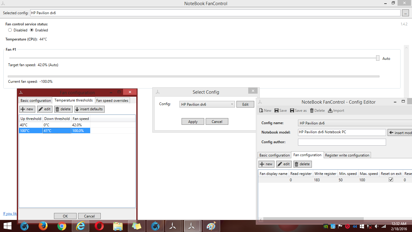

@Grantig
Sorry if I wasn't clear. The image I attached in this post says for itself.
The program ignores the actual temperature and just reads the first threshold fan speed (in this case 42%).
The temperature is at 44°C so the target fan speed should be 100% as you can see in the fan configuration window:

@Zuptr
The thresholds work as expected.
NBFC selects the first threshold. The second one will kick in if the temperature reaches 100 degree.
Temperature thresholds are explained in the NBFC wiki: https://github.com/hirschmann/nbfc/wiki/Temperature-threshold
I suggest you load the default thresholds and modify them according to your needs (that's what this button is there for ;))

@Grantig Yes, I tried 183 and that was the result of it. And by "proper" I meant there is no other value besides 183 that makes sense to be the reader one. (and I tried the others too)
Grantig schrieb:
@Vatte
Wenns vorher funktioniert hat, dann hast du evtl. irgendwas installiert was dazwischenpfuschen könnte (z.B. Hardware Monitoriung tools)?
Dies ist leider auch nicht der Fall, höchsten Windows Updates sind dazu gekommen.
Wenn ein anderes Programm die Lüfter konstant auf 25 % zwingt, warum kann ich dann jeden beliebigen Wert (außer 0) manuell per Slider einstellen?
