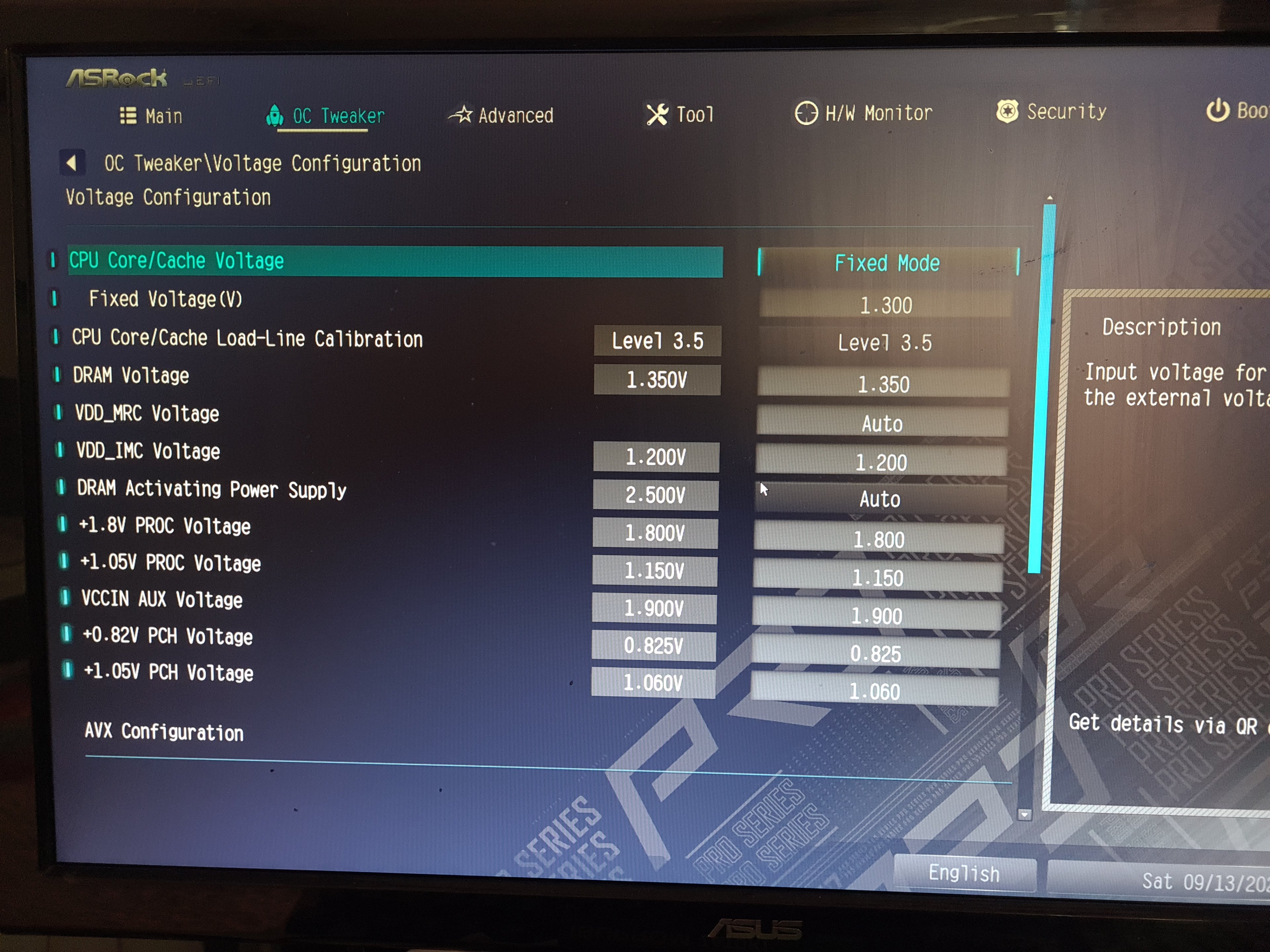

Hello, I'm new. I'm using Google Translate, my English and German are at a low level. Asrock B760 Pro RS/D4 WiFi i9 14900k 64GB 3600MHz I'm uploading a picture of the BIOS because I can't do more. I'm a novice when it comes to BIOS. I'm learning everything from the internet and guides on forums and YouTube. I'd like to set the BIOS to a level that works. The Cinebench results are R23 11k -12k max. I set this value because it's supposedly good, but I don't know where I'm going wrong. I don't know if I've set the AC and DC values correctly. I set AVX2 to a fixed 1.01 so it wouldn't be on auto. I know the picture shows 1.05, corrected to 1.01. I set the IA and GT according to another forum. They say they're correct. If I change them incorrectly, I'm a novice, so I'm learning on my own. As you can see above I set the values to the same as on the left side, I set them to a fixed value, I don't know if I did it right in your opinion

Hello and welcome!
First, update your BIOS to the latest version 8.04.
Then do a CMOS reset, load BIOS defaults, and turn off VT-d if you don’t need it.
Choose the BIOS Default profile – not Intel Baseline and not ASRock Performance.
You don’t need to set all voltages manually.
Only change what I tell you – leave the rest on Auto.
We start with Fixed Vcore 1.30V for first tests.
Set LLC to Level 3.
Check the Power Limits (PLs) – it should show:
• PL1: 125W
• PL2: 253W
• Tau: 56 seconds
• Current Limit: 307A
You can leave all of this on Auto.
Now run Cinebench R23 and slowly lower the Vcore until the system crashes – then increase it slightly.
There must be no WHEA errors (check with HWinfo64, bottom of Sensors tab, keep it running during tests).
After R23, use Geekbench – it tests single-core and multi-core, with short load phases and many load changes.
Run it 5 times in a row – it must not crash.
Geekbench is very good for testing big CPUs like yours.
If you use Fixed Vcore, then AC_LL and DC_LL have no effect.
Also leave Vcore Compensation on Auto.
EDIT: CEP must be disabled – turn off both CEP settings.
Everything you do or change is at your own risk. I take no responsibility for any damage that may occur!

Is a CMOS reset required for this? The latest BIOS version is 8.04. I'll be in the BIOS in 10 minutes.
I told you how I would proceed. What you do now is your business.
I did as you said
Reset CMOS

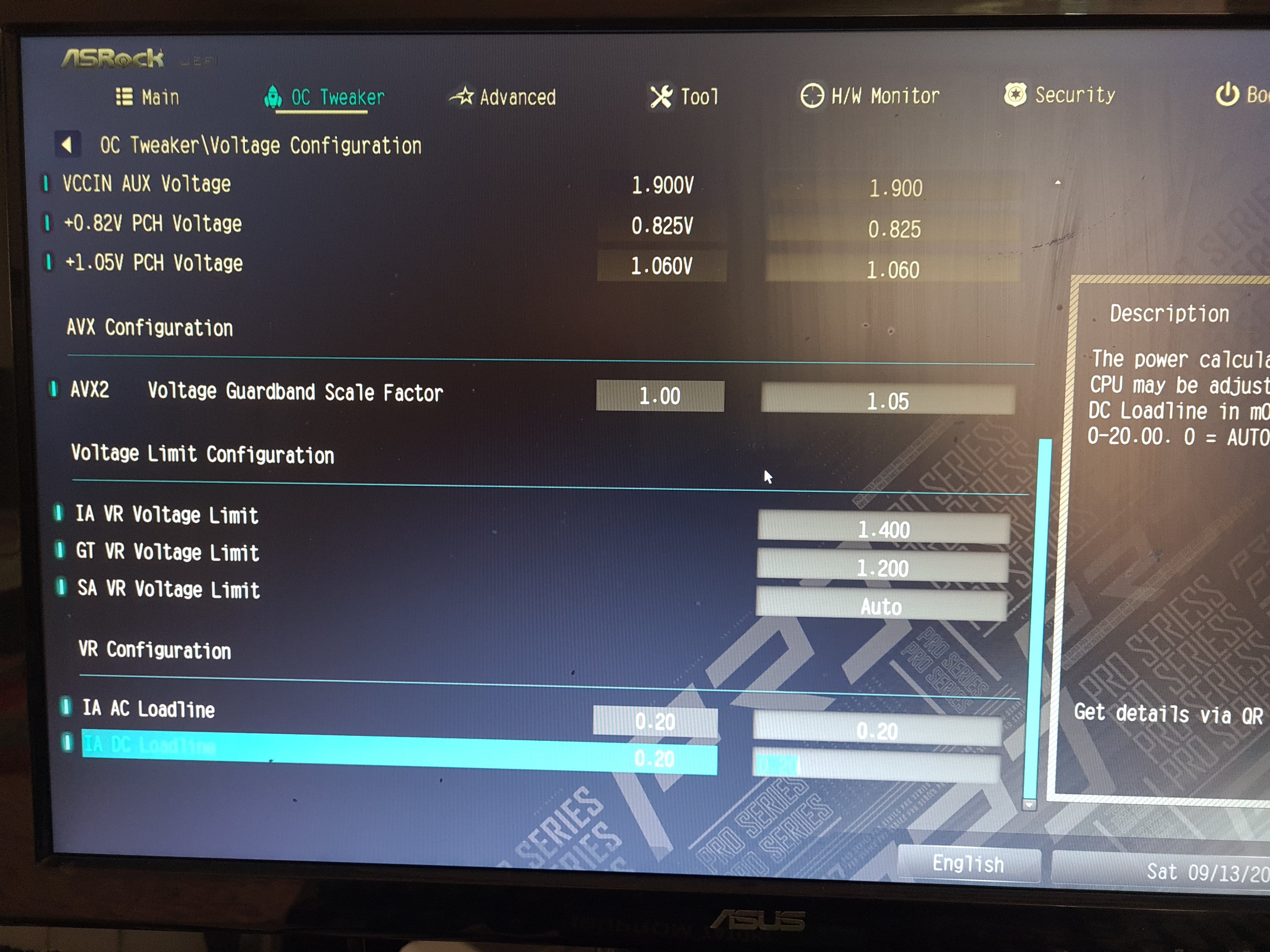

I set the current to 1.300 and decreased it until I reached 1.155
PL1 - 125 W
PL2 - 253 W
ICCMAX - 307 A
AC, DC 0.20
CPU Vcore Compensation - Automatic
LLC - Level 3
VT-d - Off
CEP - Off
BIOS - Default
No WHEA errors I'll do the rest today

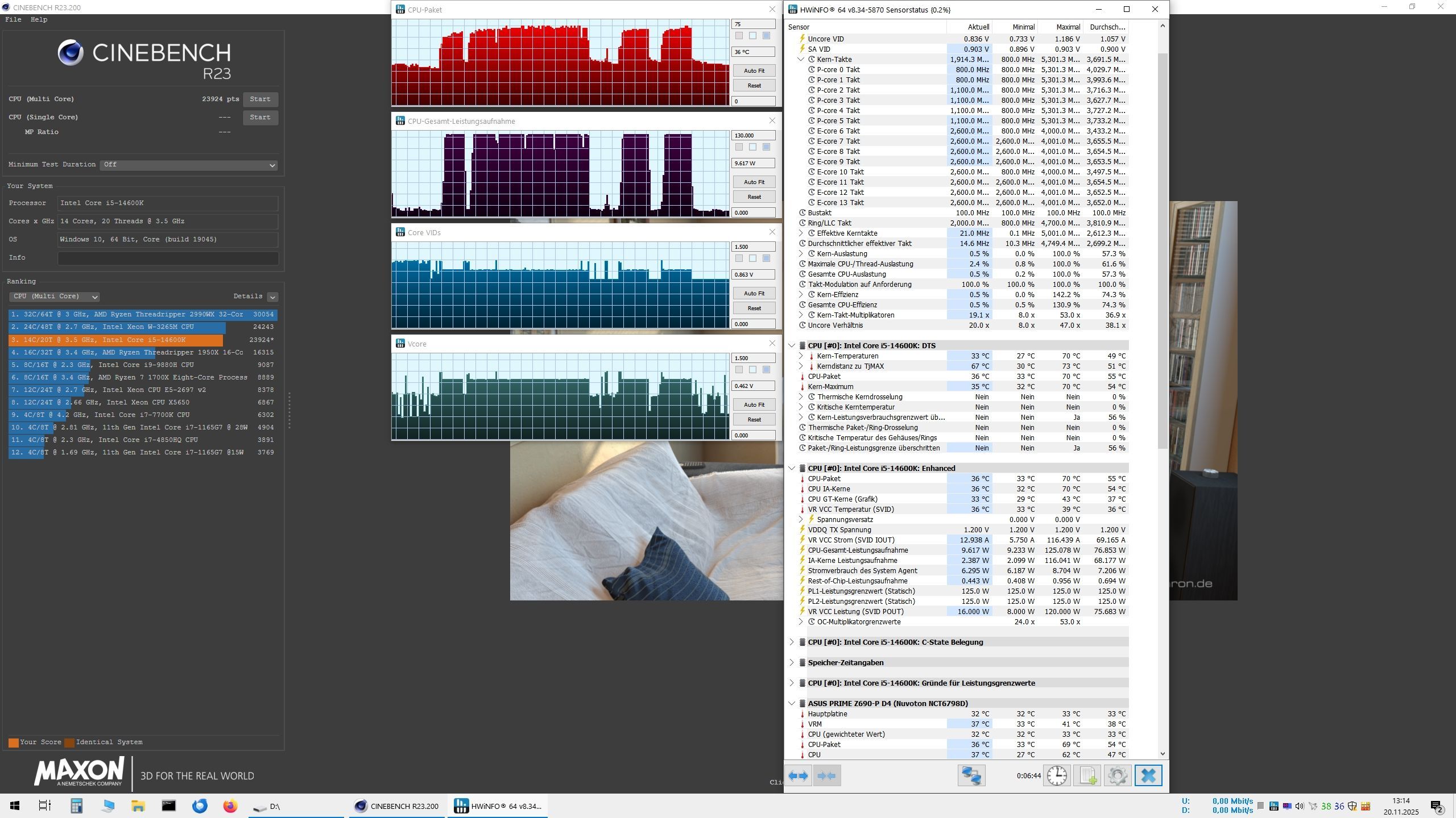

Das KS-Thema von @Tech-Dino hat mich zum Nachdenken motiviert und es nochmal zu versuchen mit AC+DC. Hielt ja 1.10 für beide für nicht optimal, aber vllt is es garnet so schlecht. Weil der Vdroop damit eigentlich hoch sein müßte.
Also hab ich folgendes probiert ...
AC 1.10 mΩ
DC 1.10 mΩ
LLC 5 ASRock (weichste)
Offset -100 (mehr geht net, komme nicht weit genug runter)
Idle Vcore 0.648V erscheint mir grenzwertig zum Idleabsturz niedrig zu sein
Last Vcore´s in R23
SC: 1.176-1.20V
MC: 1.20-1-22V
Müßte ich nicht viel mehr Vdroop haben, ich hab ja fast garkein Vdroop? Wie soll ich weiterhin vorgehen, AC+DC gleichmäßig weiter runter?
Und warum habe ich kein Vdroop? Hab doch weichste LLC. Und AC+DC 1.10 is Intelvorgabe und sollte guten Vdroop bringen.

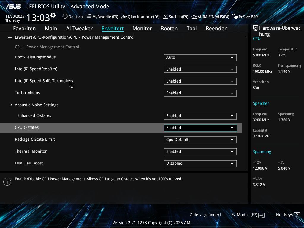

Hast du ASPM-Optionen enabled und PackageC-State? Magst du mir deine Settings geben, damit ich mich orientieren kann, nicht um es 1:1 zu übernehmen. Unsere CPUs scheinen weit auseinanderzuliegen in der Güte, da ging eh kein 1:1 übernehmen.
Interessant wäre ...
  • AC/DC Loadline
  • LLC
  • Vcoremodus
  • Vcore
- C-States, bitte auch Package C-State
- ASPM Optionen - was enabled - für NVMEs L1 oder L0
- Hast du die Takte angefasst?
Edit: Bei mir geht der CPU-Takt im Idle runter trotz Fixed Vcore. Der IdleWatt Unterschied is 1 Watt, also quasi nix.

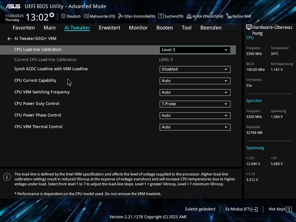

Ich nutze inzwischen fast Asus Standardsettings. Nachdem ich viel mit allen möglichen Werten jonglierte probierte ich mal die Asus Settings, laufen besser und sparsamer als mein UV mit Tweaks.
Max 125w, max 70° und stabil in Benchmarks und Prime95. Trotz 125w PL1/2 noch satte 24.000 Punkte in Cinebench R23. In Games, aktuell Stalker 2 auf 1440p/60fps, läuft die CPU bei 35 Watt.

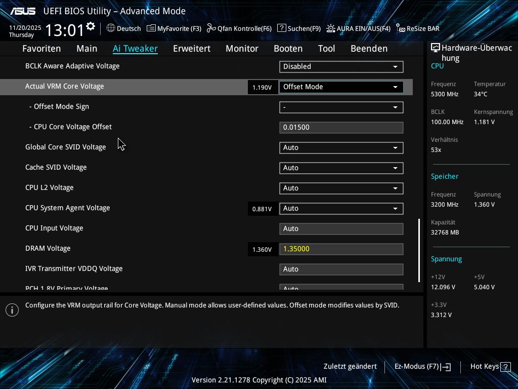

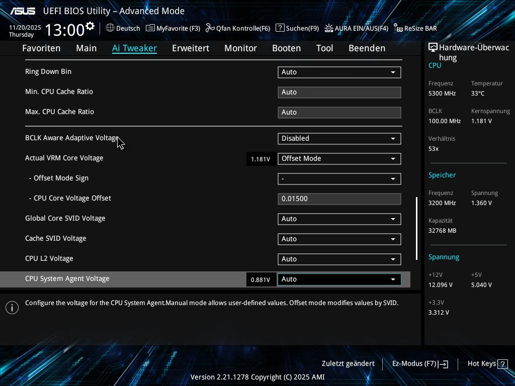

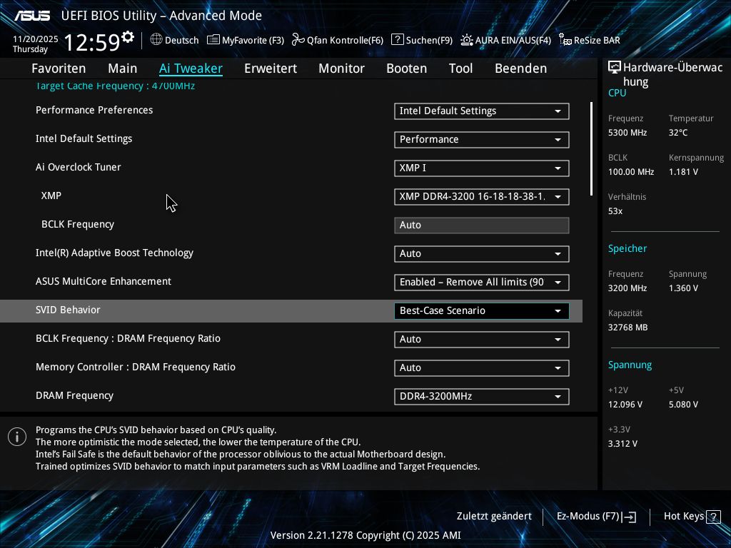

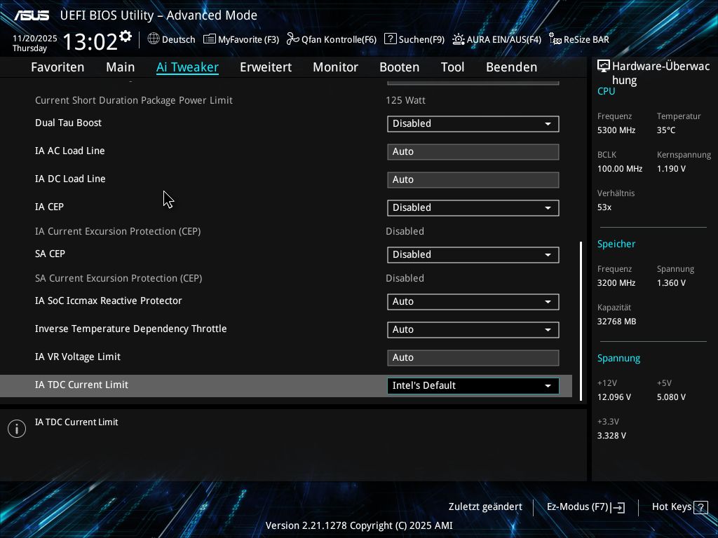

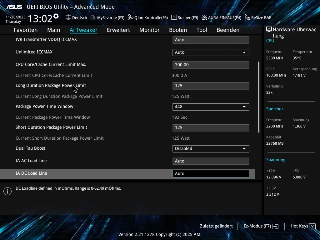

251120125944_1.jpg251120130050_1.jpg251120130121_1.jpg251120130223_1.jpg251120130227_1.jpg251120130250_1.jpg251120130342_1.jpgDesktop_2025_11_20_13_14_40_626.jpg

@Tr8or Ich finde, du hast bei 2 Sachen gegensätzliche Dinge eingestellt, und zwar Asus MCE - Remove All limits und weiter hinten setzt du 125/125. Zweiteres scheint Ersteres zu überschreiben.
Dann bei Current Limit setzt du 300 A und weiter unten steht TDC Current Limit - Intels Default (was 200 A sein müßte für den 14600K).
Das ist doch beides male gegensätzlich eingestellt, oder? Das sind jetzt nur Dinge, die mir aufgefallen sind.

Wenn man mit den Optimierungen für AC rumspielt, kann das die Vcore Anzeige beeinflussen. Realistischer wäre VR VOUT aber das habe ich garnet, hast du das? Wenn du es hast könntest du in einem R23 Run mal die beiden vergleichen, also Vcore mit VR VOUT? Das wäre super. Einfach ca. den Mittelwert. Geht nicht um posen.
Ich nutze ASUS MCE primär für die Begrenzung auf 90°, finde ich recht praktisch, wenn es doch mal aus irgendwelchen Gründen in diesen Bereich kommen sollte. Ebenso kann der Turbotakt auf allen Kernen anliegen. Aber werde mal testen wie er sich ohne verhält und welche Parameter da überhaupt ganz genau geändert werden.
Ob da 300, 500 oder 150A stehen ist (vermute ich) vollkommen egal. Wenn im Benchmark 1,1V anliegen kann bei PL=125W eh nur um die 110A gezogen werden. Aber habe es vorsichtshalber mal wieder auf Standard (IntelPerformance) 200A gestellt.
Ist VCore und VR Vout nicht dasselbe? Also das was die CPU tatsächlich geliefert bekommt.
Reaktionen: meckswell

IA Domain Loadline (AC/DC): 0.010 / 1.100 mOhm
GT Domain Loadline (AC/DC): 4.000 / 4.000 mOhm
Das mit der Ampere Handbremse ist eigenermittelt, kann also sagen, dass das sicher so ist, und beim BlueSamurai is es ja genauso gewesen. (Seite zuvor kann man es nachlesen). Ich erfinde doch nichts.
Zu deinem IA Domain Loadline (AC/DC): 0.010 / 1.100 mOhm das halte ich für sehr aggressiv, hast du denn noch Vdroop, wenn ja, wieviel. Und wie misst du ihn?

Maximal sehe ich Spikes von 1,19V. LLC ist auf 3 (Asus 1-7, weniger ist mehr), also ein gesunder Wert.
