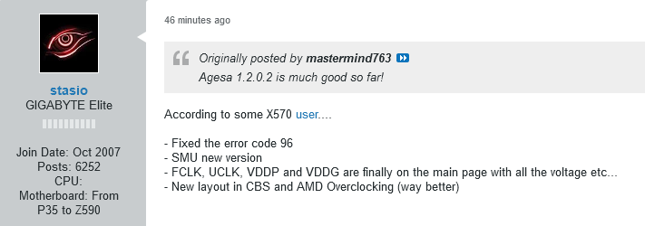

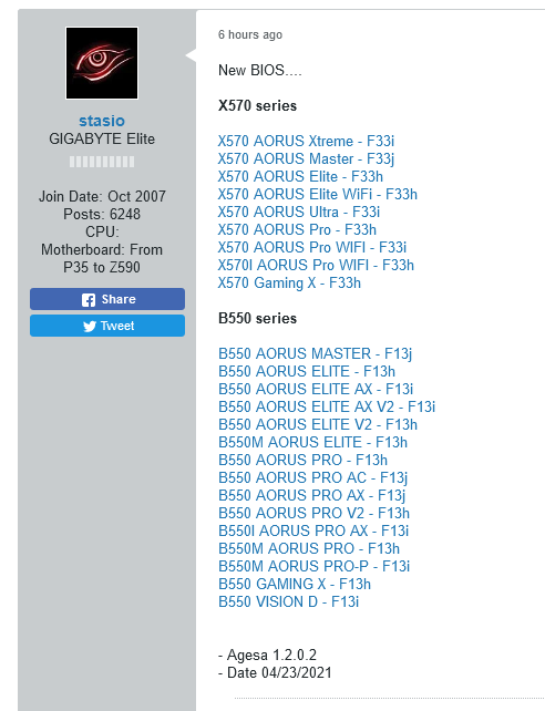

https://www.tweaktownforum.com/foru...gigabyte-latest-beta-bios?p=978545#post978545
https://www.tweaktownforum.com/foru...gigabyte-latest-beta-bios?p=978575#post978575
Reaktionen: Slayher666
