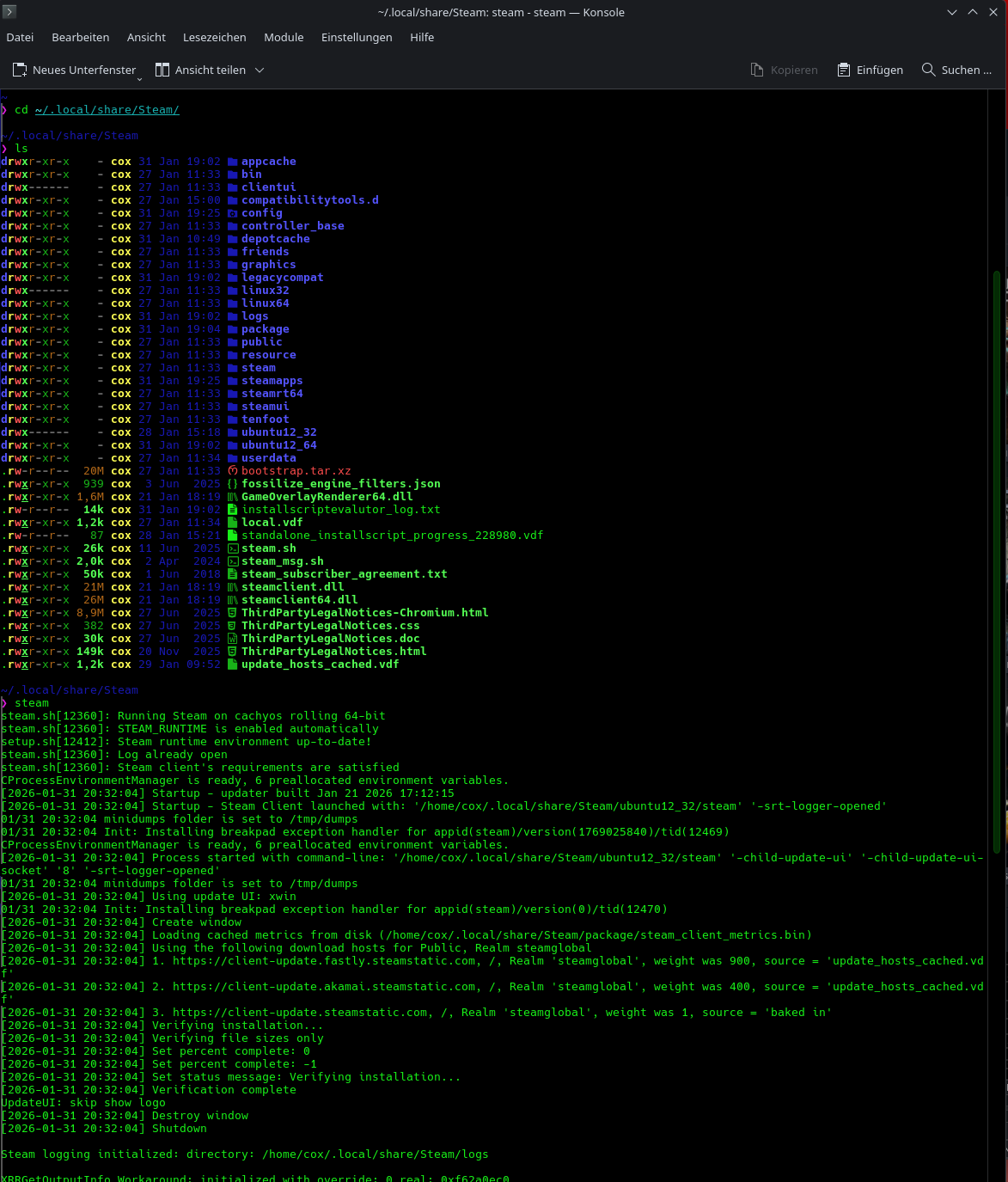

Versuchs mal mit
cd ~/.local/share/Steam/
ls (zeigt den Inhalt des Folders an)
und führe dort mal steam in der Konsole aus.
Reaktionen: iceshield

❯ steam
steam.sh[113991]: Running Steam on cachyos rolling 64-bit
steam.sh[113991]: STEAM_RUNTIME is enabled automatically
setup.sh[114043]: Steam runtime environment up-to-date!
steam.sh[113991]: Log already open
steam.sh[113991]: Steam client's requirements are satisfied
CProcessEnvironmentManager is ready, 6 preallocated environment variables.
[2026-01-31 20:33:37] Startup - updater built Jan 21 2026 17:12:15
[2026-01-31 20:33:37] Startup - Steam Client launched with: '/home/tommy1/.local/share/Steam/ubuntu12_32/steam' '-srt-logger-opened'
01/31 20:33:37 minidumps folder is set to /tmp/dumps
01/31 20:33:37 Init: Installing breakpad exception handler for appid(steam)/version(1769025840)/tid(114103)
Looks like steam didn't shutdown cleanly, scheduling immediate update check
[2026-01-31 20:33:37] Process started with command-line: '/home/tommy1/.local/share/Steam/ubuntu12_32/steam' '-child-update-ui' '-child-update-ui-socket' '8' '-srt-logger-opened'
[2026-01-31 20:33:37] Using update UI: xwin
01/31 20:33:37 Init: Installing breakpad exception handler for appid(steam)/version(0)/tid(114104)
[2026-01-31 20:33:37] Create window
[2026-01-31 20:33:38] Loading cached metrics from disk (/home/tommy1/.local/share/Steam/package/steam_client_metrics.bin)
[2026-01-31 20:33:38] Using the following download hosts for Public, Realm steamglobal
[2026-01-31 20:33:38] 1. https://client-update.fastly.steamstatic.com, /, Realm 'steamglobal', weight was 900, source = 'update_hosts_cached.vdf'
[2026-01-31 20:33:38] 2. https://client-update.akamai.steamstatic.com, /, Realm 'steamglobal', weight was 400, source = 'update_hosts_cached.vdf'
[2026-01-31 20:33:38] 3. https://client-update.steamstatic.com, /, Realm 'steamglobal', weight was 1, source = 'baked in'
[2026-01-31 20:33:38] Checking for update on startup
[2026-01-31 20:33:38] Checking for available updates...
[2026-01-31 20:33:38] Downloading manifest: https://client-update.fastly.steamstatic.com/steam_client_ubuntu12
[2026-01-31 20:33:38] Manifest download: send request
[2026-01-31 20:33:38] Set percent complete: 0
[2026-01-31 20:33:38] Set status message: Checking for available updates...
[2026-01-31 20:33:38] Set percent complete: -1
[2026-01-31 20:33:38] Manifest download: waiting for download to finish
[2026-01-31 20:33:38] Manifest download: finished
[2026-01-31 20:33:38] Download skipped: /steam_client_ubuntu12 version 1769025840, installed version 1769025840, existing pending version 0
[2026-01-31 20:33:38] Nothing to do
[2026-01-31 20:33:38] Verifying installation...
[2026-01-31 20:33:38] Verifying all executable checksums
[2026-01-31 20:33:38] Set status message: Verifying installation...
[2026-01-31 20:33:39] Verification complete
UpdateUI: skip show logo
[2026-01-31 20:33:39] Destroy window
[2026-01-31 20:33:39] Shutdown
Steam logging initialized: directory: /home/tommy1/.local/share/Steam/logs
XRRGetOutputInfo Workaround: initialized with override: 0 real: 0xf607dec0
XRRGetCrtcInfo Workaround: initialized with override: 0 real: 0xf607c590
01/31 20:33:39 minidumps folder is set to /tmp/dumps
01/31 20:33:39 Init: Installing breakpad exception handler for appid(steamsysinfo)/version(1769025840)/tid(114132)
Running query: 1 - GpuTopology
Response: gpu_topology {
gpus {
name: "AMD Radeon Graphics (RADV RENOIR)"
vram_size_bytes: 6261288960
driver_id: k_EGpuDriverId_MesaRadv
driver_version_major: 25
driver_version_minor: 3
driver_version_patch: 4
luid: 0
default_gpu_id: 1
Exit code: 0
Saving response to: /tmp/steamDhnmpe - 59 bytes
steamwebhelper.sh[114151]: Starting steamwebhelper under bootstrap steamrt steam runtime via: /home/tommy1/.local/share/Steam/steamrt64/pv-runtime/steam-runtime-steamrt/_v2-entry-point
steamwebhelper.sh[114151]: Starting steamwebhelper with steamrt steam runtime at /home/tommy1/.local/share/Steam/steamrt64/pv-runtime/steam-runtime-steamrt/_v2-entry-point
Steam Runtime Launch Service: starting steam-runtime-launcher-service
Steam Runtime Launch Service: steam-runtime-launcher-service is running pid 114281
bus_name=com.steampowered.PressureVessel.LaunchAlongsideSteam
exec ./steamwebhelper -nocrashdialog -lang=en_US -cachedir=/home/tommy1/.local/share/Steam/config/htmlcache -steampid=114103 -buildid=1769025840 -steamid=0 -logdir=/home/tommy1/.local/share/Steam/logs -uimode=7 -startcount=0 -steamuniverse=Public -realm=Global -clientui=/home/tommy1/.local/share/Steam/clientui -steampath=/home/tommy1/.local/share/Steam/ubuntu12_32/steam -launcher=0 --v
alve-initial-threadpool-size=4 --valve-enable-site-isolation --enable-smooth-scrolling --password-store=basic --log-file=/home/tommy1/.local/share/Steam/logs/cef_log.txt --disable-quick-menu --disable-component-update --gaia-url=http://disabled.invalid --enable-features=PlatformHEVCDecoderSupport --disable-features=WinRetrieveSuggestionsOnlyOnDemand,SpareRendererForSitePerProcess,Dchec
kIsFatal,BlockPromptsIfIgnoredOften,ValveFFmpegAllowLowDelayHEVC
/usr/share/themes/Breeze-Dark/gtk-2.0/widgets/entry:70: error: unexpected identifier 'direction', expected character '}'
/usr/share/themes/Breeze-Dark/gtk-2.0/widgets/styles:36: error: invalid string constant "combobox_entry", expected valid string constant
Desktop state changed: desktop: { pos: 0, 0 size: 1969,1231 } primary: { pos: 0, 0 size: 1969,1231 }
Caching cursor image for , size 32x32, serial 3, cache size = 0
Proton: Upgrading prefix from CachyOS-10.1000-200 to GE-Proton10-29 (/home/tommy1/.local/share/Steam/steamapps/compatdata/0/)
Proton: Prefix has an invalid version?! You may want to back up user files and delete this prefix.
ProtonFixes[114753] WARN: Skipping fix execution. We are probably running a unit test.
wineserver: NTSync up and running!
reaping pid: 114104 -- steam
regsvr32: Successfully unregistered DLL 'C:\windows\\Microsoft.NET\Framework\v4.0.30319\diasymreader.dll'
regsvr32: Successfully unregistered DLL 'C:\windows\\Microsoft.NET\Framework64\v4.0.30319\diasymreader.dll'
Fossilize INFO: Overriding serialization path: "/home/tommy1/.local/share/Steam/shader_cache_temp_dir_d3d11_64/fozpipelinesv6/steamapprun_pipeline_cache".
ProtonFixes[115072] WARN: Skipping fix execution. We are probably running a unit test.
Fossilize INFO: Overriding serialization path: "/home/tommy1/.local/share/Steam/shader_cache_temp_dir_d3d12_64/fozpipelinesv6/steamapprun_pipeline_cache".
Proton: Upgrading prefix from GE-Proton10-29 to CachyOS-10.1000-200 (/home/tommy1/.local/share/Steam/steamapps/compatdata/0/)
ProtonFixes[115314] WARN: Skipping fix execution. We are probably running a unit test.
ProtonFixes[115585] WARN: Skipping fix execution. We are probably running a unit test.
Proton: Restoring LD_LIBRARY_PATH to:
Proton: Restoring PATH to: /usr/local/sbin:/usr/local/bin:/usr/bin:/opt/cuda/bin:/usr/bin/site_perl:/usr/bin/vendor_perl:/usr/bin/core_perl
ProtonFixes[115714] WARN: Skipping fix execution. We are probably running a unit test.
ProtonFixes[115884] WARN: Skipping fix execution. We are probably running a unit test.
[2026-01-31 20:35:40] Background update loop checking for update. . .
[2026-01-31 20:35:40] Checking for available updates...
[2026-01-31 20:35:40] Downloading manifest: https://client-update.fastly.steamstatic.com/steam_client_ubuntu12
[2026-01-31 20:35:40] Manifest download: send request
[2026-01-31 20:35:40] Manifest download: waiting for download to finish
[2026-01-31 20:35:41] Manifest download: finished
[2026-01-31 20:35:41] Download skipped by HTTP 304 Not Modified
[2026-01-31 20:35:41] Nothing to do

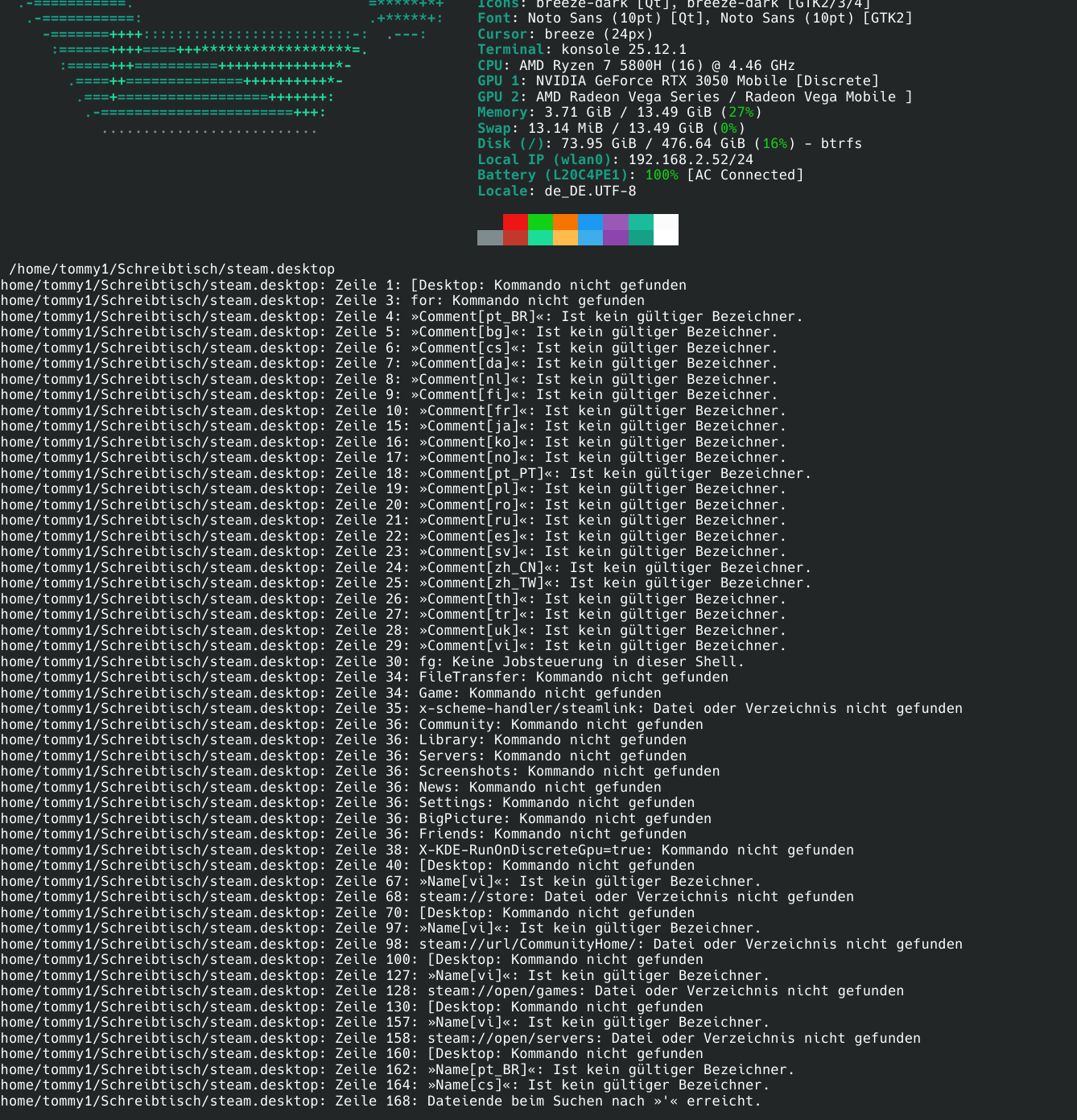

Wie sieht denn der Inhalt der steam.desktop Datei aus? Ich nehme aktuell stark an, dass da der Pfad oder die Parameter falsch sind.
Reaktionen: madmax2010
Die "verknüpfung"/Starter auf dem Desktop hatte Meldungen, das beim aufrufen nicht verstanden wurde was da drin steht. also vorschlagt, das dingen löschen..
im startmenü steam eingeben, kein enter, mit rechtsklick auf die steam startverknüpfung, die da ist und dann
"zur Arbeitsfläche hinzufügen drücken.

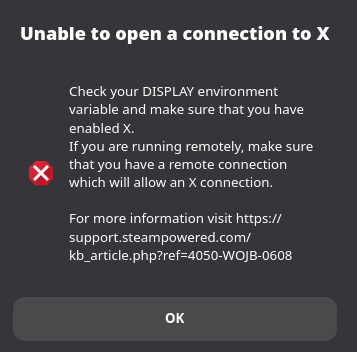

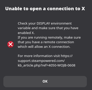

Hab auch denk mal selbe Problem mit Steam es kommt
Ich hab Cachy Installier und geupdatet davor ging alles jetzt kommt dieser Fehler auf einmal...
hat einer Lösung?
Danke
Dann mach doch mal das selbe. Terminal auf und daraus heraus steam starten.
Reaktionen: phillow
MasterChief1335 schrieb:
hat einer Lösung?
Die offizielle Lösung von Steam für dieses Problem steht hier: https://help.steampowered.com/en/faqs/view/2112-4548-B98B-3A06
Wenn es allerdings bei dir auch so ist, dass es auf dem Terminal plötzlich geht (ohne die DISPLAY-variable zu ändern), dann ist das Verhalten ohne Terminal natürlich schwer zu debuggen.
Welche Grafikkarte hast du?
Update: Ich habe das Problem auf einem voll geupdateten CachyOS-Rechner nicht, kann also nichts nachstellen.
❯ steam
steam.sh[8560]: Running Steam on cachyos rolling 64-bit
steam.sh[8560]: STEAM_RUNTIME is enabled automatically
setup.sh[8612]: Steam runtime environment up-to-date!
steam.sh[8560]: Log already open
steam.sh[8560]: Steam client's requirements are satisfied
[2026-02-07 07:21:53] Startup - updater built Jan 21 2026 17:12:15
[2026-02-07 07:21:53] Startup - Steam Client launched with: '/home/sascha/.local/share/Steam/ubuntu12_32/steam' '-srt-logger-opened'
02/07 07:21:53 minidumps folder is set to /tmp/dumps
02/07 07:21:53 Init: Installing breakpad exception handler for appid(steam)/version(1769025840)/tid(8672)
[2026-02-07 07:21:53] Process started with command-line: '/home/sascha/.local/share/Steam/ubuntu12_32/steam' '-child-update-ui' '-child-update-ui-socket' '8' '-srt-logger-opened'
[2026-02-07 07:21:53] Using update UI: xwin
02/07 07:21:53 Init: Installing breakpad exception handler for appid(steam)/version(0)/tid(8673)
[2026-02-07 07:21:53] Create window
CBaseLinuxUpdateUI::BaseCreateWindow: XOpenDisplay failed
Error: Check your DISPLAY environment variable and make sure that you have enabled X.
If you are running remotely, make sure that you have a remote connection which will allow an X connection.
For more information visit https://support.steampowered.com/kb_article.php?ref=4050-WOJB-0608
Using host zenity for message
[2026-02-07 07:21:53] Loading cached metrics from disk (/home/sascha/.local/share/Steam/package/steam_client_metrics.bin)
[2026-02-07 07:21:53] Using the following download hosts for Public, Realm steamglobal
[2026-02-07 07:21:53] 1. https://client-update.akamai.steamstatic.com, /, Realm 'steamglobal', weight was 400, source = 'update_hosts_cached.vdf'
[2026-02-07 07:21:53] 2. https://client-update.fastly.steamstatic.com, /, Realm 'steamglobal', weight was 900, source = 'update_hosts_cached.vdf'
[2026-02-07 07:21:53] 3. https://client-update.steamstatic.com, /, Realm 'steamglobal', weight was 1, source = 'baked in'
[2026-02-07 07:21:53] Checking for update on startup
[2026-02-07 07:21:53] Set percent complete: 0
[2026-02-07 07:21:53] Suche nach verfügbaren Updates …
[2026-02-07 07:21:53] Set status message: Suche nach verfügbaren Updates …
[2026-02-07 07:21:53] Downloading manifest: https://client-update.akamai.steamstatic.com/steam_client_ubuntu12
[2026-02-07 07:21:53] Set percent complete: -1
[2026-02-07 07:21:53] Manifest download: send request
[2026-02-07 07:21:53] Manifest download: waiting for download to finish
[2026-02-07 07:21:53] Manifest download: finished
[2026-02-07 07:21:53] Download skipped: /steam_client_ubuntu12 version 1769025840, installed version 1769025840, existing pending version 0
[2026-02-07 07:21:53] Nothing to do
[2026-02-07 07:21:53] Installation wird überprüft …
[2026-02-07 07:21:53] Verifying all executable checksums
[2026-02-07 07:21:53] Set status message: Installation wird überprüft …
[2026-02-07 07:21:54] Verification complete
[2026-02-07 07:21:54] Destroy window
[2026-02-07 07:21:54] Shutdown
Steam logging initialized: directory: /home/sascha/.local/share/Steam/logs
Unable to open display
Unable to open displaysrc/steamUI/spewmanager.cpp (192) : Assertion Failed: Error: Unable to open display
02/07 07:21:54 Init: Installing breakpad exception handler for appid(steam)/version(1769025840)/tid(8672)
assert_20260207072154_7.dmp[8698]: Uploading dump (out-of-process)
/tmp/dumps/assert_20260207072154_7.dmp
crash_20260207072154_8.dmp[8703]: Uploading dump (out-of-process)
/tmp/dumps/crash_20260207072154_8.dmp
/home/sascha/.local/share/Steam/steam.sh: Zeile 928: 8672 Speicherzugriffsfehler (Speicherabzug geschrieben) "$STEAMROOT/$STEAMEXEPATH" "$@"
❯ #crash_20260207072154_8.dmp[8703]: Finished uploading minidump (out-of-process): success = yes
crash_20260207072154_8.dmp[8703]: response: CrashID=bp-61778654-62a8-4f9a-b9c4-8ab742260206
crash_20260207072154_8.dmp[8703]: file ''/tmp/dumps/crash_20260207072154_8.dmp'', upload yes: ''CrashID=bp-61778654-62a8-4f9a-b9c4-8ab742260206''
assert_20260207072154_7.dmp[8698]: Finished uploading minidump (out-of-process): success = yes
assert_20260207072154_7.dmp[8698]: response: CrashID=bp-1be7724c-595f-4f98-961e-5b7632260206
assert_20260207072154_7.dmp[8698]: file ''/tmp/dumps/assert_20260207072154_7.dmp'', upload yes: ''CrashID=bp-1be7724c-595f-4f98-961e-5b7632260206''
