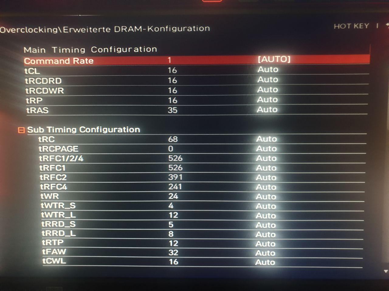

Bisher keine Probleme, aber ich habe mal eine Frage zu meinem Ram (Crucial BLS2K16G4D30AESB (2x, 16GB, DDR4-3000) und den Bios einstellungen.
Das XMP Profil stimmt nicht.
Kann mir jemand bei der Manuellen Einstellung helfen ?

Liegt am Gear Down Mode, ist bei dir "enabled".

Ey Danke DarkSoul, genau das wollte ich für den Anfang. Mega !

Bootprobleme durch Ram OC beseitigt:
RAM: Ballistix 32 GB DDR4-3000 (BLS2K16G4D30AESB)
Board: MSI MPG X570 GAMING PRO CARBON WIFI
DRAM Configuration:
Main Timing Configuration
Command Rate - [Gear Down Mode]
tCL = 16
tRCDRD = 19
tRCDWR = 16
tRP = 16
tRAS = 40
Sub Timing Configuration
tRC = 65
tRCPAGE = 0
tRFC1/2/4 = Auto
tRFC1 = 625
tRFC2 = Auto
tRFC4 = Auto
twR = 24
tWTRS = 5
tWTRL = 12
tRRDS = 6
tPPR L = 12
tRTP = 13
tFAW = 36
tCWL = 16
tCKE = 1
Turn Around Timing Configuration
tRDRDSC_L = 4
tRDRDSC = 1
tRDRDSD = 5
tRDRDDD = 5
tWRWRSCL = 4
tWRWRSC = 1
tWRWRSD = 7
tWRWRDD = 7
tRDWR = 12
tWRRD = 7
Misc Item
Gear Down Mode = Auto
Power Down Enable = off
BankGrouoSwaD = Auto
BankGrouoSwaoAlt = Auto
On-Die Termination Configuration
ProcODT = [40 ohm]
RttWr = [80 ohm]
RttNom = [Rtt.Nom Disable]
RttPark = [240 ohm]
CAD Bus Drive Strength Configuration
ClkDrvStren = [24 ohm]
AddrCmdDrvStren = [24 ohm]
CsOdtDrvStren = [24 ohm]
CkeDrvStren = [24 ohm]
Voltage Setting
CPU NB/SoC Voltage = Override Mode
Override CPU NB/SoC Voltage = 1,1000 V
VDDG CCD/IOD Voltage Control Mode = Synchronous
VDDG CCG Voltage = 0,950 V
VDDG IOD Voltage = 0,950 V
DRAM Voltage = 1,400 V
DRAM Setting
A-XMP = Disabled
DRAM Frequency = DDR4-3800
FCLK Frequency = 1900 MHz
UCLK DIV1 MODE = UCLK==MEMCLK
