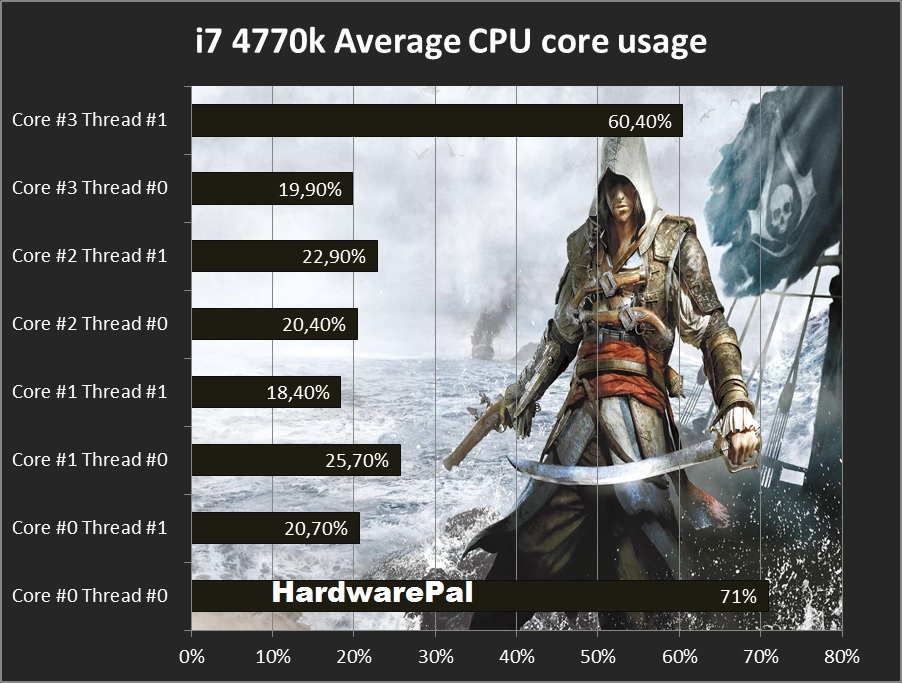

Assassin’s Creed 4 : Black Flag Benchmark – CPU and GPU http://www.hardwarepal.com/?p=5671
If you played earlier Assassin’s Creed sequels you will notice that CPU usage is more or less the same when it comes to CPU load. The first core on all of the CPU’s is working at around 70%, and the last core is at 60% of load most of the time, while the load on other cores or threads varies from time to time. The game does use all of the cores and threads but the engine is programmed in a way that nothing above a quad core CPU will give you better performance.
