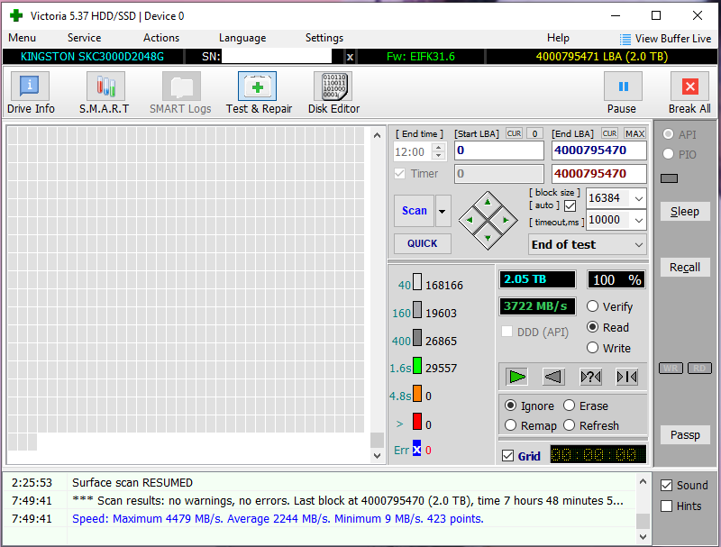

Forward 2 years later with the new drive, i noticed the same thing happening (especially on my daily backup to separate HDD, even at low priority at 250mb/s was slowing everything down). But this time being wiser (lol) i investigated further. Did a full surface scan a few months ago:
Also did a chkdsk /f /r which took a similar time (~8 hours).
I decided to email Kingston again, to quote directly from my email:
As you can see 29557 of the sector blocks take between 400-1600ms to access during an essentially sequential read. So during every time during daily operation when the ssd hits some of these slow sectors it slows everything down.
I don’t know if they are because of bad or old cells, but i am assuming the firmware has some provisions where it encounters such a sector to re-write or relocate it (assuming that will fix it).

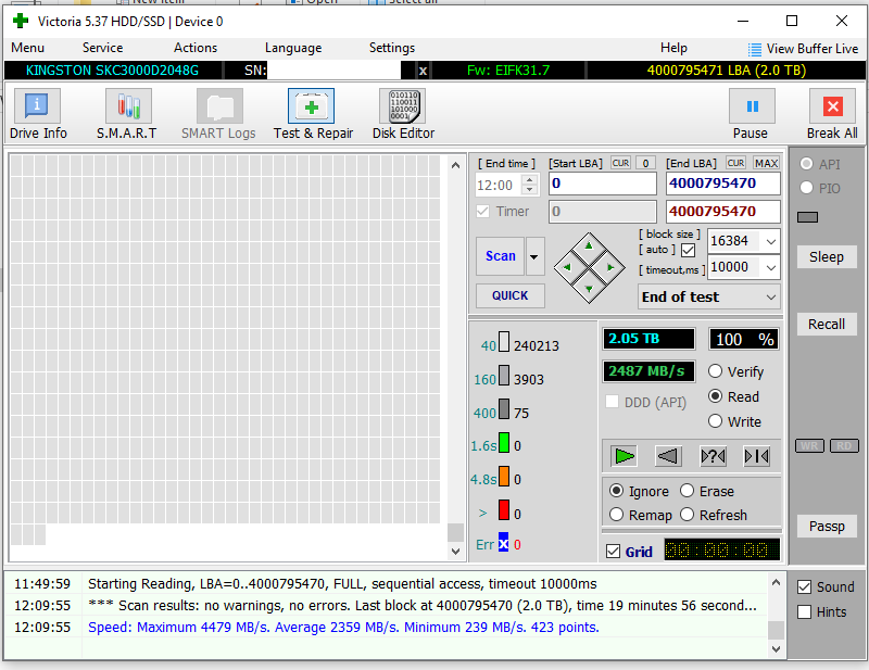

Tested it for a week now, and i've noticed the improvement. Done new surface scan (even with some apps in the background so not 100% idle) and boy ohh boy:
From 8 hours down to 20mins!!! Chkdsk /f /r from 8 hours to 1 hour! Plus it has another 150gb+ of data now which would make it slower (blame Wukong for 120gb;p)
