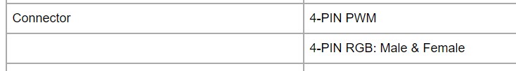

http://www.azzatek.com/m/2010-1307-159058.php?Lang=en
