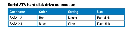

Siehe Handbuch, Seite 4-14:
4.3.6 Storage Configuration
BIOS SETUP UTILITY -> Main
Onchip SATA Channel [Enabled]
Onchip SATA Type [IDE]
If you want to create a RAID 0, RAID1, or RAID 0+1 configuration from the Serial
ATA hard disk drives, set this item to [RAID].
If you want to use the Serial ATA hard disk drives as Parallel ATA physical storage
devices, keep the defaul setting [IDE].
If you want the Serial ATA hard disk drives to use the Advanced Host Controller
Interface (AHCI), set this item to [AHCI]
Und Seite 2-29 und 2-30:
3. AMD ® SB600 Southbridge Serial ATA connectors
(7-pin SATA1 [red]; SATA2 [black]; SATA3 [red]; SATA4 [black])
These connectors are for the Serial ATA signal cables for Serial ATA hard disk
and optical disk drives.
These connectors are set to [IDE] by default.
When using the connectors in Native IDE mode, connect the primary (boot)
hard disk drive to the SATA1/3 connector
. Refer to the table below for the
recommended SATA hard disk drive connections.
Das heißt, diese Priorisierung gilt nur dann, wenn die SATA-Ports standardmäßig im IDE-Mode belassen wurden.
