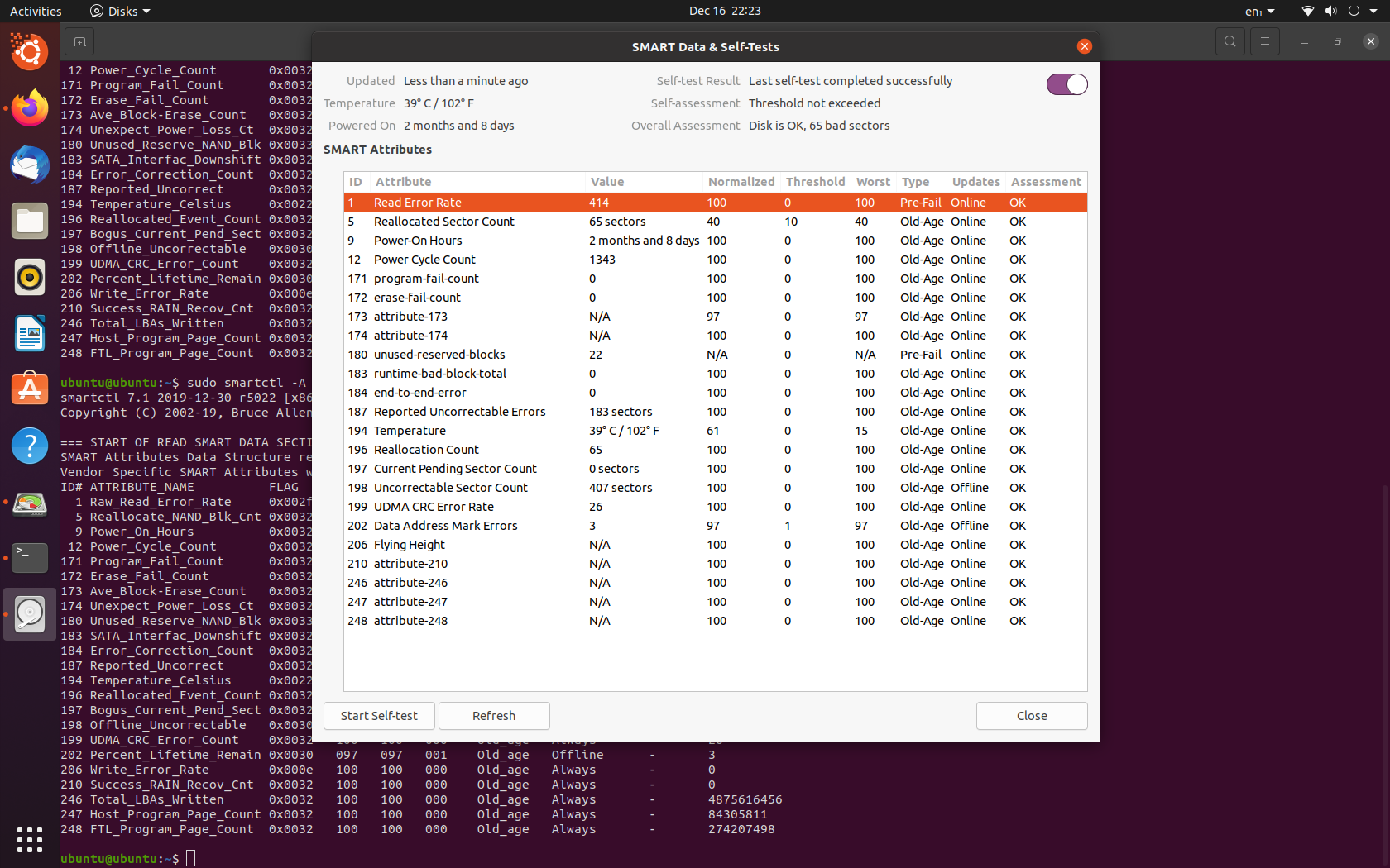

Smartwerte kann ich leider wie gesagt noch nicht posten, will ich aber unbedingt.

Code:
ubuntu@ubuntu:~$ sudo smartctl -A /dev/sda
smartctl 7.1 2019-12-30 r5022 [x86_64-linux-5.11.0-27-generic] (local build)
Copyright (C) 2002-19, Bruce Allen, Christian Franke, www.smartmontools.org
=== START OF READ SMART DATA SECTION ===
SMART Attributes Data Structure revision number: 16
Vendor Specific SMART Attributes with Thresholds:
ID# ATTRIBUTE_NAME          FLAG     VALUE WORST THRESH TYPE      UPDATED  WHEN_FAILED RAW_VALUE
  1 Raw_Read_Error_Rate     0x002f   100   100   000    Pre-fail  Always       -       414
  5 Reallocate_NAND_Blk_Cnt 0x0032   040   040   010    Old_age   Always       -       65
  9 Power_On_Hours          0x0032   100   100   000    Old_age   Always       -       1655
 12 Power_Cycle_Count       0x0032   100   100   000    Old_age   Always       -       1343
171 Program_Fail_Count      0x0032   100   100   000    Old_age   Always       -       0
172 Erase_Fail_Count        0x0032   100   100   000    Old_age   Always       -       0
173 Ave_Block-Erase_Count   0x0032   097   097   000    Old_age   Always       -       58
174 Unexpect_Power_Loss_Ct  0x0032   100   100   000    Old_age   Always       -       46
180 Unused_Reserve_NAND_Blk 0x0033   000   000   000    Pre-fail  Always       -       22
183 SATA_Interfac_Downshift 0x0032   100   100   000    Old_age   Always       -       0
184 Error_Correction_Count  0x0032   100   100   000    Old_age   Always       -       0
187 Reported_Uncorrect      0x0032   100   100   000    Old_age   Always       -       183
194 Temperature_Celsius     0x0022   061   015   000    Old_age   Always       -       39 (Min/Max 0/85)
196 Reallocated_Event_Count 0x0032   100   100   000    Old_age   Always       -       65
197 Bogus_Current_Pend_Sect 0x0032   100   100   000    Old_age   Always       -       0
198 Offline_Uncorrectable   0x0030   100   100   000    Old_age   Offline      -       407
199 UDMA_CRC_Error_Count    0x0032   100   100   000    Old_age   Always       -       26
202 Percent_Lifetime_Remain 0x0030   097   097   001    Old_age   Offline      -       3
206 Write_Error_Rate        0x000e   100   100   000    Old_age   Always       -       0
210 Success_RAIN_Recov_Cnt  0x0032   100   100   000    Old_age   Always       -       0
246 Total_LBAs_Written      0x0032   100   100   000    Old_age   Always       -       4875616456
247 Host_Program_Page_Count 0x0032   100   100   000    Old_age   Always       -       84305811
248 FTL_Program_Page_Count  0x0032   100   100   000    Old_age   Always       -       274207497

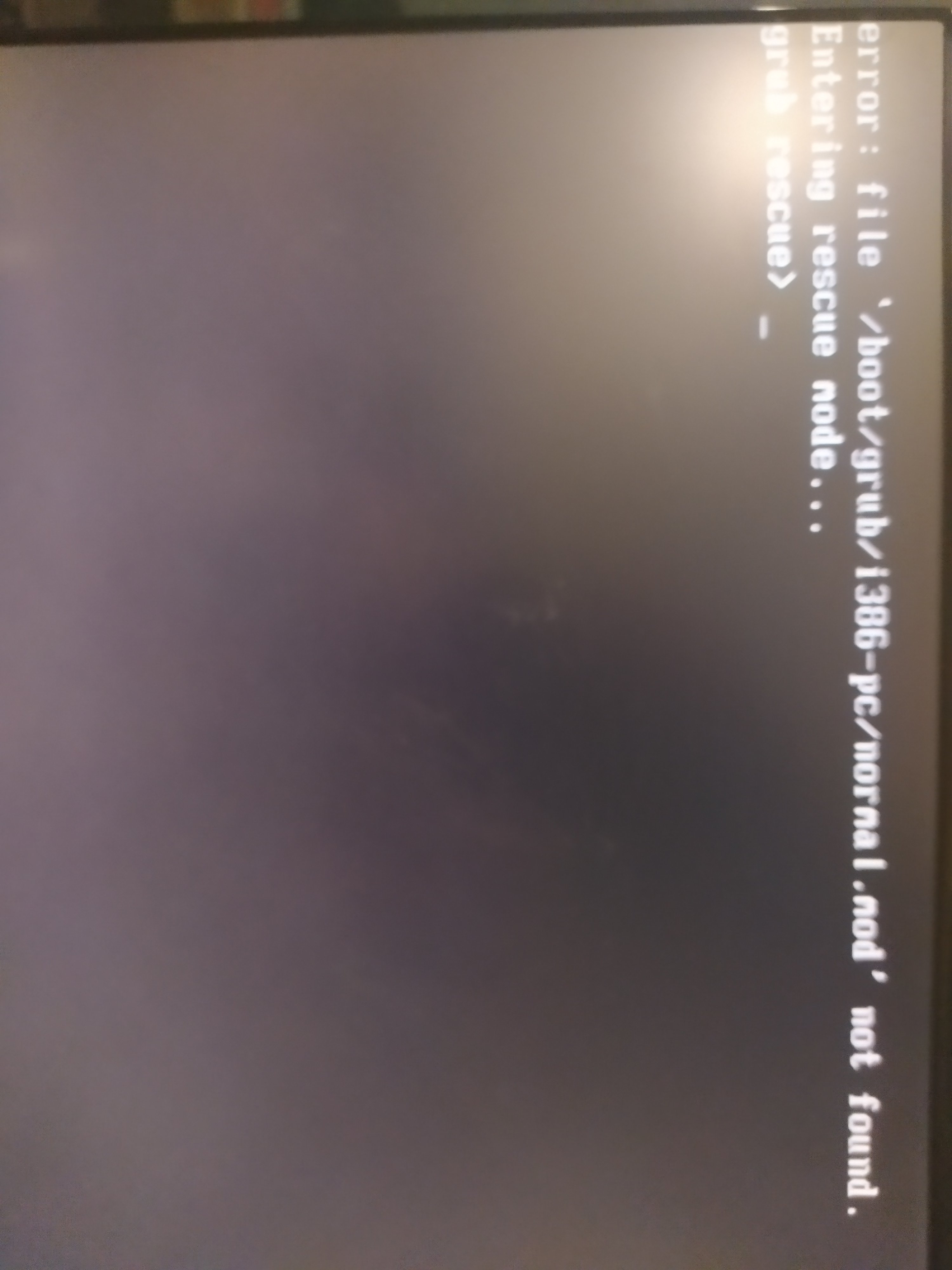

Ich würde eigentlich gerne einfach ein Startup-Repair durchführen.
Aber die letzten Meldungen kommen mir komisch vor.
Ich möchte eure Nacken nicht strapazieren, die Fotos tun mir Leid.

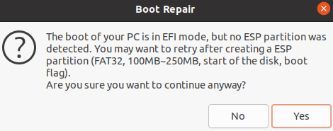

Komisch finde ich das hier, wenn ich versuche boot-repair auszufuehren:
Schliesslich habe ich eine entsprechende Boot Partition ja schon gehabt.
Ich habe da jetzt erstmal auf "Nein" gedrueckt. Ich bin da zu muede fuer um alleine so eine Entscheidung zu treffen...Irgendwie habe ich mir den Abend ganz anders vorgestellt.
Ich bin aber froh, dass es erstmal scheinbar kein Totalschaden ist.

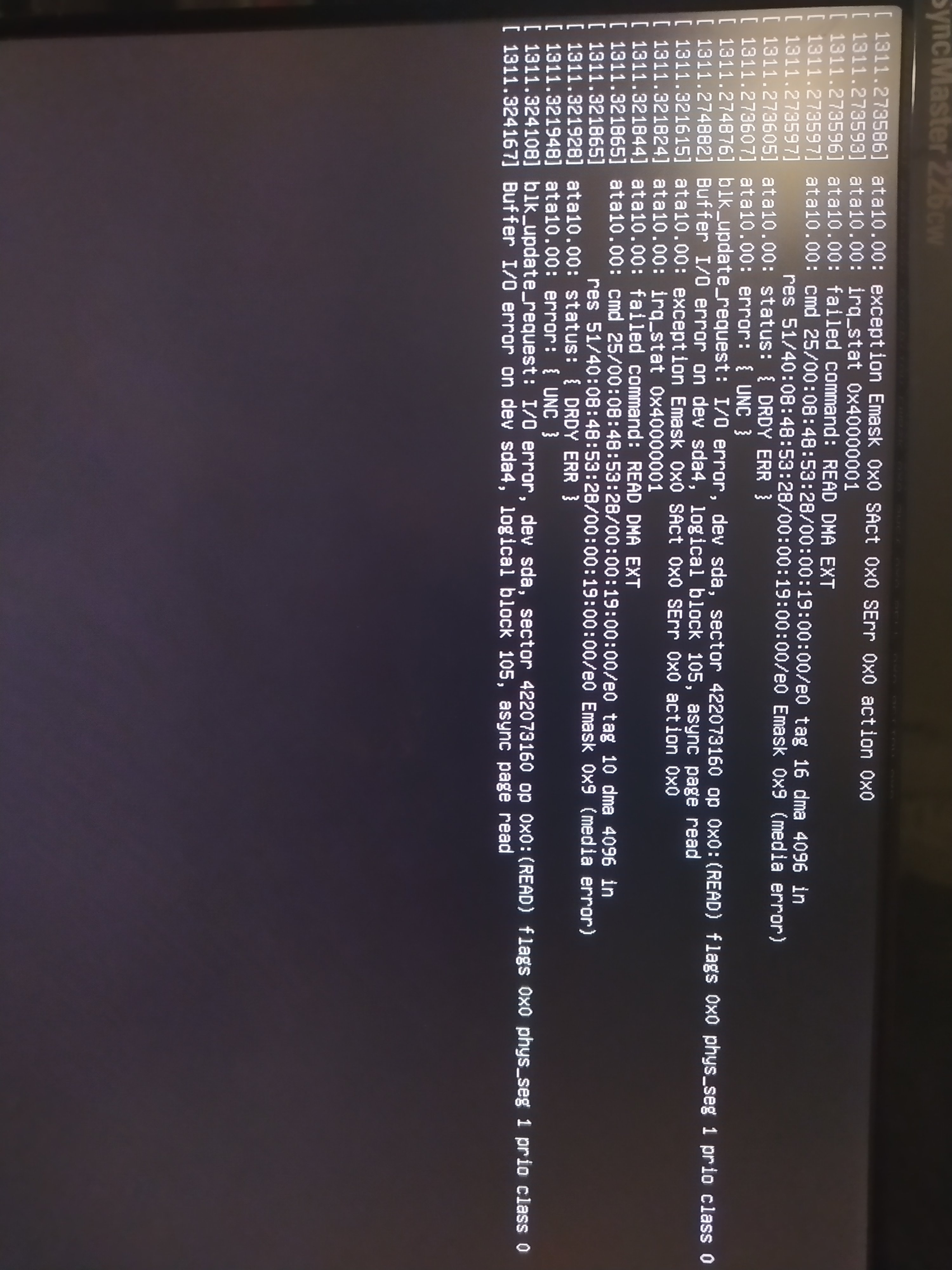

Kleines Update.
Die Platte stirbt mir scheinbar vor der Nase weg.
Einige Dateien sind jetzt readonly.
Ich nutze das um Sachen außerhalb der Backuproutine zu retten. Und naja.
Bei den ganzen Error counts ist es zumindest kein Wunder, dass die SSD am sterben ist:

Also die 85° C max temp sind hoffentlich eine Fehlinterpretation :rolleyes:
Ansonsten könnte das womöglich sowohl Fehler in der Verbindung zum Board, als auch vom Speicher selbst verursachen.
Wenn die Rahmenbedingungen stimmen würde ich eindeutig auf Pech tippen. Aber es sieht etwas verdächtig danach aus als wäre dem nicht so.
Reaktionen: Wasserhuhn
Die Temperatur wurde von "Disks" wie im Screenshot angegeben anders ausgelesen.
Wäre aber auch eine Hausnummer.

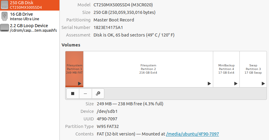

Wem etwas komisch vorkam, der hatte Recht.
Das ist gar keine WD Blue, sondern eine Crucial MX500 250GB M2.
Wie ich auf das andere Modell kam... Ich glaube ich stand kurz davor die WD zu kaufen.
Mmmh, irgendwie läuft seit gestern gar nichts bei mir.
Also die Platte ist eine Crucial MX550 M2 250GB.
Die Platte ist, wie ich an der Rechnung sehe, von März 2020, nicht 2021.
Und es war B-Ware mit einem Jahr Gewährleistung. Platte war beim Kauf aber in Ordnung. Nur ausgepackt gewesen, laut Smart nur einmal gestartet und wieder eingepackt.
