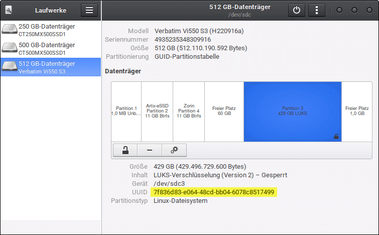

Zur geLUKTen Home-Partition:
/etc/crypttab:
Code:
# <name> <device>                                  <password> <options>
Home     UUID=7f836d83-e064-48cd-bb04-6078c8517499 none       luks,discard
