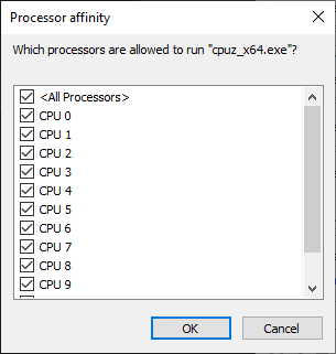

oder du hast die Software per über die CPU Affinität auf diese Kerne "festgeklebt".

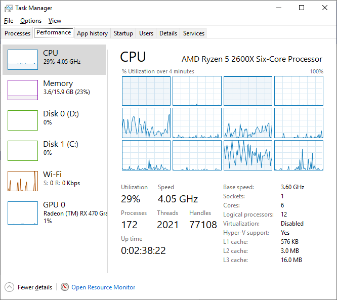

Also ganz bescheuert bin ich auch nicht... Selbstverständlich läuft das alles absolut auf standard settings.
781332
Übrigens sehe ich gerade ich hab vergessen den Thread wieder abzuschalten.
781333
Kein Switch in 40 min

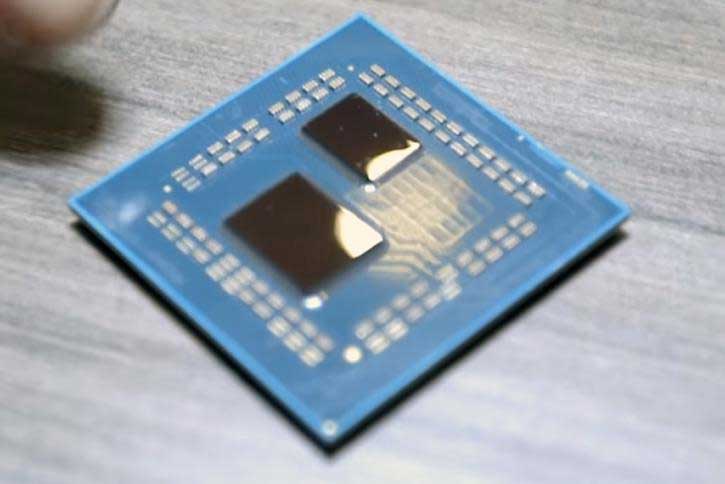

https://www.techpowerup.com/253954/...reveals-new-options-for-overclocking-tweaking
CAKE, or "coherent AMD socket extender" received an additional setting, namely "CAKE CRC performance Bounds". AMD is implementing IFOP (Infinity Fabric On Package,) or the non-socketed version of IF, in three places on the "Matisse" MCM. The I/O controller die has 100 GB/s IFOP links to each of the two 8-core chiplets, and another 100 GB/s IFOP link connects the two chiplets to each other. For multi-socket implementations of "Zen 2," AMD will provide NUMA node controls, namely "NUMA nodes per socket," with options including "NPS0", "NPS1", "NPS2", "NPS4" and "Auto".
Sieht so aus als wären die Chiplets auch direkt verbunden

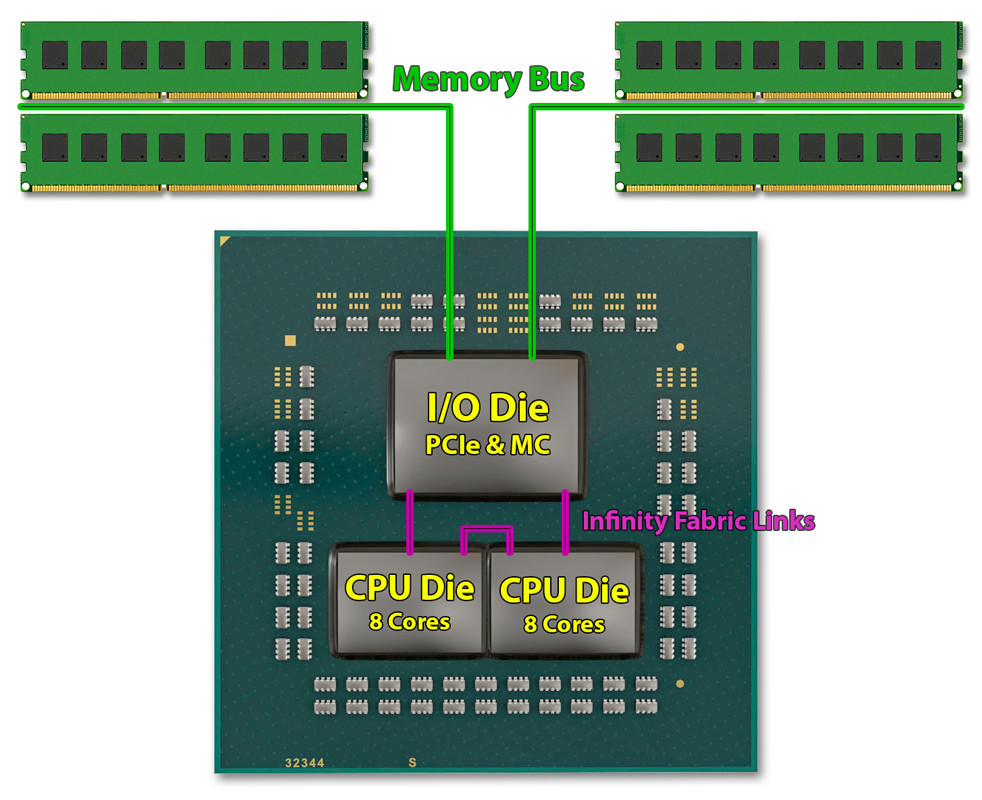

The "Matisse" processor will also provide users with finer control over active cores. Since the AM4 package has two 8-core chiplets, you will have the option to disable an entire chiplet, or adjust the core-count in decrements of 2, since each 8-core chiplet consists of two 4-core CCX (compute complexes), much like existing AMD designs. At the chiplet-level you can dial down core counts from 4+4 to 3+3, 2+2, and 1+1, but never asymmetrically, such as 4+0 (which was possible on first-generation Zen). AMD is synchronizing CCX core counts for optimal utilization of L3 cache and memory access. For the 64-core Threadripper that has eight 8-core chiplets, you will be able to disable chiplets as long as you have at least two chiplets enabled.
ja , bleibt wohl bei 4 Kernen pro CCX , aber wie sieht das synchronisieren wohl aus ?
1. sieht man hier ganz gut
781340
2. Wie die Synchronisierung läuft, weiß man bisher nicht, da gibts nur viele Vermutungen. Es kommt auch darauf an, wieviel Logik im i/o Die verbaut ist.
