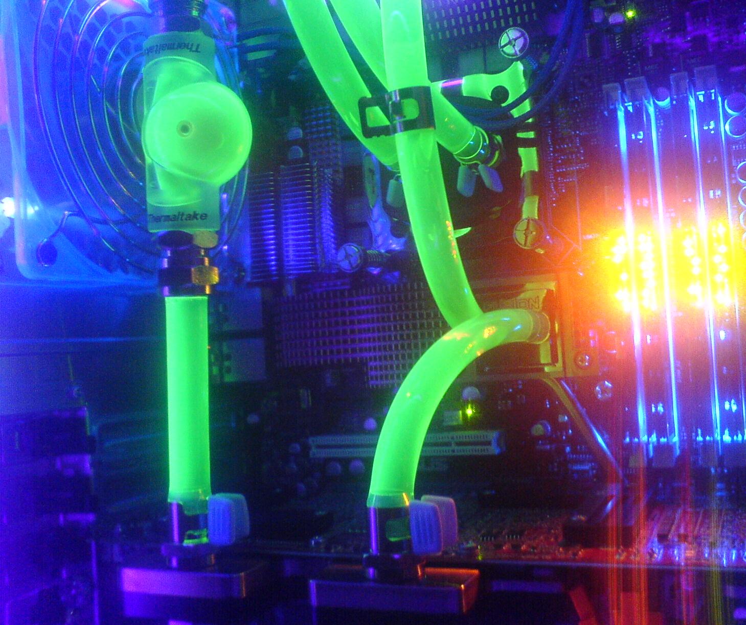

@ anhang my Card on water :cool_alt:
3dmark 05 benchstable @ 972 chip 1150 Memory
Ek waterblock`s idle temp 29 °c @ 25 °c Water temp
last temp 38 c° @ 25 °c water temp
i need pencil mod for more performance :-/ ore a very easy Hard mod i have too left hands:eek::freak::freak::freaky: :D my english is bad
