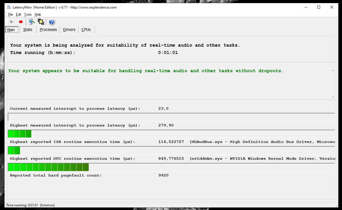

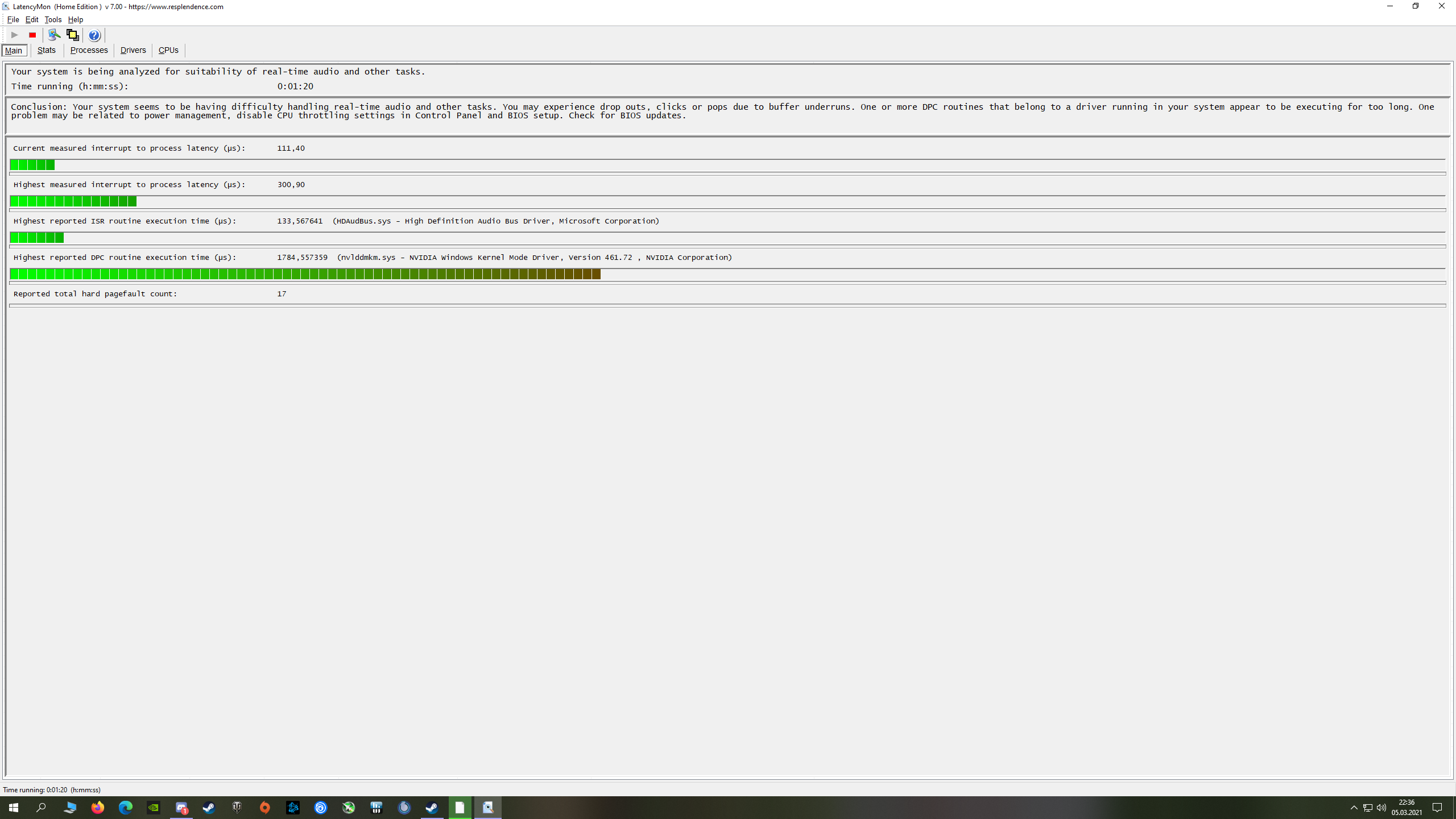

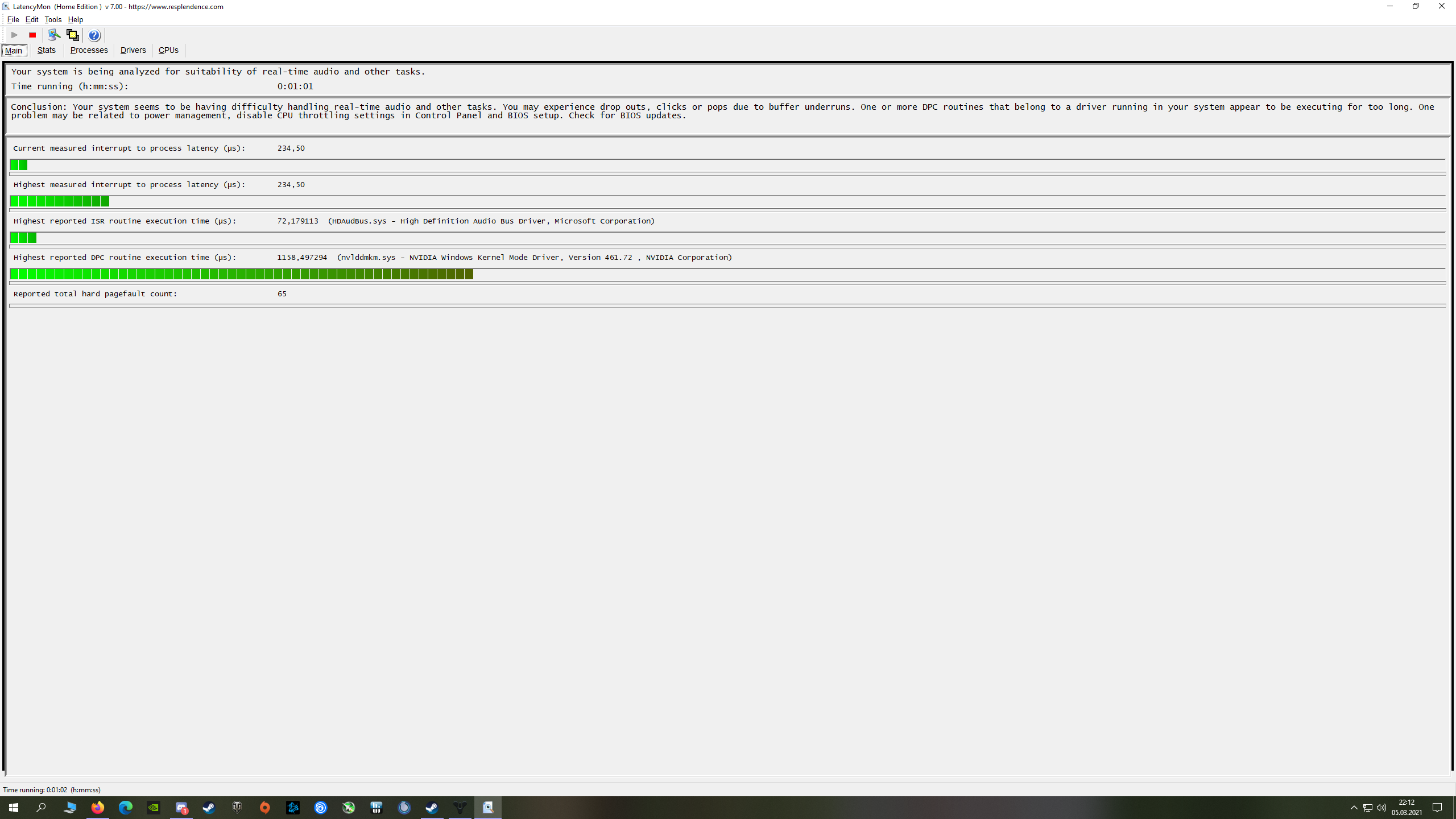

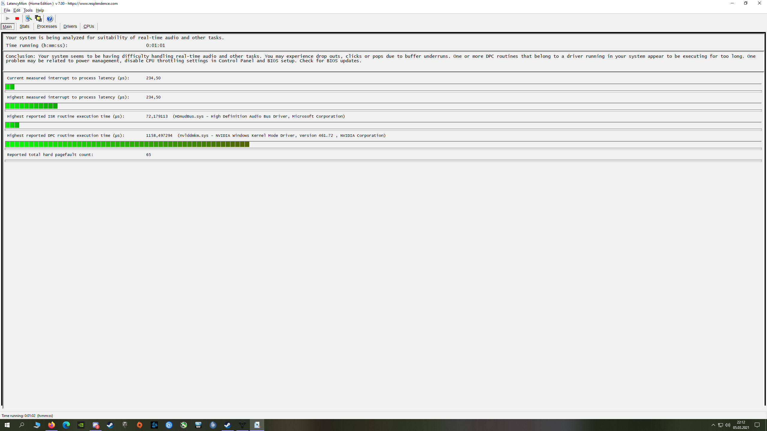

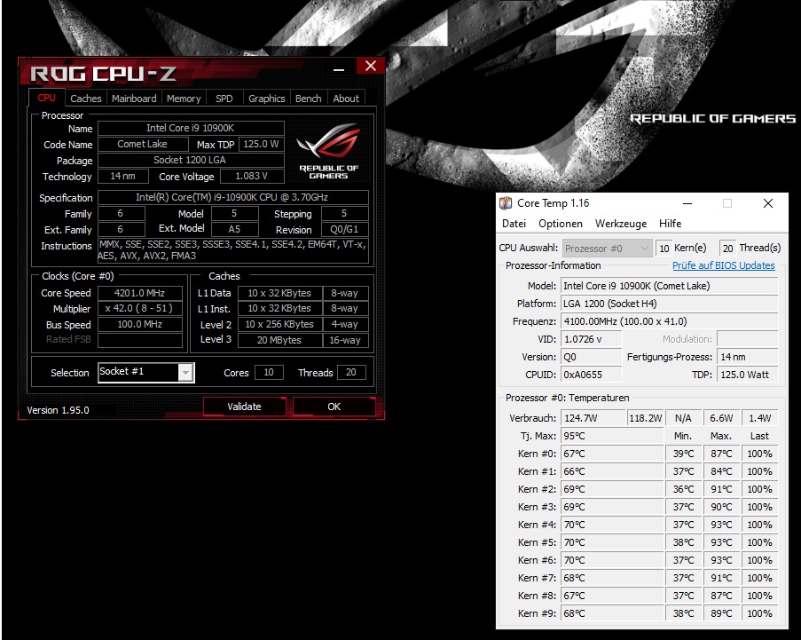

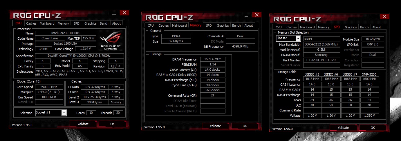

CONCLUSION
_________________________________________________________________________________________________________
Your system seems to be having difficulty handling real-time audio and other tasks. You may experience drop outs, clicks or pops due to buffer underruns. One or more DPC routines that belong to a driver running in your system appear to be executing for too long. One problem may be related to power management, disable CPU throttling settings in Control Panel and BIOS setup. Check for BIOS updates.
LatencyMon has been analyzing your system for 0:05:06 (h:mm:ss) on all processors.
SYSTEM INFORMATION
Computer name: DESKTOP-G3PALAA
OS version: Windows 10 , 10.0, build: 19042 (x64)
Hardware: ASUS, ASUSTeK COMPUTER INC., ROG STRIX Z490-E GAMING
CPU: GenuineIntel Intel(R) Core(TM) i9-10900K CPU @ 3.70GHz
Logical processors: 20
Processor groups: 1
RAM: 32669 MB total
CPU SPEED
Reported CPU speed: 3696 MHz
Note: reported execution times may be calculated based on a fixed reported CPU speed. Disable variable speed settings like Intel Speed Step and AMD Cool N Quiet in the BIOS setup for more accurate results.
WARNING: the CPU speed that was measured is only a fraction of the CPU speed reported. Your CPUs may be throttled back due to variable speed settings and thermal issues. It is suggested that you run a utility which reports your actual CPU frequency and temperature.
MEASURED INTERRUPT TO USER PROCESS LATENCIES
The interrupt to process latency reflects the measured interval that a usermode process needed to respond to a hardware request from the moment the interrupt service routine started execution. This includes the scheduling and execution of a DPC routine, the signaling of an event and the waking up of a usermode thread from an idle wait state in response to that event.
Highest measured interrupt to process latency (µs): 228,80
Average measured interrupt to process latency (µs): 3,753836
Highest measured interrupt to DPC latency (µs): 220,70
Average measured interrupt to DPC latency (µs): 1,615859
REPORTED ISRs
Interrupt service routines are routines installed by the OS and device drivers that execute in response to a hardware interrupt signal.
Highest ISR routine execution time (µs): 185,638528
Driver with highest ISR routine execution time: HDAudBus.sys - High Definition Audio Bus Driver, Microsoft Corporation
Highest reported total ISR routine time (%): 0,000963
Driver with highest ISR total time: Wdf01000.sys - Kernelmodustreiber-Frameworklaufzeit, Microsoft Corporation
Total time spent in ISRs (%) 0,001502
ISR count (execution time <250 µs): 89262
ISR count (execution time 250-500 µs): 0
ISR count (execution time 500-999 µs): 0
ISR count (execution time 1000-1999 µs): 0
ISR count (execution time 2000-3999 µs): 0
ISR count (execution time >=4000 µs): 0
REPORTED DPCs
DPC routines are part of the interrupt servicing dispatch mechanism and disable the possibility for a process to utilize the CPU while it is interrupted until the DPC has finished execution.
Highest DPC routine execution time (µs): 1124,010281
Driver with highest DPC routine execution time: nvlddmkm.sys - NVIDIA Windows Kernel Mode Driver, Version 461.72 , NVIDIA Corporation
Highest reported total DPC routine time (%): 0,018247
Driver with highest DPC total execution time: Wdf01000.sys - Kernelmodustreiber-Frameworklaufzeit, Microsoft Corporation
Total time spent in DPCs (%) 0,040786
DPC count (execution time <250 µs): 229696
DPC count (execution time 250-500 µs): 0
DPC count (execution time 500-999 µs): 295
DPC count (execution time 1000-1999 µs): 1
DPC count (execution time 2000-3999 µs): 0
DPC count (execution time >=4000 µs): 0
REPORTED HARD PAGEFAULTS
Hard pagefaults are events that get triggered by making use of virtual memory that is not resident in RAM but backed by a memory mapped file on disk. The process of resolving the hard pagefault requires reading in the memory from disk while the process is interrupted and blocked from execution.
NOTE: some processes were hit by hard pagefaults. If these were programs producing audio, they are likely to interrupt the audio stream resulting in dropouts, clicks and pops. Check the Processes tab to see which programs were hit.
Process with highest pagefault count: svchost.exe
Total number of hard pagefaults 1181
Hard pagefault count of hardest hit process: 490
Number of processes hit: 12
PER CPU DATA
CPU 0 Interrupt cycle time (s): 2,806106
CPU 0 ISR highest execution time (µs): 93,201840
CPU 0 ISR total execution time (s): 0,005589
CPU 0 ISR count: 633
CPU 0 DPC highest execution time (µs): 529,087121
CPU 0 DPC total execution time (s): 0,090186
CPU 0 DPC count: 27736
CPU 1 Interrupt cycle time (s): 8,853698
CPU 1 ISR highest execution time (µs): 185,638528
CPU 1 ISR total execution time (s): 0,027810
CPU 1 ISR count: 3526
CPU 1 DPC highest execution time (µs): 1124,010281
CPU 1 DPC total execution time (s): 0,792970
CPU 1 DPC count: 65398
CPU 2 Interrupt cycle time (s): 2,150390
CPU 2 ISR highest execution time (µs): 0,0
CPU 2 ISR total execution time (s): 0,0
CPU 2 ISR count: 0
CPU 2 DPC highest execution time (µs): 822,017857
CPU 2 DPC total execution time (s): 0,030080
CPU 2 DPC count: 3754
CPU 3 Interrupt cycle time (s): 2,380843
CPU 3 ISR highest execution time (µs): 0,0
CPU 3 ISR total execution time (s): 0,0
CPU 3 ISR count: 0
CPU 3 DPC highest execution time (µs): 467,779762
CPU 3 DPC total execution time (s): 0,004096
CPU 3 DPC count: 760
CPU 4 Interrupt cycle time (s): 1,099746
CPU 4 ISR highest execution time (µs): 0,0
CPU 4 ISR total execution time (s): 0,0
CPU 4 ISR count: 0
CPU 4 DPC highest execution time (µs): 162,639069
CPU 4 DPC total execution time (s): 0,001866
CPU 4 DPC count: 342
CPU 5 Interrupt cycle time (s): 1,109234
CPU 5 ISR highest execution time (µs): 0,0
CPU 5 ISR total execution time (s): 0,0
CPU 5 ISR count: 0
CPU 5 DPC highest execution time (µs): 173,533009
CPU 5 DPC total execution time (s): 0,006450
CPU 5 DPC count: 1465
CPU 6 Interrupt cycle time (s): 1,113691
CPU 6 ISR highest execution time (µs): 0,0
CPU 6 ISR total execution time (s): 0,0
CPU 6 ISR count: 0
CPU 6 DPC highest execution time (µs): 151,167749
CPU 6 DPC total execution time (s): 0,003461
CPU 6 DPC count: 442
CPU 7 Interrupt cycle time (s): 1,112227
CPU 7 ISR highest execution time (µs): 0,0
CPU 7 ISR total execution time (s): 0,0
CPU 7 ISR count: 0
CPU 7 DPC highest execution time (µs): 149,094697
CPU 7 DPC total execution time (s): 0,001330
CPU 7 DPC count: 202
CPU 8 Interrupt cycle time (s): 1,835255
CPU 8 ISR highest execution time (µs): 0,0
CPU 8 ISR total execution time (s): 0,0
CPU 8 ISR count: 0
CPU 8 DPC highest execution time (µs): 182,972944
CPU 8 DPC total execution time (s): 0,007172
CPU 8 DPC count: 1570
CPU 9 Interrupt cycle time (s): 1,866130
CPU 9 ISR highest execution time (µs): 0,0
CPU 9 ISR total execution time (s): 0,0
CPU 9 ISR count: 0
CPU 9 DPC highest execution time (µs): 558,410173
CPU 9 DPC total execution time (s): 0,006385
CPU 9 DPC count: 999
CPU 10 Interrupt cycle time (s): 3,450424
CPU 10 ISR highest execution time (µs): 0,0
CPU 10 ISR total execution time (s): 0,0
CPU 10 ISR count: 0
CPU 10 DPC highest execution time (µs): 612,506494
CPU 10 DPC total execution time (s): 0,060873
CPU 10 DPC count: 4023

Hmm, aus reiner Neugierde habe ich das Tool auch mal laufen lassen.
Da steht ja das alles OK ist, so wie bei Dir auch. Der grüne Satz!
2 Monitore 1 x DP 1 x HDMI. Während der Aufzeichung lief auf dem zweiten Monitor American Dad als Stream vom SAT Reciever.

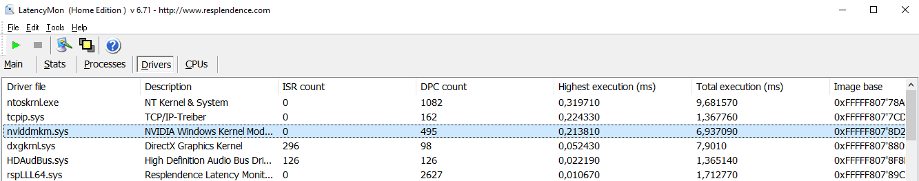

naja, du hast 295 auf dem Nvidia Treiber, im Energiesparplan Ausgewogen liege ich bei 1500 Spikes nach 2 min Youtube.
Zudem ist der Dxdiag bei 80 bei Dir, meiner bei 1163
295 sind das Windows kernel. NVidia taucht bei mir garnicht auf.. merkwürdigerweise.. Ist aber ein AMD System mit NVidia Graka.
Aber ich kenne mich mit der Materie nicht gut genug aus, daher bin ich hier mal raus :)
stimmt, habe mich verlesen.
schau mal im Tool Latency Mon auf Drivers und sage mir die Werte von nvlddmkm.sys und ntoskrnml.exe, bitte oder poste bitte diesen Screenshot
solange alles im µs bereich ist wie da nagegeben ist das schnell genug, eine millisekunde ist verdammt schnell und das ist langsamer als 999µs
Dein Ram läuft schneller als das XMP Profil, den scheinst du über das XMP Profil übertaktet zu haben. oder gar per anheben von Referenztakten.
Gerade das übertakten vom referenztakt an dem dann auch das pci hängen würde kann zu erheblichen problemen führen.
Jedenfalls sieht es für mich nach instabilem ram oder ähnlichem aus. stelle den mal auf jedec einstellungen.
Nur mal zu den Zeitangaben - du schreibst 1000 Nanosekunden..
1000 Nanosekunden sind 1 µS
1000µS sind 1 mS
1000mS sind 1Sekunde
also 1000 Nanosekunden ist nen fliegenschiss im vorlauf, das ist nicht dein problem!
dazu ist was das programm anzeigt da mit dem Balken µS und auch alles weit unter 1mS und somit auch kein problem.
Dein Problem ist irgendein anderes.
(so ist jedenfalls meine Einschätzung)

okay, hab die Zeiten vertauscht, der Wert allein stimmt jedoch.

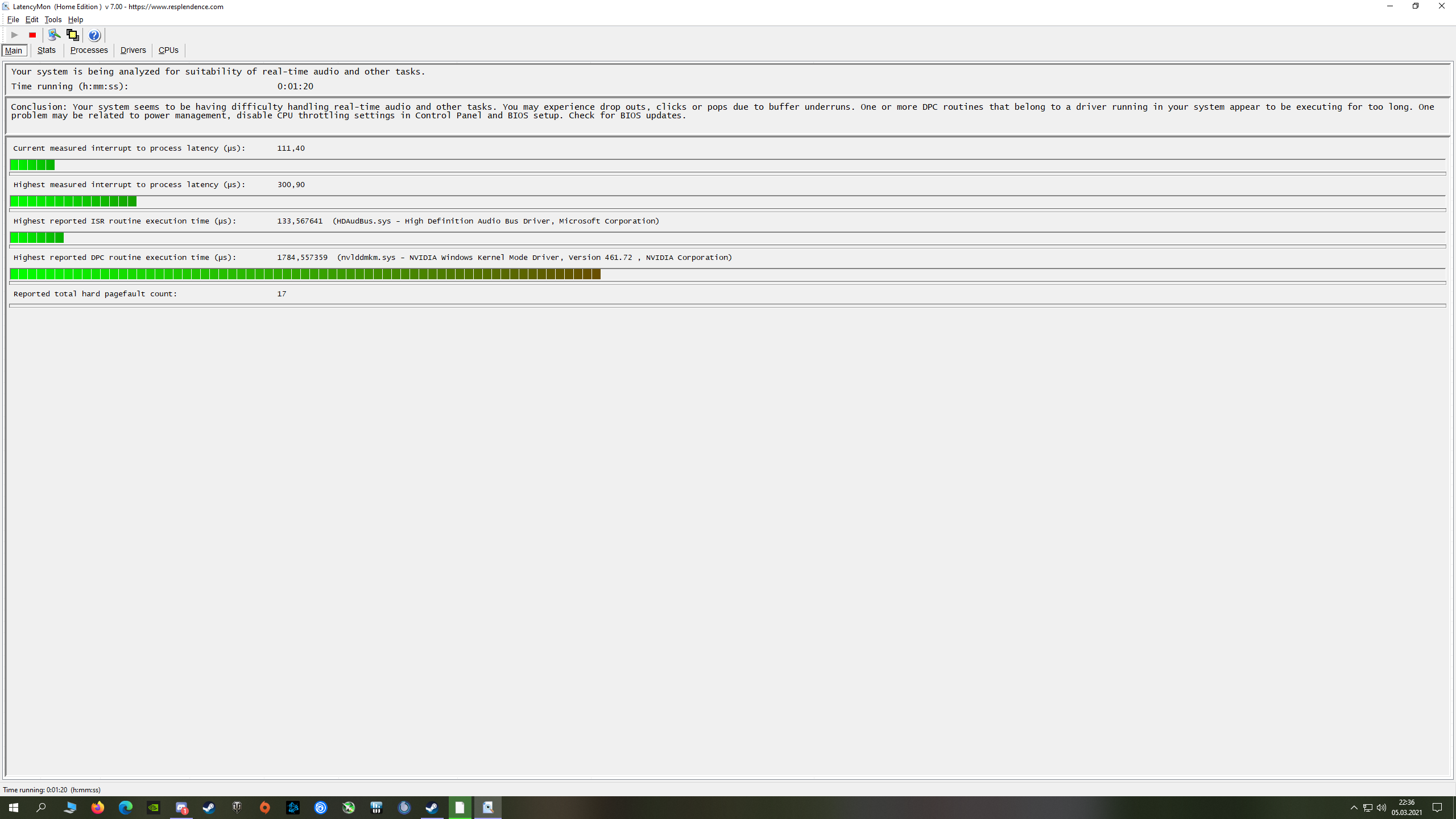

Latency Mon zeigt bei späteren Screenshots auch Drops/Outs an und gibt die Warnung aus.
(Screenshot folgt morgen)
Habe den RAM eben wieder beim Reboot hochgedreht, ist nun wieder auf XMP Profil.
Allerdings kann ich den RAM ausschließen, weil hier ein zweites Test-Kit liegt. Hab ich heute getestet.
Eventuell sind es sonst die Bänke, die werde ich am Wochenende mit testen.

Hab der Karte nun alle drei 8 Pins vom Nt einzeln geliefert.
Das MB hat lediglich 8+4 für CPU, den 4er lasse ich heute weg.
Die Spikes sind nun niedriger und liegen unterhalb von 1000, sind leider jedoch nicht ganz weg.
Richtig zufrieden werde ich erst bei Werten unter 500 sein.
Ich tausche morgen den PCIe Slot und werde im Kabel Set nach einem 4+4 CPU Kabel suchen und anschließen.

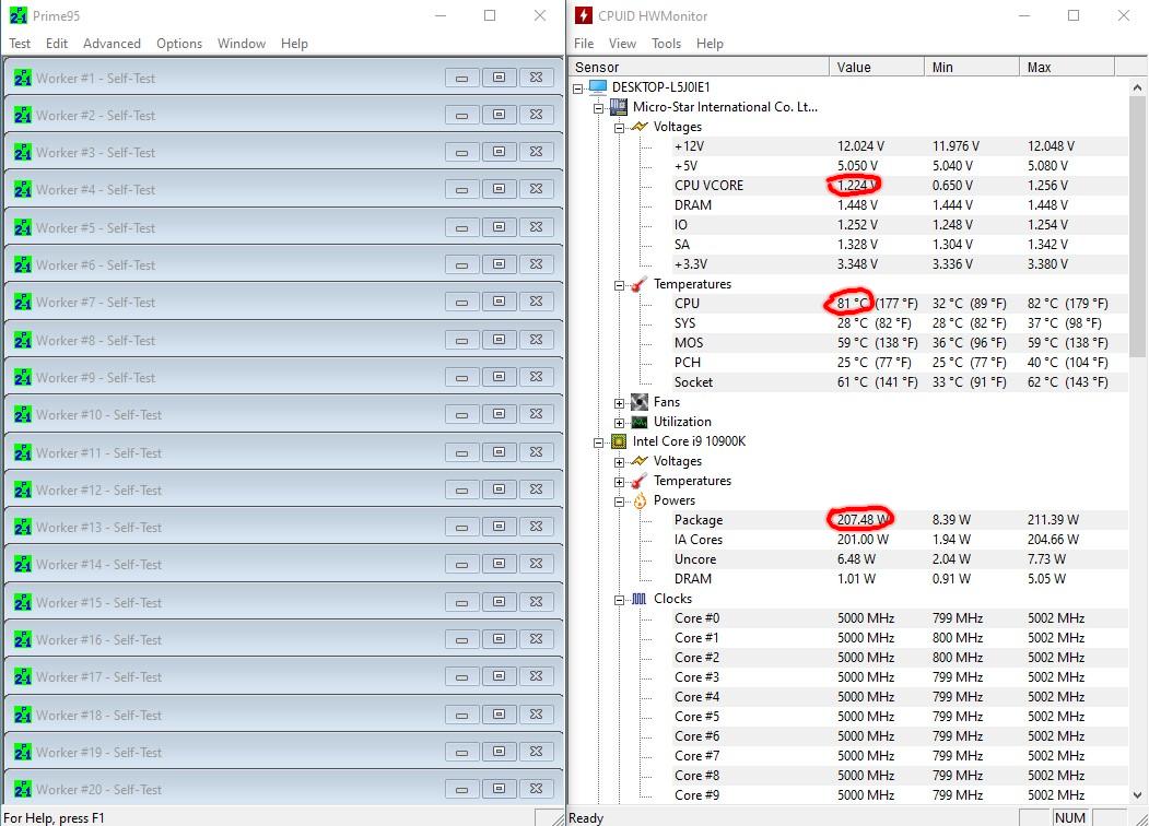

Mach mal Prime95 (Just Stresstest) Small FFTs ohne AVX (unten alle Haken setzen).
Vielleicht geht dem Macho die Puste aus weil ein 10900K@1,3V zieht bis zu 250W.
max 93°C innerhalb Tau von 56 Sek mit 225Watt, konstante 4900 Mhz, Vcore 1,288Volt.
Tj Max. habe ich auf 95°C im Bios gestellt. Wird aber nicht erreicht.
Nach 56 Sek. 4100-4200 Mhz, max. 1,083 Vcore mit 125 Watt.
Da ist alles save, Kiste ist Primestable.
Hab CustomRun von 4 bis 8192K FFT Size mit 2 Min je Size früher bereits laufen lassen.
