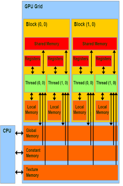

Der lokale Grafikspeicher dient aber nicht nur zur Texturspeicherung und nicht alle Operationen benötigen Texturen. Unter CUDA ist das klar geregelt.
http://cuda-programming.blogspot.com/2013/02/texture-memory-in-cuda-what-is-texture.html
Darum geht es letztendlich. Der Texturspeicher, der bei Spielen den größten Speicherbedarf darstellt, kann vermutlich zu einem Pool zusammengefasst werden und wird nicht mehr doppelt verwendet. Mit SLI war das noch keine Option.

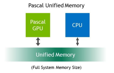

EDIT: Aktuell gibt es diese "Einschränkung" auch nicht mehr
Pascal GP100 Unified Memory
Expanding on the benefits of CUDA 6 Unified Memory, Pascal GP100 adds features to further simplifyprogramming and sharing of memory between CPU and GPU, and allowing easier porting of CPU parallel compute applications to use GPUs for tremendous speedups. Two main hardware features enable theseimprovements: support for large address spaces and page faulting capability. GP100 extends GPU addressing capabilities to enable 49-bit virtual addressing. This is large enough to cover the 48-bit virtual address spaces of modern CPUs, as well as the GPU's own memory. This allows GP100 Unified Memory programs to access the full address spaces of all CPUs and GPUs in the system as a single virtual address space, unlimited by the physical memory size of any one processor (see Figure 21). Memory page faulting support in GP100 is a crucial new feature that provides more seamless Unified Memory functionality. Combined with the system-wide virtual address space, page faulting provides several benefits. First, page faulting means that the CUDA system software does not need to synchronize all managed memory allocations to the GPU before each kernel launch. If a kernel running on the GPU accesses a page that is not resident in its memory, it faults, allowing the page to be automatically migrated to the GPU memory on-demand. Alternatively, the page may be mapped into the GPU address space for access over the PCIe or NVLink interconnects (mapping on access can sometimes be faster than migration). Note that Unified Memory is system-wide: GPUs (and CPUs) can fault and migrate memory pages either from CPU memory or from the memory of other GPUs in the system.
