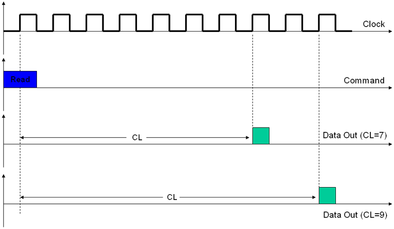

CAS Latency (CL): schrieb:
CAS Latency. The time it takes between a command having been sent to the memory and when it begins to reply to it. It is the time it takes between the processor asking for some data from the memory and then returning it.

Es mach 0,66 ns (1 Nanosekunde (ns) = 0,000000001 Sekunde) aus:
Formel: x = 1 / (Takt / 2) * CL
DDR4-3000, CL 15 und 16
CL = 15: 1 / (3000.000.000 / 2) * 15 / 0,000000001 = 10,00 ns
CL = 16: 1 / (3000.000.000 / 2) * 16 / 0,000000001 = 10,66 ns
