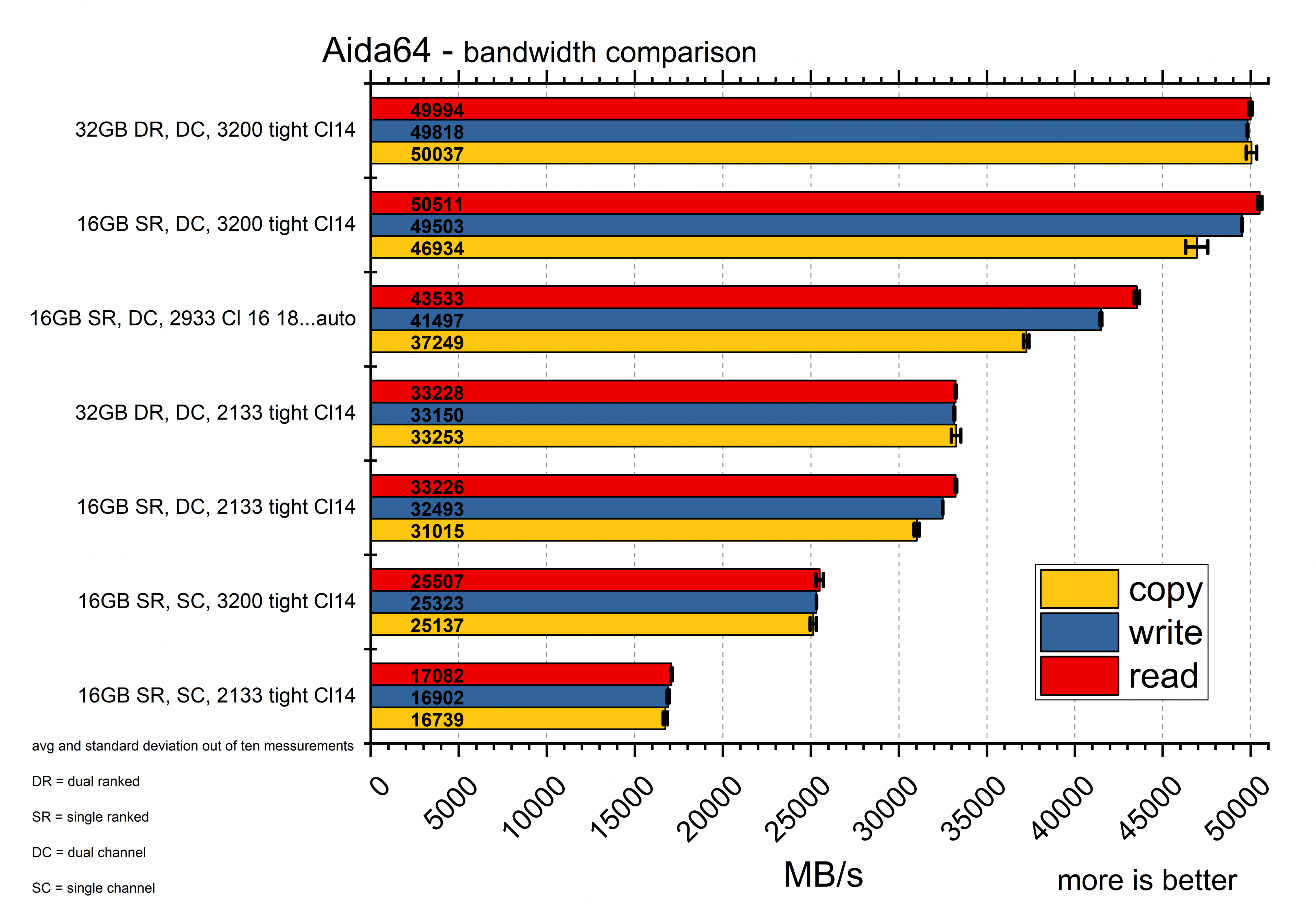

https://www.computerbase.de/forum/threads/dual-ranked-vs-single-ranked-ram-bei-ryzen.1816973/
