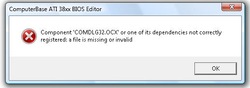

BIOS Editor - V0.93 Beta is not working under Vista Ultimat 64Bit :(
Sorry my german is very Bad :evillol:
@satfreak
Have you already tried to enable the compatibility options? I think the WinXP mode should work for you.
If it won't work, please search google for the missing file(s) and copy it/them into the directory where you have unpacked the editor to.
@aledander
I have tried the compatibel mode on win xp and other ones.
The file "comdlg32.ocx" is NOT missing,...its in the same directory as "38xx Bios Editor.exe"
I think the progam wil not work for 100% because its under Vista 64Bit !!
