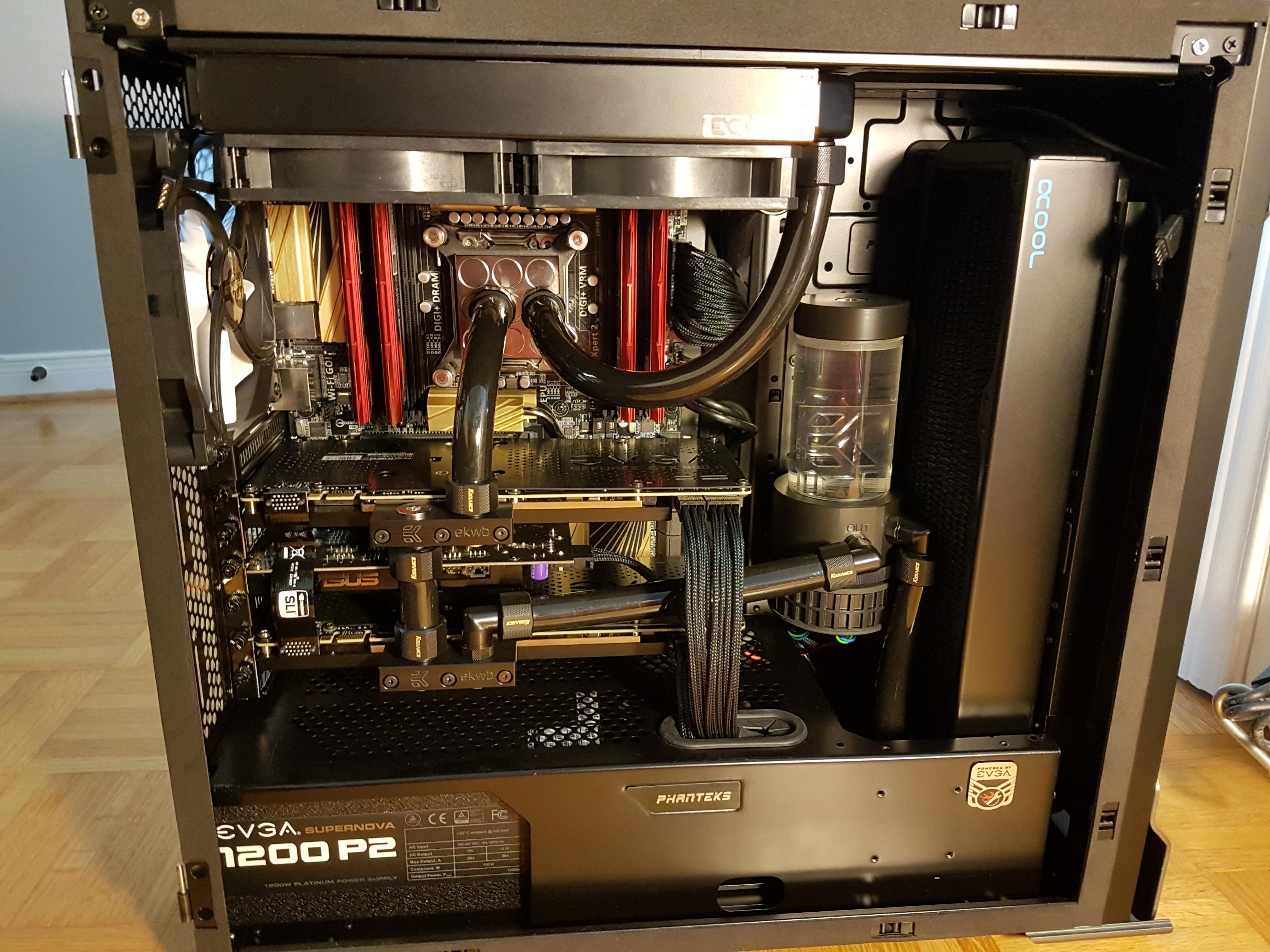

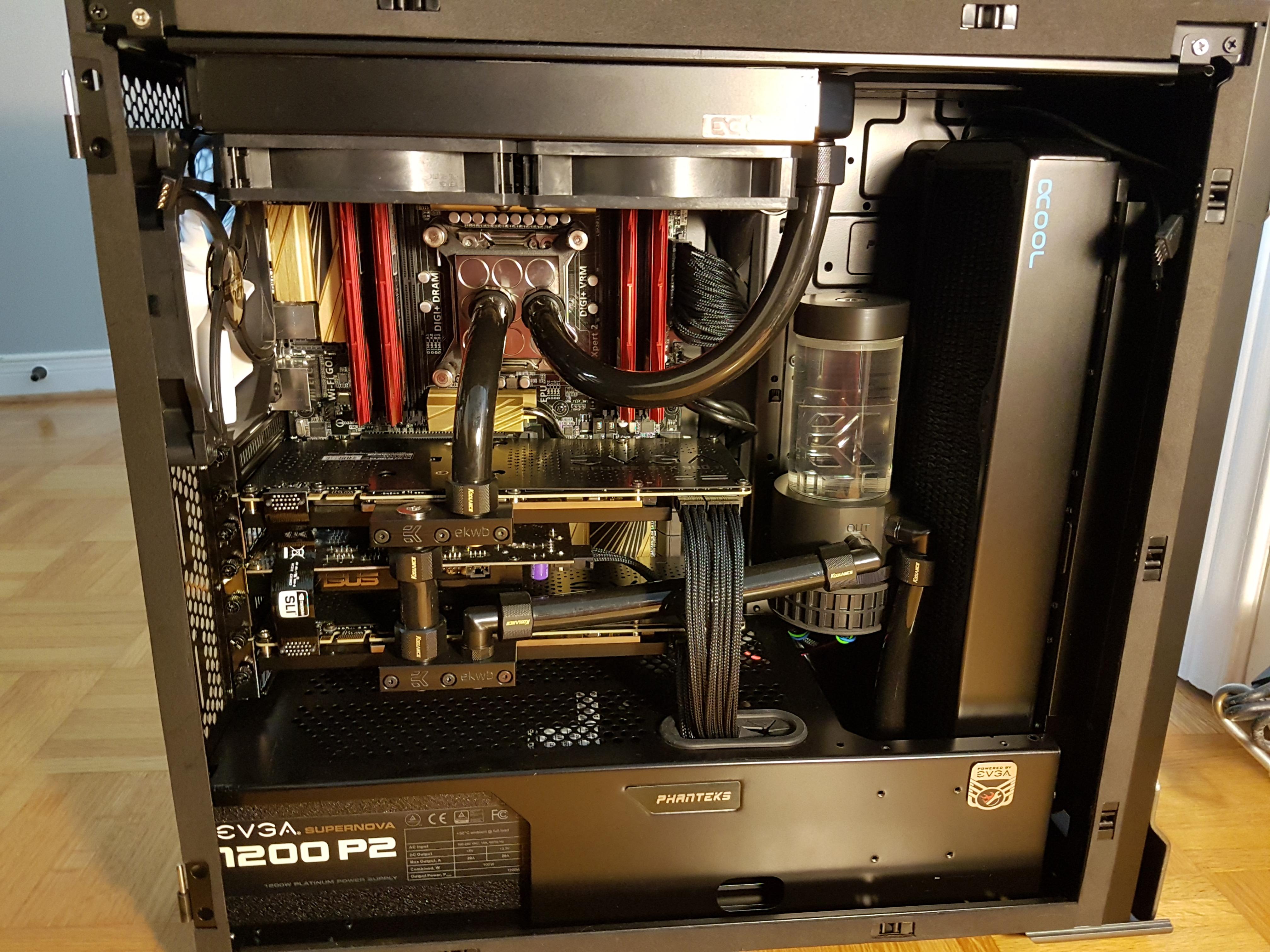

Kleine zwischen Info
Bin gerade auf Reddit unterwegs und lese, dass 360mm + 280mm + HDD Bracket nicht geht:
However there are pros and cons to both.
"360 + 240:
Requires mod to install 3 fans up front
Extra airflow fan up front helps ensure positive air pressure in case (my bottom fan is a high airflow fan because its not on a rad).
Get to keep the HDD bays
360 + 280:
No mod required because you can't get 3 fans up front anyway
You lose the HDD bays no matter what you do
Plumbling is slightly more complicated
You will have to mount the pump/res to the case because there are not any 140mm adapters I know of, and the case doesn't exactly have the best mounting for this."
