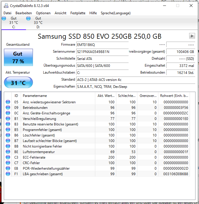

Vorher könntest du aber mal die Festplatten/SSD mit Crystal Disk prüfen und schauen wie die Temperaturen von GPU und CPU aussehen.

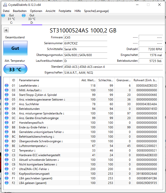

Screenshots von Crystaldiskinfo zu beiden Datenträgern zeigen.

Mainboard
SMBIOS Version: 2.8
BIOS Vendor: American Megatrends Inc.
BIOS Version: P1.70
System Manufacturer: To Be Filled By O.E.M.
System Name: To Be Filled By O.E.M.
System Version: To Be Filled By O.E.M.
Mainboard Manufacturer: ASRock
Mainboard Name: Z97 Extreme3
Mainboard Version:
Processor Manufacturer: Intel
Processor Version: Intel(R) Core(TM) i7-4790K CPU @ 4.00GHz
Processor Core Count: 4
Processor Core Enabled: 4
Processor Thread Count: 8
Processor External Clock: 100 Mhz
LPC NCT677X
Chip ID: 0xC330
Chip revision: 0x33
Base Adress: 0x0290
CPUID
Processor 0
Processor Vendor: Intel
Processor Brand: Intel(R) Core(TM) i7-4790K CPU @ 4.00GHz
Family: 0x6
Model: 0x3C
Stepping: 0x3
CPUID Return Values
CPU Group: 0
CPU Thread: 0
APIC ID: 0
Processor ID: 0
Core ID: 0
Thread ID: 0
Intel CPU
Name: Intel Core i7-4790K
Number of Cores: 4
Threads per Core: 2
Timer Frequency: 10 MHz
Time Stamp Counter: Invariant
Estimated Time Stamp Counter Frequency: 3990.83 MHz
Estimated Time Stamp Counter Frequency Error: 0.11174 Mhz
Time Stamp Counter Frequency: 3990.77 MHz
AMD Display Library
ADL Status: ERR
ADL2 Status: ERR
Graphics Versions
Status: DLL not found
NVAPI
Version: NVidia Complete Version 1.10
NVML
Status: Success
Number of GPUs: 1
Nvidia GPU
Name: NVIDIA NVIDIA GeForce GTX 970
Index: 0
Driver Version: 471.11
Driver Branch: r470_96-9
DeviceID: 0x13C210DE
SubSystemID: 0x31601462
RevisionID: 0xA1
ExtDeviceID: 0x13C2
Thermal Settings
Sensor[0].Controller: GPU_INTERNAL
Sensor[0].DefaultMinTemp: 0
Sensor[0].DefaultMaxTemp: 127
Sensor[0].CurrentTemp: 59
Sensor[0].Target: GPU
Cooler Settings
Cooler[0].Type: 1
Cooler[0].Controller: 1
Cooler[0].DefaultMin: 0
Cooler[0].DefaultMax: 100
Cooler[0].CurrentMin: 0
Cooler[0].CurrentMax: 100
Cooler[0].CurrentLevel: 66
Cooler[0].DefaultPolicy: 16
Cooler[0].CurrentPolicy: 16
Cooler[0].Target: 7
Cooler[0].ControlType: 2
Cooler[0].Active: 0
Memory Info
Value[0]: 4194304
Value[1]: 4140672
Value[2]: 0
Value[3]: 16751988
Value[4]: 3742760
Fan Coolers Status
Status: NOT_SUPPORTED
GenericHarddisk
Drive name: ST31000524AS
Firmware version: JC45
ID Description Raw Value Worst Value Thres Physical
01 Read Error Rate B449ED0A0000 99 118 6 -
03 Spin-Up Time 000000000000 100 100 0 -
04 Start/Stop Count 6E0600000000 99 99 20 1646
05 Reallocated Sectors Count 000000000000 100 100 36 -
07 Seek Error Rate 1F393B040000 60 78 30 -
09 Power-On Hours (POH) 5C1600000000 94 94 0 5724
0A Spin Retry Count 000000000000 100 100 97 -
0C Power Cycle Count 280600000000 99 99 20 1576
B7 SATA Downshift Error Count 000000000000 100 100 0 0
B8 End-to-End error 000000000000 100 100 99 -
BB Reported Uncorrectable Errors 000000000000 100 100 0 0
BC Command Timeout 000000000000 100 100 0 0
BD High Fly Writes 000000000000 100 100 0 -
BE Temperature Difference from 100 220020220000 54 66 45 34
C2 Temperature 220000000E00 46 34 0 34
C3 Hardware ECC Recovered B449ED0A0000 24 41 0 -
C5 Current Pending Sector Count 000000000000 100 100 0 -
C6 Uncorrectable Sector Count 000000000000 100 100 0 -
C7 UltraDMA CRC Error Count 000000000000 200 200 0 -
F0 Head Flying Hours A72600001E69 253 100 0 -
F1 Total LBAs Written 5EF456B90000 253 100 0 -
F2 Total LBAs Read 875DD0290000 253 100 0 -
Logical drive name: D:\
Format: NTFS
Total size: 1000202039296
Total free space: 364452397056

vinno.lowell schrieb:
