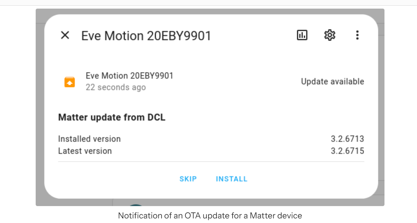

One of the great features of Matter is the so-called Multi Fabric feature: you can join the same device to multiple controllers. For example, simultaneously add it to Google Home, Apple Home, and Home Assistant. The standard describes that each device should be able to at least support 5 different fabrics simultaneously.
Each Matter network is called a fabric. Each home automation controller that controls Matter devices has its own “fabric”. You can add devices directly to the fabric of your Home Assistant instance, or share them from another fabric (for example from Google or Apple) to Home Assistant’s fabric. We’re going to explore all these options below.
https://www.home-assistant.io/integrations/matter/
