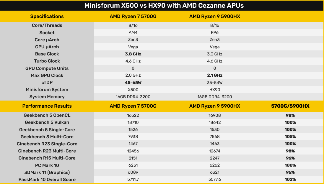

AMD Ryzen 7 5700G vs Ryzen 9 5900HX​
Minisforum is now preparing to launch a new MiniPC equipped with a desktop AMD Cezanne G-Series processor.
https://videocardz.com/newz/minisfo...d-ryzen-9-5900hx-cezanne-mini-pcs-performance
Screenshot 2021-08-13 at 15-06-14 Minisforum compares AMD Ryzen 7 5700G and Ryzen 9 5900HX Cez...png
