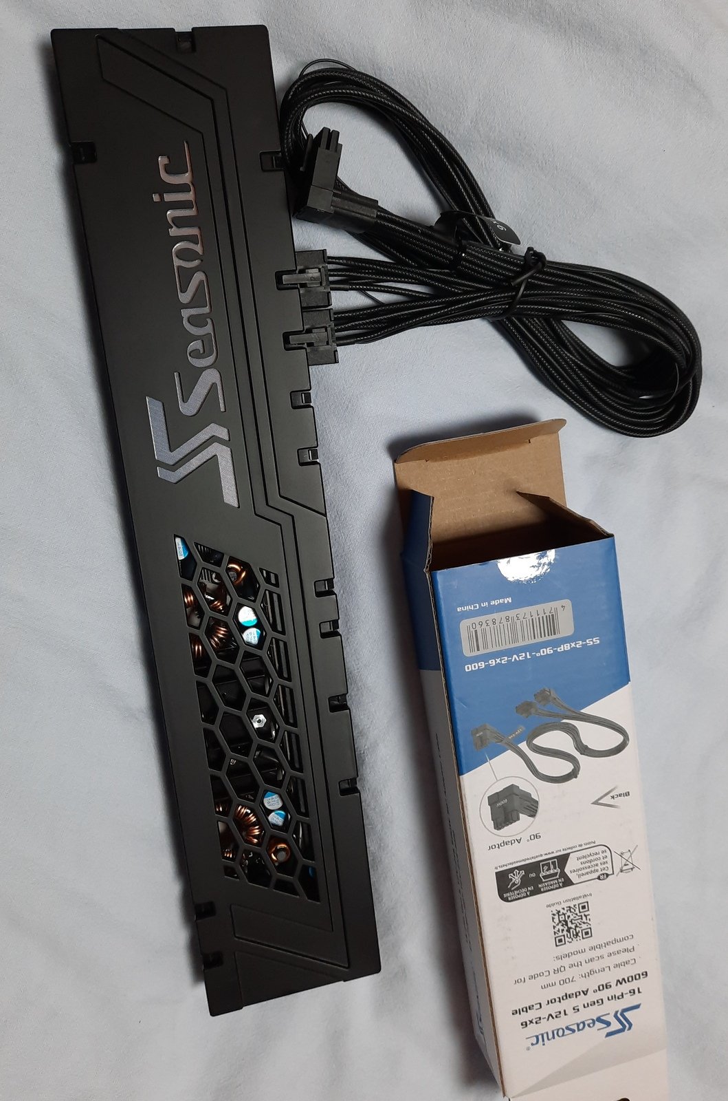

Thanks to the tip from somebody here, I already picked up the cable and I am looking forward to putting this MAGIC ROD back in service! :)
I wonder, if it can handle 5090. I bet it can. Too bad I do not have it, no plastic melting possible yet.
