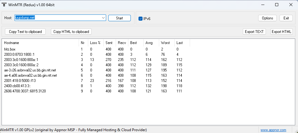

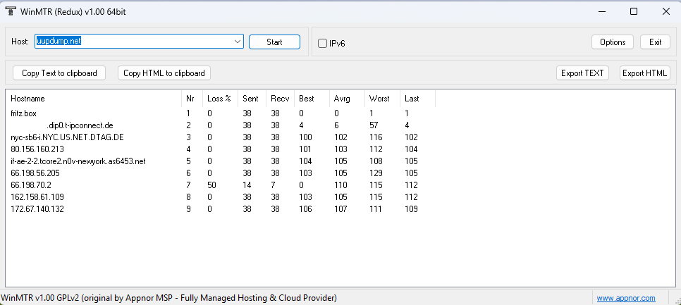

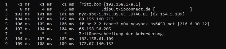

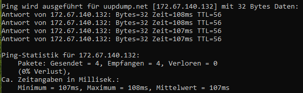

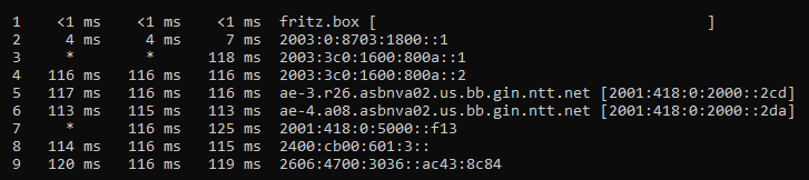

fdsonne schrieb:
@WetMar
und deine besagte Seite uupdump.net?
100ms und mehr und über den Atlantik?

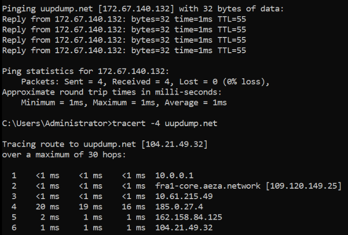

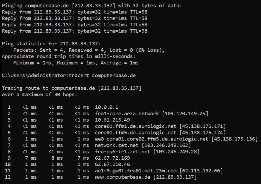

... und per Live Server Terminal:
Code:
.Server created on 19:20 30-05-2025 UTC. Powered by https://aeza.net hosting.
root@377d8b:~# traceroute computerbase.de
traceroute to computerbase.de (212.83.33.137), 30 hops max, 60 byte packets
 1  10.0.0.1 (10.0.0.1)  0.054 ms  0.074 ms  0.040 ms
 2  fra1-core.aeza.network (109.120.149.25)  0.164 ms  0.154 ms  0.171 ms
 3  10.61.215.49 (10.61.215.49)  0.227 ms  0.119 ms  0.114 ms
 4  core01.ffm1.de.aurologic.net (45.138.175.171)  0.418 ms  0.361 ms  0.338 ms
 5  * * *
 6  ae0-core01.core02.ffm5.de.aurologic.net (45.138.175.136)  1.390 ms 100.64.10.110 (100.64.10.110)  1.109 ms ae0-core01.core02.ffm5.de.aurologic.net (45.138.175.136)  1.413 ms
 7  87.119.95.132 (87.119.95.132)  0.494 ms ae0-core01.core02.ffm5.de.aurologic.net (45.138.175.136)  1.564 ms 87.119.95.132 (87.119.95.132)  0.469 ms
 8  fra-eq6-tr1.zet.net (103.246.249.28)  0.822 ms  0.818 ms ae22.cr11-fra2.ip4.gtt.net (89.149.180.226)  1.002 ms
 9  fra-eq6-tr1.zet.net (103.246.249.28)  0.783 ms  0.812 ms *
10  62.67.110.46 (62.67.110.46)  1.244 ms be5970.ccr42.fra05.atlas.cogentco.com (154.54.59.54)  1.449 ms  1.364 ms
11  62.67.110.46 (62.67.110.46)  1.210 ms * ae1-0.gw01.fra01.net.23m.com (62.113.192.66)  1.136 ms
12  be4167.nr21.b015759-0.fra06.atlas.cogentco.com (154.25.3.178)  7.256 ms ae1-0.gw01.fra01.net.23m.com (62.113.192.66)  1.200 ms be4167.nr21.b015759-0.fra06.atlas.cogentco.com (154.25.3.178)  7.696 ms
13  * * 149.11.20.223 (149.11.20.223)  1.470 ms
14  * ae1-0.gw01.fra01.net.23m.com (62.113.192.66)  1.225 ms *
Code:
root@377d8b:~# traceroute uupdump.net
traceroute to uupdump.net (104.21.49.32), 30 hops max, 60 byte packets
 1  10.0.0.1 (10.0.0.1)  0.066 ms  0.034 ms  0.032 ms
 2  fra1-core.aeza.network (109.120.149.25)  0.264 ms  0.239 ms  0.248 ms
 3  10.61.215.49 (10.61.215.49)  0.281 ms  0.283 ms  0.258 ms
 4  185.0.27.4 (185.0.27.4)  13.455 ms  13.612 ms  13.587 ms
 5  162.158.84.159 (162.158.84.159)  1.117 ms 162.158.84.185 (162.158.84.185)  3.300 ms  3.265 ms
 6  104.21.49.32 (104.21.49.32)  1.046 ms  1.061 ms  1.050 ms
@WetMar
Sieht bei mir anders aus als bei dir. Was sagt das jetzt aus?

fdsonne schrieb:
Wie erwähnt, was ist mit der naheliegensten Methode, dass die Telekom hier einfach Cloudflare US IPs eben in Amerika ins Netz lässt? Und das hier einfach nur im DNS die falsche IP eingetragen wurde?
Das wäre für mich nicht die naheliegenste Methode, um zu einem CDN zu routen, sondern die mit Abstand denkbar dämlichste Methode. Bei einem CDN gibt es doch gerade keine US-IPs oder EU-IPs mehr. Der ganze Sinn von CDNs ist doch, dass man immer einen Mirror hat, der nahe am Endkunden liegt. Dann sollte der Endkunden-Provider logischerweise auch möglichst nah am Endkunden in das CDN-Netz übergeben?!

fdsonne schrieb:
Aber dennoch muss es ja einen Unterschied geben, warum manche Cloudflare IPs eben über US und andere eben über lokal viel nähere Einstiegspunkte erreichbar sind.
Naja, ich kann diese Unterscheidung bei cloudflare nicht beobachten: Habe für uupdump.net ein vier verschiedene Netze getestet, in denen ich Endpunkte habe (alle in DE). Per DNS bekomme ich immer dieselben beiden IPv4-Adressen und auch dieselben beiden IPv6-Adressen.
Die Endpunkte erreiche beide von allen Standorten in unter 15ms. Am schnellsten schafft es mein ionos-vServer in Berlin mit ~0.6ms.
Die Latenzen zu notebookcheck.com sind übrigens jeweils identisch, auch wenn es andere IPs sind. Die traceroutes sehen auch identisch aus.
Von US-IPs oder EU-IPs also keine Spur. Klar, es wäre möglich, per DNS je nach Herkunfts-IP eine andere IP auszuliefern, aber es sieht mir nicht danach aus, als würde cloudflare das tun. Und wenn du bei der Telekom auch die beiden IPv4-Adresse 172.67.140.132 und 104.21.49.32 bekommst und die trotzdem in den USA übergeben werden, dann ist an der Stelle das routing einfach extrem beacheuert. Und die Frage ist halt, wieso? Announced cloudflare gegenüber der Telekom sinnlose routen, die ihrem Geschäftsziel (Server in Endkundennähe antwortet) widersprechen?
Ja, es gibt keine Beweise, dass die Telekom an allem Schuld ist. Vielleicht haben sich auch die großen CDNs gegen die arme kleine Telekom verschworen, klar. Aber es ist schon komisch, dass niemand sonst hierzulande irgendwo in den USA ins cloudflare-Netz übergeben wird, außer Telekomkunden?

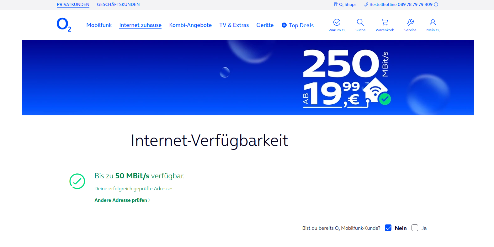

Bin von der teuren Thüringer Netkom enttäuscht. Sie bietet nur IPv4-only & ist teurer als die Telekom.
Zusätzlich ist die FN-Telefonie zum Mobilfunk nicht enthalten wie bei der Telekom, O², und andere ISPs.
Zur Telekom wechseln möchte ich aber auch nicht - gerade wegen dieser Peering-Probleme.
Momentan nutzt ich die Leitung meiner Familie mit. Bin eh kaum zu Hause.
GF soll es ggf. im Herbst geben, aber daran glaube ich nicht. Mir würde außerdem auch 100/40er DSL-Anschluss reichen. Bei 1&1 usw. könnte ich momentan leider nur DSL 16 buchen.
Oh, sehe gerade: O² bietet hier immerhin DSL Edit: LTE 50/10 an. Das wäre dann auch eine Option.
Da wäre sogar ein Tarif mit monatlicher Kündigungsfrist für 35 € möglich (inkl. Telefon-Flat in alle deutschen Netze).
Edit: Ist leider ein LTE-Vertrag. "Irgendeine Kröte muss man wohl immer schlucken." 😆

Tanzmusikus schrieb:
Oh, sehe gerade: O² bietet hier DSL 50/10 an. Das wäre dann ja auch eine Option
Im Screenshot ist deine vollständige Adresse zu sehen. Die 50 Mbit/s von o2 werden über 5G/LTE realisiert, DSL ist auch hier mit maximal 16 Mbit/s verfügbar.
Die Telekom selbst bietet bei dir auch nur mehr als 16 Mbit/s an, weil sie sich über ihre Regio-Tarife ins Netz der NetKom einmietet.
Wenn es sonst kein Coax oder Glasfaser bei dir gibt, bist du was die Anbieterauswahl angeht, schon sehr eingeschränkt.
Reaktionen: OpticalFiber und Tanzmusikus
Danke dir!! Hab die Adresse entfernt.
