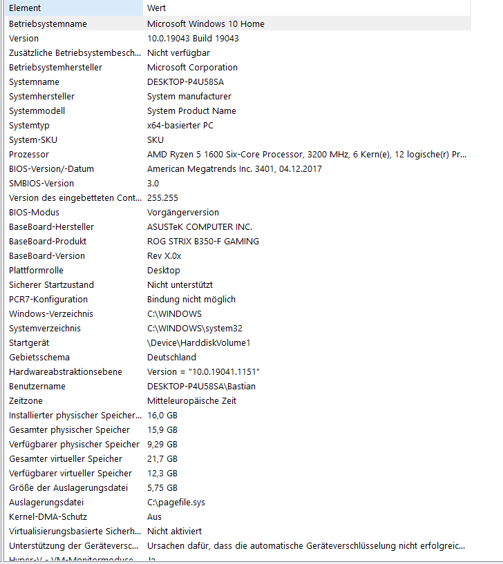

Machine ID Information [From Smbios 3.0, DMIVersion 0, Size=2325]
BiosMajorRelease = 5
BiosMinorRelease = 12
BiosVendor = American Megatrends Inc.
BiosVersion = 3401
BiosReleaseDate = 12/04/2017
SystemManufacturer = System manufacturer
SystemProductName = System Product Name
SystemFamily = To be filled by O.E.M.
SystemVersion = System Version
SystemSKU = SKU
BaseBoardManufacturer = ASUSTeK COMPUTER INC.
BaseBoardProduct = ROG STRIX B350-F GAMING
BaseBoardVersion = Rev X.0x
dein Bios ist veraltet. Da solltest Du ein Update durchführen.
https://rog.asus.com/motherboards/rog-strix/rog-strix-b350-f-gaming-model/helpdesk_bios

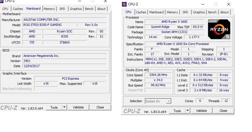

[Processor Information (Type 4) - Length 48 - Handle 0032h]
Socket Designation AM4
Processor Type Central Processor
Processor Family 6bh - AMD Zen Processor Family
Processor Manufacturer Advanced Micro Devices, Inc.
Processor ID 110f8000fffb8b17
Processor Version AMD Ryzen 5 1600 Six-Core Processor
Processor Voltage 8ch - 1.2V
External Clock 100MHz
Max Speed 3700MHz
Current Speed 3200MHz
Status Enabled Populated
Processor Upgrade Socket AM4
L1 Cache Handle 002fh
L2 Cache Handle 0030h
L3 Cache Handle 0031h
Serial Number
Asset Tag Number
Part Number Unknown
Core Count 6
Core Enabled 6
Thread Count 12
Processor Characteristics fc
Der Prozessor ist leicht übertaktet.
Setze den Prozessor auf die Standard Werte.
