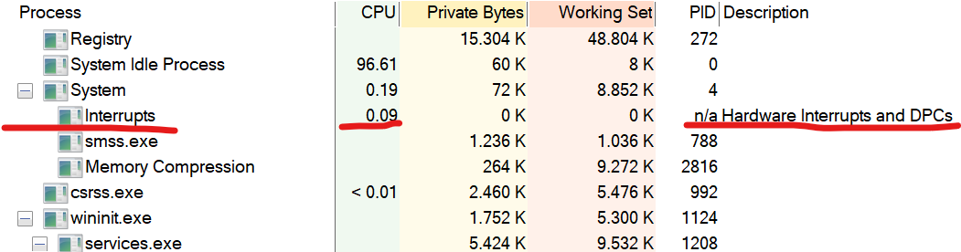

https://www.computerbase.de/downloads/systemtools/process-explorer/
