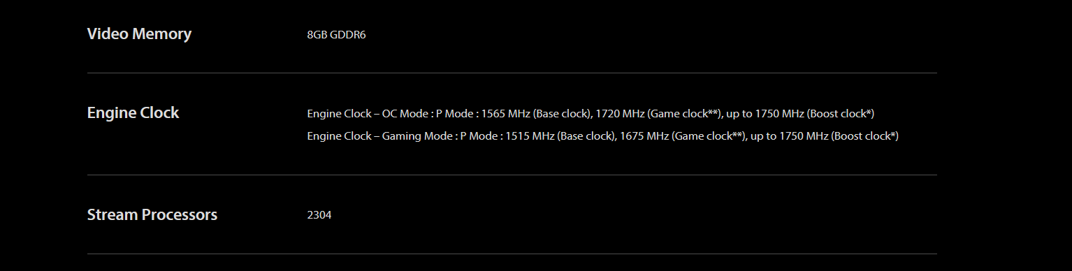

Laut -- https://www.asus.com/motherboards-components/Graphics-Cards/dual/DUAL-RX5700-O8G-EVO/techspec/ -- hat die Grafikkarte 2 "Clock Modi".
