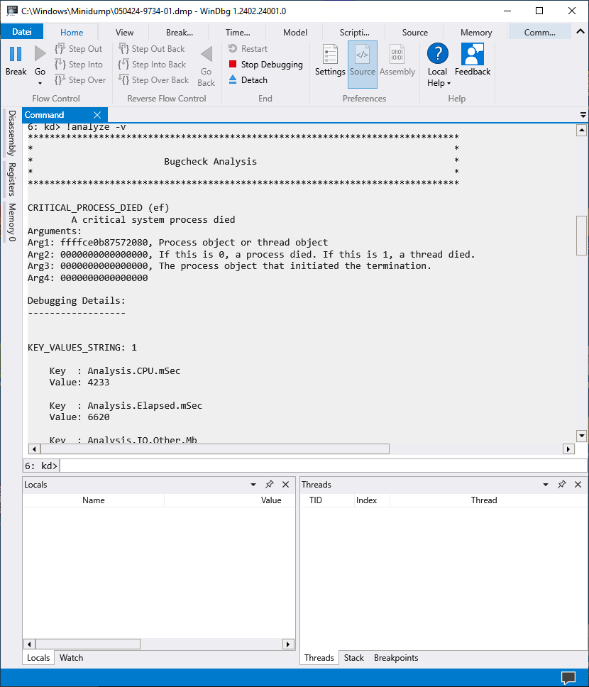

ntoskml.exe ist der Windows Kernel, wenn da der Wurm drin ist....Regenbogenelch schrieb:
Regenbogenelch schrieb:was wäre mein nächster Schritt das Problem zu identifizieren?

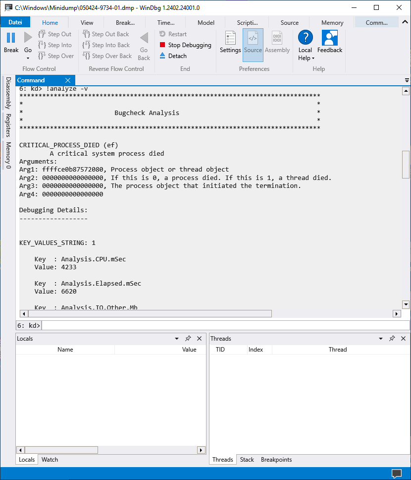

DPC_WATCHDOG_VIOLATION (133)
The DPC watchdog detected a prolonged run time at an IRQL of DISPATCH_LEVEL
or above.
Arguments:
Arg1: 0000000000000001, The system cumulatively spent an extended period of time at
DISPATCH_LEVEL or above.
Arg2: 0000000000001e00, The watchdog period (in ticks).
Arg3: fffff8017211c340, cast to nt!DPC_WATCHDOG_GLOBAL_TRIAGE_BLOCK, which contains
additional information regarding the cumulative timeout
Arg4: 0000000000000000
00 nt!KeBugCheckEx
01 nt!KeAccumulateTicks
02 nt!KiUpdateRunTime
03 nt!KiUpdateTime
04 nt!KeClockInterruptNotify
05 nt!HalpTimerClockInterrupt
06 nt!KiCallInterruptServiceRoutine
07 nt!KiInterruptSubDispatchNoLockNoEtw
08 nt!KiInterruptDispatchNoLockNoEtw
09 nt!KxWaitForSpinLockAndAcquire
0a nt!KeAcquireSpinLockRaiseToDpc
0b rtwlane601
0c 0x0
0d rtwlane601
0e 0x0
0f rtwlane601
10 0x0
- Bugcheck Analysis *
BUGCODE_NDIS_DRIVER (7c)
The operating system detected an error in a networking driver.
The BUGCODE_NDIS_DRIVER BugCheck identifies problems in network drivers.
Often, the defect is caused by a NDIS miniport driver. You can get a complete
list of NDIS miniport drivers using !ndiskd.netadapter. You can get a
big-picture overview of the network stack with !ndiskd.netreport.
Arguments:
Arg1: 0000000000000014, NDIS_BUGCHECK_WAIT_EVENT_HIGH_IRQL
A network driver called NdisWaitEvent at an illegal
IRQL.
Arg2: 0000000000000002, The actual IRQL
Arg3: 0000000000000000, Zero.
Arg4: 0000000000000000, Zero.
Debugging Details:
PROCESS_NAME: System
STACK_TEXT:
ffffd30f`f612ee38 fffff800`2881b4ce : 00000000`0000007c 00000000`00000014 00000000`00000002 00000000`00000000 : nt!KeBugCheckEx
ffffd30f`f612ee40 fffff800`675c70d0 : 00000000`00000000 fffff800`67585e99 00000000`00000000 ffffd30f`f612ef20 : ndis!NdisWaitEvent+0x16dee
ffffd30f`f612ee80 00000000`00000000 : fffff800`67585e99 00000000`00000000 ffffd30f`f612ef20 ffffd30f`f612ef20 : rtwlane601+0x1a70d0
Loaded symbol image file: rtwlane601.sys
Image path: rtwlane601.sys
Image name: rtwlane601.sys
Timestamp: Mon Jul 4 05:35:11 2022

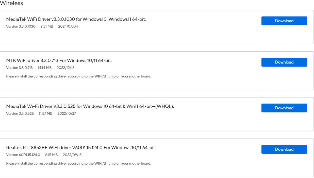

Danke, ich Update dass, lassen sich dadurch auch die anderen BSOD erklären?IDontWantAName schrieb:Der Realtek WLAN Treiber rtwlane601.sys ist das Problem, also ein Treiberupdate machen
Also wenn ich das richtig verstanden habe und dies hier das Problem war, wurde es dadurch ausgelöst weil das Symbolbild der Datei nicht geladen werden konnte?Loaded symbol image file: rtwlane601.sys

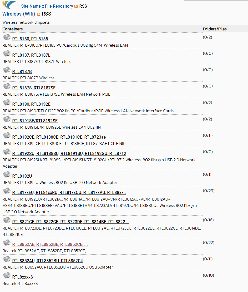

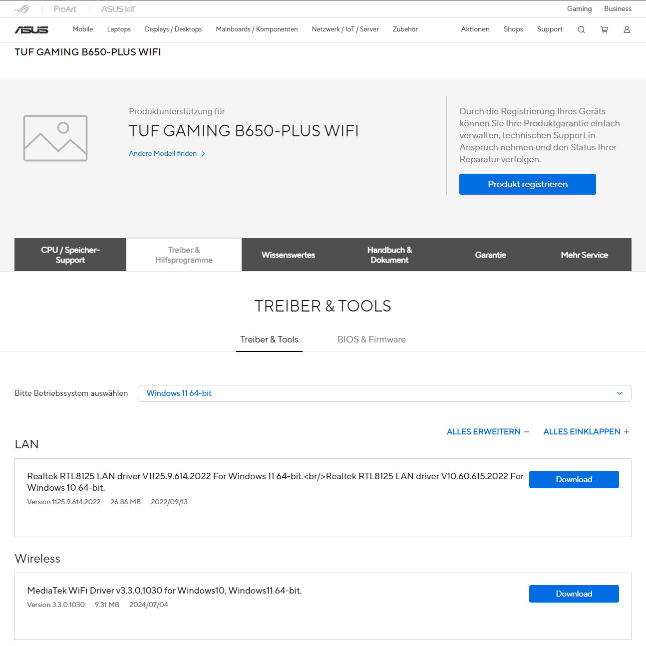

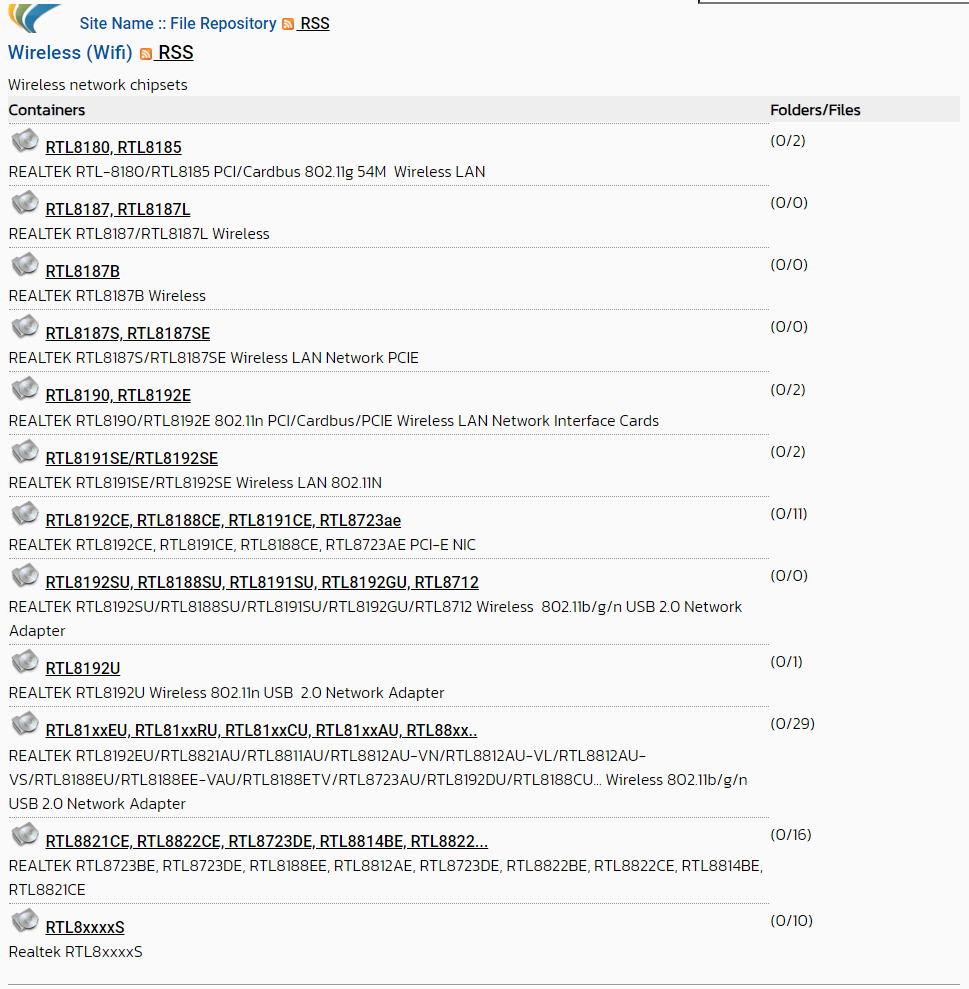

Eigentlich habe ich die Treiber von deren Website gedownloadet, kann aber auch sein, dass das die Falsche Seite ist.Gravlens schrieb:gibt es eigentlich einen Grund weshalb du nicht die Treiber direkt von Asus für dein Mainboard installierst, sind die zu veraltet oder unvollständig?^^
Wow super danke, wie kann es denn sein, dass der Treiber auf der Seite des Herstellers veraltet ist und es neuere Treiber auf einer externen Seite gibt?IDontWantAName schrieb:der Treiber ist von 2022, also hast du den nesuten von der Herstellerseite. Schau mal bei station drivers, da gibt es Treiber aus Juni 2024:
