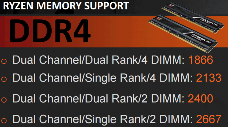

Speichercontroller Dual Channel PC4-21300U (DDR4-2666)

https://en.wikichip.org/wiki/amd/ryzen_7/1700#Memory_controller
