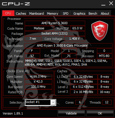

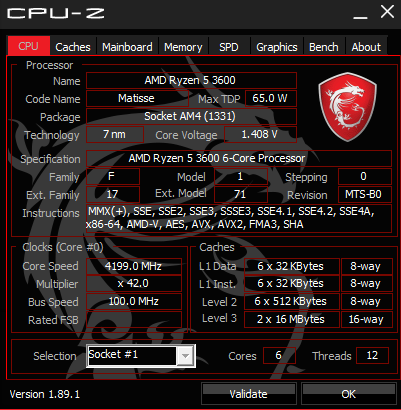

CPU: AMD RYZEN 5 3600

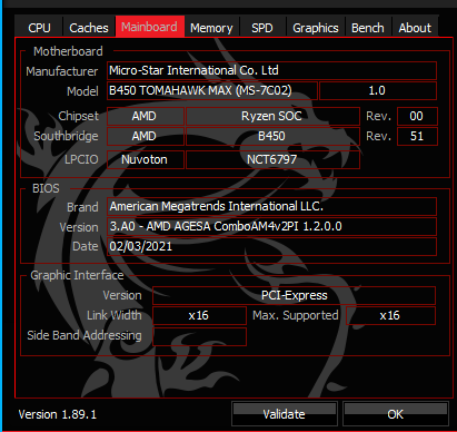

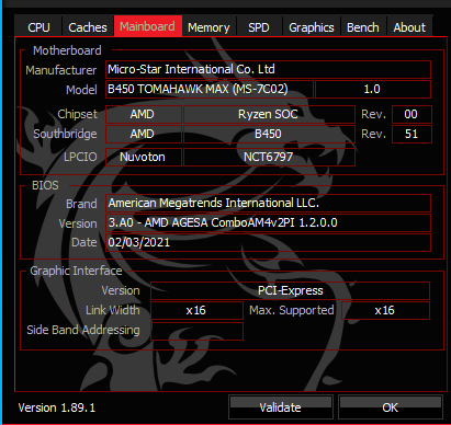

Mainboard: MSI B450 Tomahawk Max (MS-7c02) - BIOS Version 3.A0 - ComboAM4v2PI 1.2.0.0

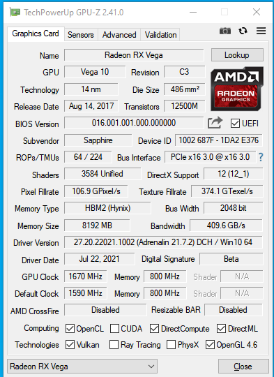

GRAFIK: Sapphire Radeon RX Vega 56 Pulse

Ich hatte gestern mal mit GPU-Z die Temperaturen gelogt, kurz vor dem Absturz sah es wie folgt aus: (die letzten Sekunden vor Absturz)
DateGPU Clock [MHz]Memory Clock [MHz]UVD Clock [MHz]UVD Clock [MHz] 2VCE Clock [MHz]GPU Temperature [°C]GPU Temperature (Hot Spot) [°C]Memory Temperature [°C]GPU VRM Temperature [°C]SOC VRM Temperature [°C]Mem VRM Temperature [°C]Fan Speed (%) [%]Fan Speed (RPM) [RPM]GPU Load [%]Memory Used (Dedicated) [MB]Memory Used (Dynamic) [MB]GPU Chip Power Draw [W]VDDC [V]CPU Temperature [°C]System Memory Used [MB]
10.09.2021 19:111496.0799.033.033.033.061.074.0
66​
69.069.071.0
39​
1298​
98​
5692​
293​
177.0
10.125​
54.1
11936​
10.09.2021 19:111399.0799.033.033.033.061.075.0
67​
69.069.071.0
39​
1309​
99​
5673​
291​
181.0
10.562​
54.1
11936​
10.09.2021 19:111467.0799.033.033.033.062.075.0
67​
69.069.071.0
39​
1312​
99​
5675​
288​
181.0
10.562​
54.0
11940​
