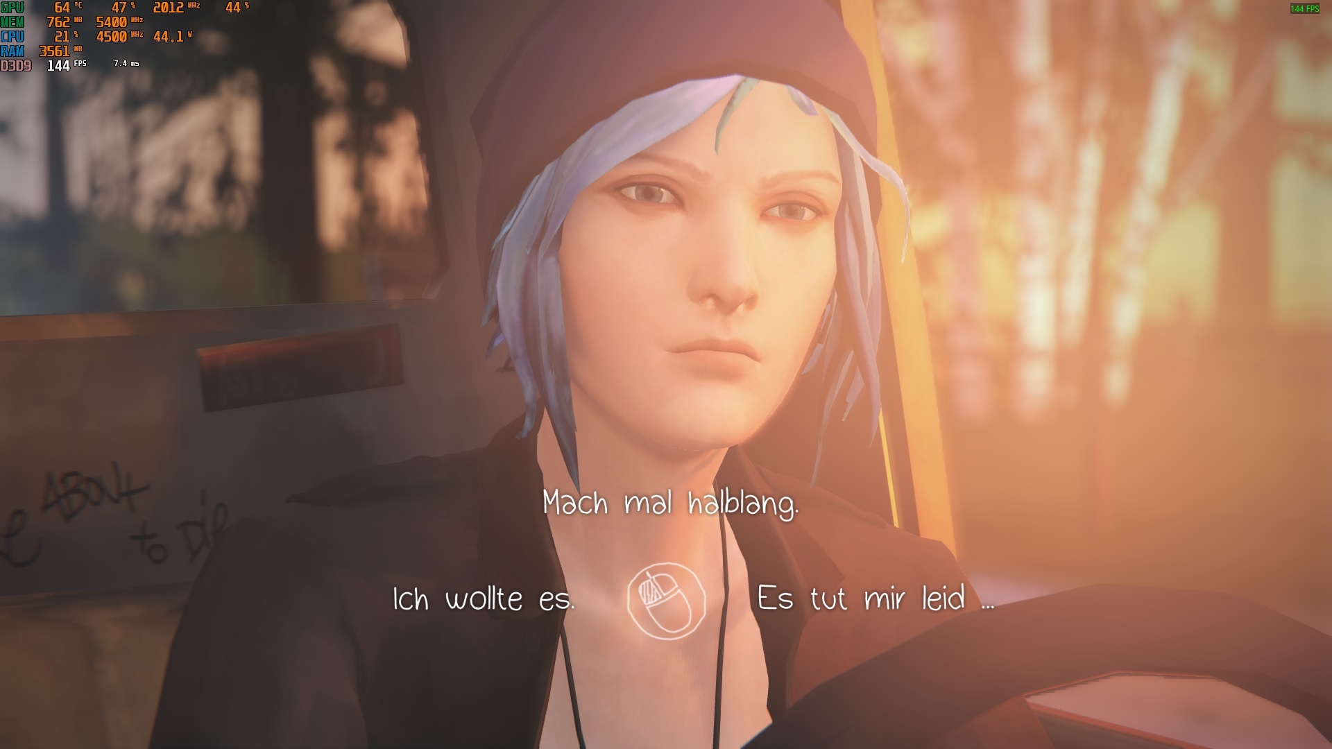

2 Minuten ingame:

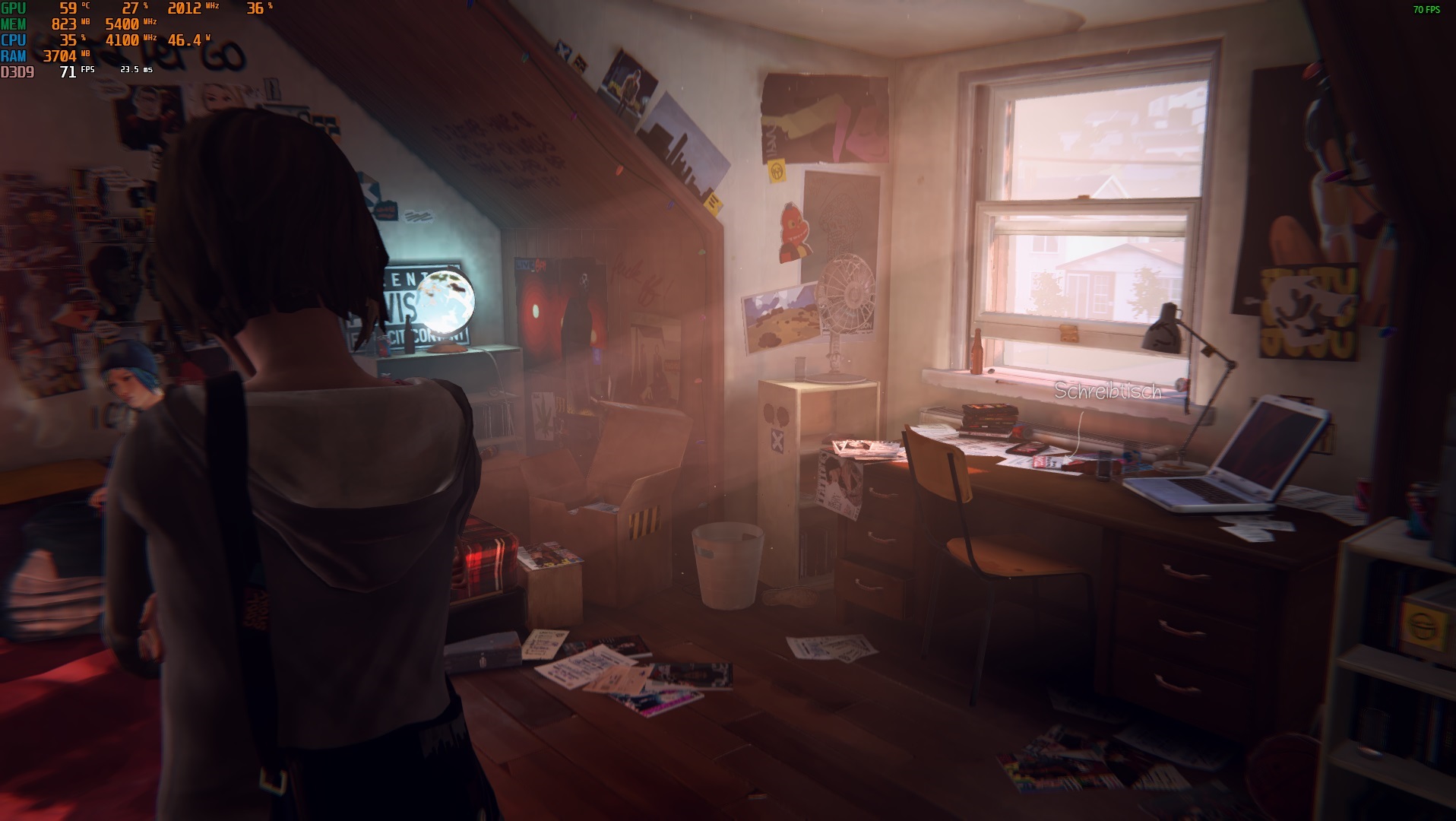

30 Minuten ingame:

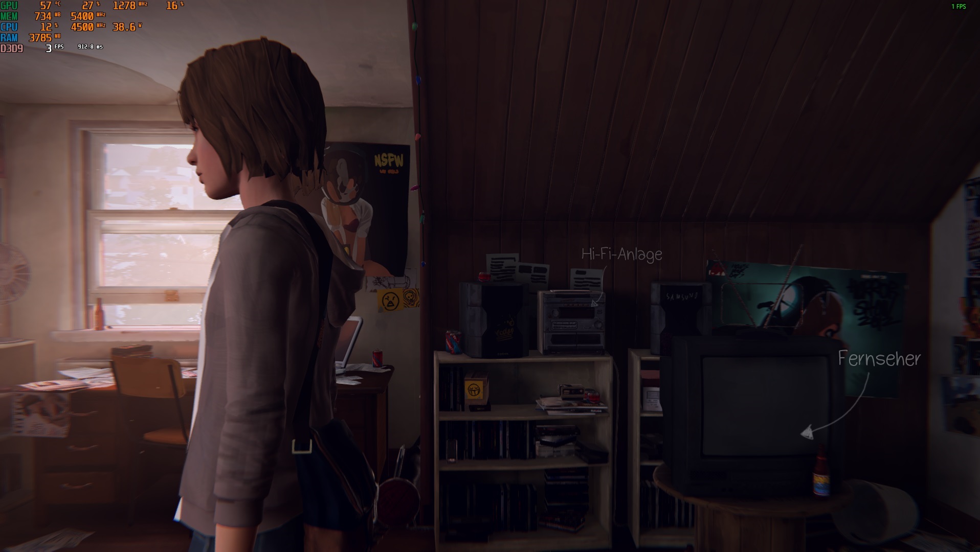

40 Minuten ingame:
