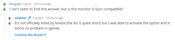

Musst Du fuer Dich entscheiden
https://www.reddit.com/r/Monitors/comments/df3zdy/just_received_the_dell_s3220dgf_32_1440p_va_165hz/
BFF
