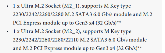

Was sagt das Handbuch zu 2 Stk.?
English5Z390 Extreme4
* M2_1, SATA3_0 and SATA3_1 share lanes. If either one of
them is in use, the others will be disabled.
* M2_2, SATA3_4 and SATA3_5 share lanes. If either one of
• 1 x Ultra M.2 Socket (M2_1), supports M Key type
2230/2242/2260/2280 M.2 SATA3 6.0 Gb/s module and M.2
PCI Express module up to Gen3 x4 (32 Gb/s)**
• 1 x Ultra M.2 Socket (M2_2), supports M Key type
2230/2242/2260/2280/22110 M.2 SATA3 6.0 Gb/s module
and M.2 PCI Express module up to Gen3 x4 (32 Gb/s)**
** Supports Intel® OptaneTM Technology
** Supports NVMe SSD as boot disks
** Supports ASRock U.2 Ki

Kann es sein dass die SSD nicht kompatibel ist (https://www.asrock.com/mb/Intel/Z390 Extreme4/index.de.asp#Storage)
Laut Handbuch sollte es funktionieren:
