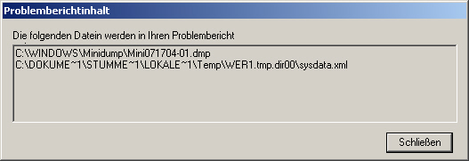

Mein System hat gerade einen Neustart durchgeführt, Fehlermeldung siehe unten. Bräuchte mal einen Tip, wo oder wie ich nachschauen kann, was das bedeutet...

Ok, hängt dran...
  • Mini071704-01.zip
Sieht nach ntoskrnl.exe aus.
Aus Windebug;
BugCheck A, {8562077c, 2, 0, 80516a55}
Probably caused by : ntoskrnl.exe ( nt!IopRemoveLockedDeviceNode+52 )
Followup: MachineOwner
Aus Kernel-Debug;
IRQL_NOT_LESS_OR_EQUAL (a)
An attempt was made to access a pageable (or completely invalid) address at an
interrupt request level (IRQL) that is too high. This is usually
caused by drivers using improper addresses.
If a kernel debugger is available get the stack backtrace.
Arguments:
Arg1: 8562077c, memory referenced
Arg2: 00000002, IRQL
Arg3: 00000000, value 0 = read operation, 1 = write operation
Arg4: 80516a55, address which referenced memory
FOLLOWUP_IP:
80516a55 8b420c mov eax,[edx+0xc]
FOLLOWUP_NAME: MachineOwner
SYMBOL_NAME: nt!IopRemoveLockedDeviceNode+52
MODULE_NAME: nt
IMAGE_NAME: ntoskrnl.exe
DEBUG_FLR_IMAGE_TIMESTAMP: 3ea80977
STACK_COMMAND: kb
BUCKET_ID: 0xA_nt!IopRemoveLockedDeviceNode+52
