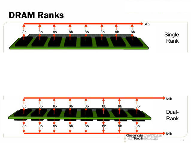

cmok schrieb:
Nein...der Aufbau der RAM Riegel.
DR = Dual Rank
SR = Single Rank
Quelle: https://linustechtips.com/main/topic/1153090-that-is-better-2-dual-rank-dimms-or-4-single-rank/
