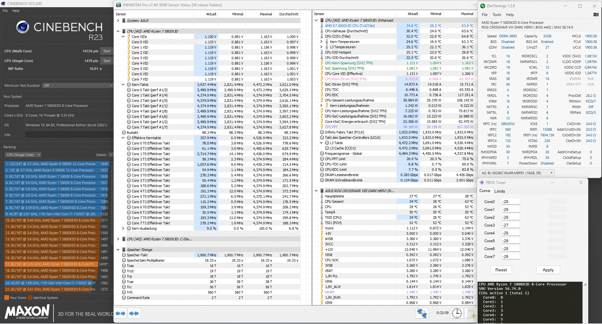

  • AMD R7 5800X3D BCLK 98,3125 MHz Vcore Auto PBO -28 -29 -29 -27 -29 -29 -28 -29 RAM 3800 MHz CL...gif
