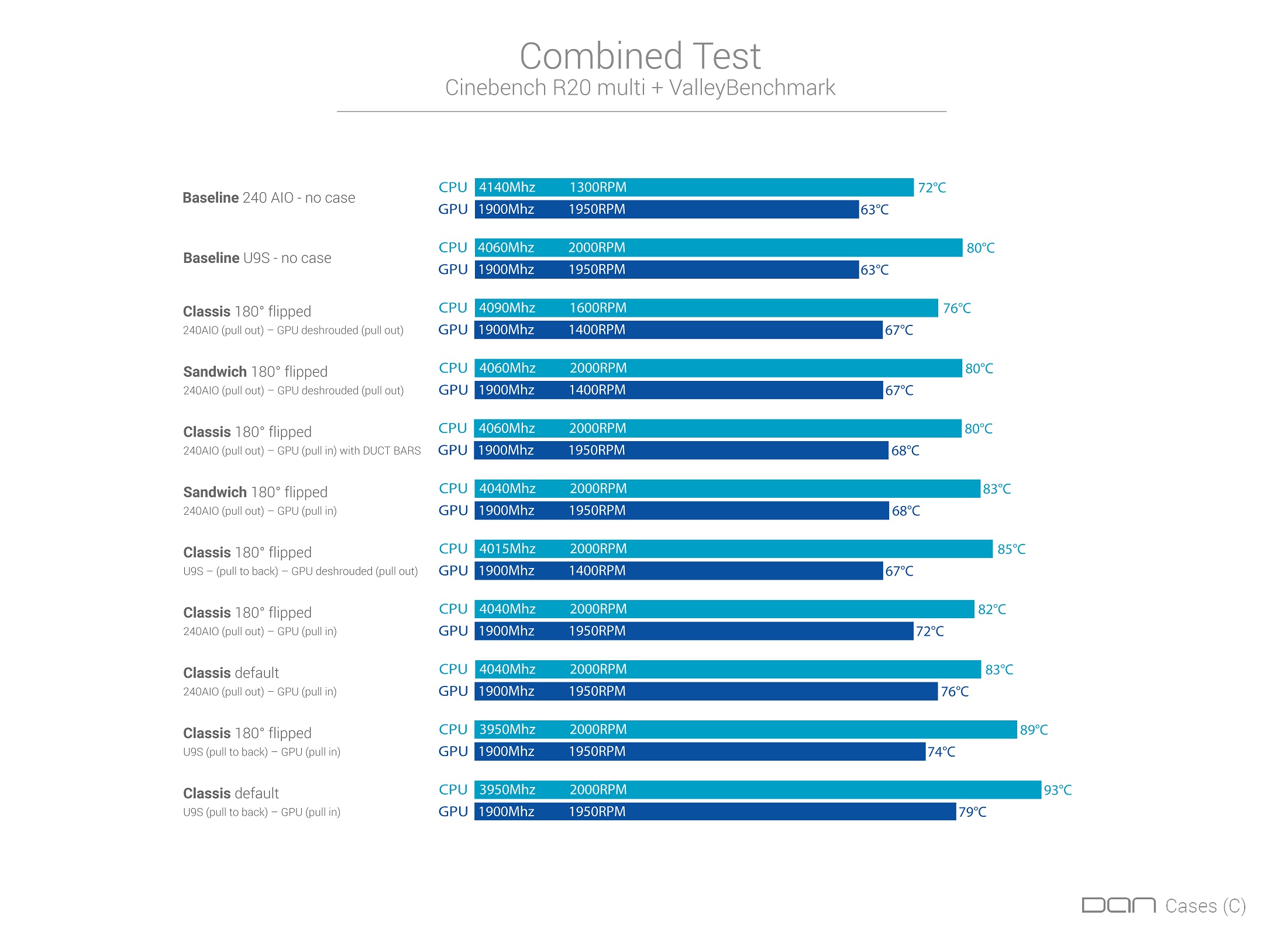

Hier ist der Preview des Temperatur Testbericht des C4-SFX. Ich weiß dies ist ein deutschsprachiges Forum aber die Übersetzung werde ich erst in den nächsten Tagen schaffen:
UPDATE - Thermal Review

4. Test scenario
The first big rule for every thermal test is to create a base line to test against. Every review that does not include these does not show what is possible. So for my thermal test I tested how the GPU perform without a case under heavy load and a second test for the CPU with all different heatsink configurations.
For all tests inside the case I used a combined test of Valley Benchmark and Cinebench R20 Multithread. I used Cinebench because the load is extreme but less enough to give some performance for the GPU to run Valley. A too hard CPU test would result in less GPU load in Valley Benchmark. Valley benchmark is good because it requires less CPU load. There are scenarios where maybe one or the other component could be a bit hotter but not in combined load. Making a thermal test only for one or the other component will not show a balanced temperature. Furthermore, it is important to disable VSYNC because otherwise a FPS cap will lower GPU load. Every test run was made with a room temperature of 22°C and the duration was as long it reached a level where the thermals not changed for 10min.
For the monitoring part I record the CPU/GPU Temp (not hotspot), the CPU/GPU fan speed and the CPU/GPU Clock. I used the newest version of GPU-Z and CoreTemp.

I made no changes to the GPU fan profile. The CPU fan profile was setup in this way, that between 70-80°C the fan speed is increased from 40% to 100%. For the AIO The AIO pump fan profile was setup in this way, that between 80-85°C the speed is increased from 60% to 100%. So in idle and light load the system was inaudible.
Here are the relevant test scenarios I picked out for the review. I did a lot of more testing but I do not thing these are relevant and will make the results even harder to read:
  • Classis-Layout – default – 240AIO (pull out) – GPU (pull in)
  • Classis-Layout – 180° flipped – 240AIO (pull out) – GPU (pull in)
  • Classis-Layout – 180° flipped – 240AIO (pull out) – GPU (pull in) with DUCT BARS
  • Classis-Layout – 180° flipped – 240AIO (pull out) – GPU deshrouded (pull out)
  • Classis-Layout – default – U9S (pull to back) – GPU (pull in)
  • Classis-Layout – 180° flipped – U9S (pull to back) – GPU (pull in)
  • Classis-Layout – 180° flipped – U9S – (pull to back) – GPU deshrouded (pull out))
  • Sandwich Layout – 180° flipped – 240AIO (pull out) – GPU (pull in)
  • Sandwich Layout –180° flipped – 240AIO (pull out) – GPU deshrouded (pull out)
Note: For tests I used a case feet height of 15mm instead of 8mm on the pictures.
5: Test results
The test results are ordered by the overall temperature (CPU + GPU) starting with the lowest.
6. Review of the configurations:
6.1 Classis-Layout – 240AIO
The classic layout with AIO is an easy basic configuration that can result in very good overall temps when done correctly. In my advanced testing I also tested configurations with the AIO pull fresh air in but this results in much worse temperatures for the GPU. If the AIO is setup to move air outside it helps reducing the GPU temperatures because less heat will recycled by it. This does work less good as for the sandwich, because the directed exhaust of the GPU is not pointed to the radiator. To reduce recycling heat even more I installed special duct bars, that can be attached on the left and right side of the GPU (adjustable depending on the size of the GPU) so the GPU fans can only source through the top/bottom. This will result in even better GPU temperatures on the flipped orientation where the GPU sits on the top of the case. The only real left limiting part is here the restrict level of the vent pattern. The best temperatures will be on a deshroud GPU where two 120mm fans pull air through the GPU heatsink out of the case.
6.2 Classis-Layout – default – U9S
This configuration is the weakest inside the C4-SFX. The problem is, that not enough air is pushed outside the case. The GPU will recycle a lot of hot air and while the GPU becomes hotter and hotter this affects also the CPU. In flipped mode it becomes better but only a deshrouded GPU works best. I only can recommend this setup for components with a lower TDP like 3700X and a RTX 2060/2070.
6.3 Sandwich Layout –240 AIO
This is maybe the easiest well-balanced configuration without deshrouding the GPU. But even this is possible with two fans attached to the AIO bracket. The GPU sources fresh air from the side and the AIO pulls the hot air outside the case. Yes this will affect CPU temperatures (not on a critical level) but results in best GPU temps. The GPU exhaust is forced into the direction of the radiator so there will be less heat surrounding the GPU. I also did some testing in default orientation where the radiator is on bottom, but the temperatures on CPU and GPU will be higher because of the too low case feets.
7. Final Thought:
After testing is done I have mixed feelings with this product. Don’t get me wrong this product is on very high level and there would be no problem selling it like it is.
But while I love the flexibility of this product a pure sandwich based AIO case is better for the normal user. And a well-designed sandwich case with flexible riser could be even better because there would be no blocking of one fan on the radiator with the hard riser. Furthermore, with a flex riser and the motherboard attached to the center both side panels will be used for intake.
On the other hand, the hard riser is much cheaper and the classic layout offers also air cooling and no future gen5 gen6 PCIe problems. It is still very small and have a very nice look with the clean front and the power button on the top. The last two weeks, I did further research on layout optimizations so even in 11.2L it could be possible to support 280AIO, 3 Slot sandwich and classic layout. Also, the fan duct bars are a nice feature to improve GPU thermals on the classic layout.
I think I will take a break for 2 weeks to go on with further testing und playing with layouts. Than I decide if I will move back to an flexible riser sandwich case or move on with an optimized classic/sandwich layout that include 3Slot and 280AIO support. While I know this will result in bad feedback if I change product again I like to create a product that is worth to call the second product of DAN Cases. Keep in mind this thread is not about advertising a product that is available soon it is development process with all the back and forth.

@def_: Dann hast du noch nicht die EKWB 240AIO getestet. Bei 60% Drehzahl ist die Pumpe unhörbar. Unter optimalen Bedingungen ist der C14S nur minimal besser als der U9S (2-3°C)

@def_ Ja mit einem 3700X hat der auch bei mir null Probleme. Der im Test verwendete 3900X hat aber fast die doppelte thermische Abgabe (88W vs 145W) und eine nicht heterogene Hitzeverteilung am Heatspreader. Ich gebe dir recht, bei der Drehzahl wird bei dir der C14S unhörbar sein.

@bigdaniel sehr schöner Test, was ich noch sehr interessant finden würde, wie sich die Temps in dem Case verhalten, wenn man mit den Lüfterdrehzahlen deutlich runter geht z.B. max 800rpm, um zu sehen wie Silentfähig das Ganze ist. In meinem A4 z.B klappt es den CPU kühler auf max 800rpm und die GPU Lüfter auf max 1200/1300rpm laufen zu lassen (Allerdings auch nur ein i5 8400 und GTX 980 verbaut)

Auch wenn es vermutlich eine doofe Frage ist, aber was sind "duct bars"?
War die Grafikkarte bei "deshrouded" komplett mit einem anderen Kühler und anderen Lüftern oder wurden da nur die werksseitigen Lüfter entfernt und gegen Case-Lüfter getauscht?
