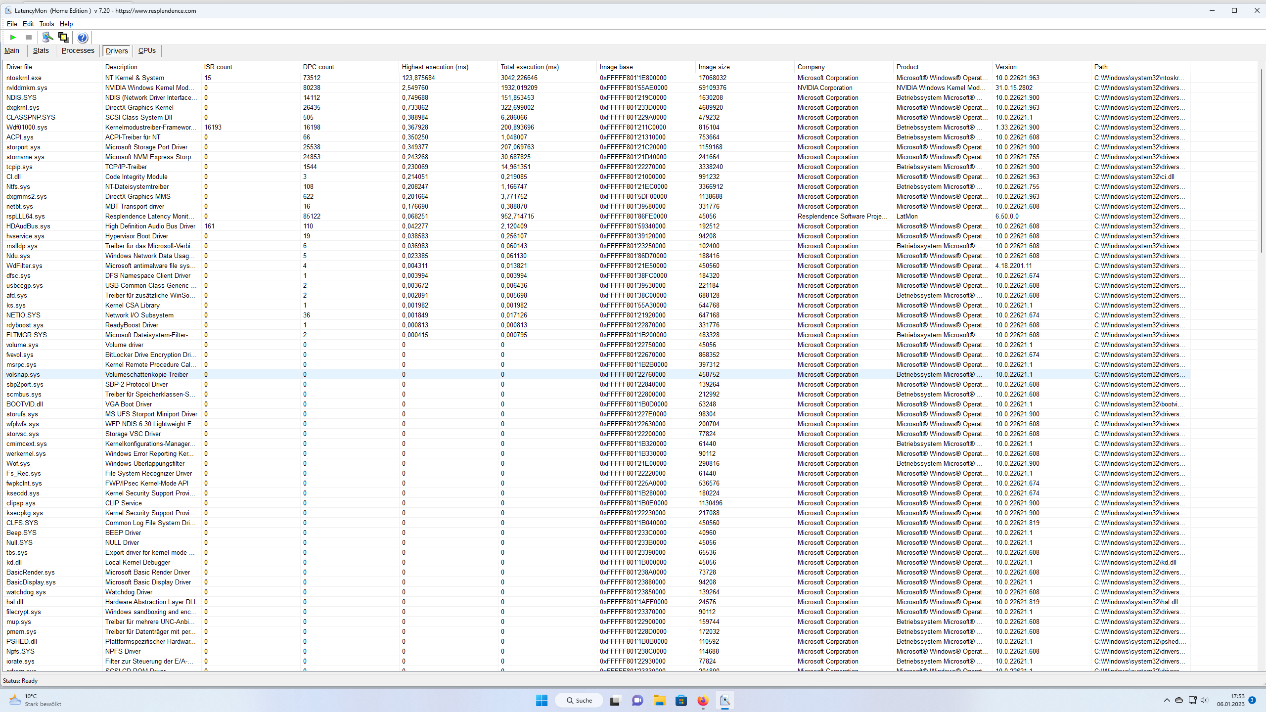

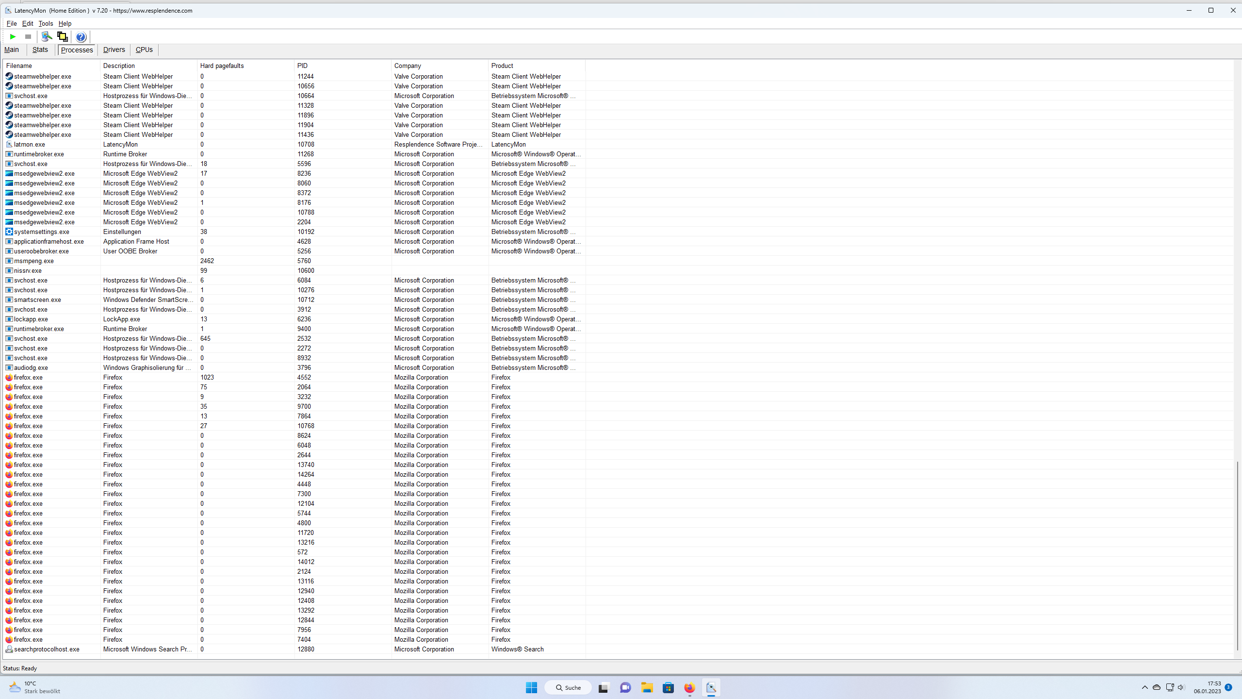

CONCLUSION
_________________________________________________________________________________________________________
Your system appears to be having trouble handling real-time audio and other tasks. You are likely to experience buffer underruns appearing as drop outs, clicks or pops. One or more DPC routines that belong to a driver running in your system appear to be executing for too long. One
problem may be related to power management, disable CPU throttling settings in Control Panel and BIOS setup. Check for BIOS updates.
LatencyMon has been analyzing your system for 0:21:38 (h:mm:ss) on all processors.
SYSTEM INFORMATION
Computer name: AURI
OS version: Windows 11, 10.0, version 2009, build: 22621 (x64)
Hardware: System Product Name, ASUS
BIOS: 2015
CPU: GenuineIntel 12th Gen Intel(R) Core(TM) i7-12700F
Logical processors: 20
Processor groups: 1
Processor group size: 20
RAM: 32581 MB total
CPU SPEED
Reported CPU speed (WMI): 210 MHz
Reported CPU speed (registry): 2112 MHz
Note: reported execution times may be calculated based on a fixed reported CPU speed. Disable variable speed settings like Intel Speed Step and AMD Cool N Quiet in the BIOS setup for more accurate results.
MEASURED INTERRUPT TO USER PROCESS LATENCIES
The interrupt to process latency reflects the measured interval that a usermode process needed to respond to a hardware request from the moment the interrupt service routine started execution. This includes the scheduling and execution of a DPC routine, the signaling of an event
and the waking up of a usermode thread from an idle wait state in response to that event.
Highest measured interrupt to process latency (µs): 5387,40
Average measured interrupt to process latency (µs): 26,371253
Highest measured interrupt to DPC latency (µs): 567,70
Average measured interrupt to DPC latency (µs): 5,473516
REPORTED ISRs
Interrupt service routines are routines installed by the OS and device drivers that execute in response to a hardware interrupt signal.
Highest ISR routine execution time (µs): 208,817708
Driver with highest ISR routine execution time: Wdf01000.sys - Kernelmodustreiber-Frameworklaufzeit, Microsoft Corporation
Highest reported total ISR routine time (%): 0,000044
Driver with highest ISR total time: Wdf01000.sys - Kernelmodustreiber-Frameworklaufzeit, Microsoft Corporation
Total time spent in ISRs (%) 0,000049
ISR count (execution time <250 µs): 16369
ISR count (execution time 250-500 µs): 0
ISR count (execution time 500-1000 µs): 0
ISR count (execution time 1000-2000 µs): 0
ISR count (execution time 2000-4000 µs): 0
ISR count (execution time >=4000 µs): 0
REPORTED DPCs
DPC routines are part of the interrupt servicing dispatch mechanism and disable the possibility for a process to utilize the CPU while it is interrupted until the DPC has finished execution.
Highest DPC routine execution time (µs): 123875,684186
Driver with highest DPC routine execution time: ntoskrnl.exe - NT Kernel & System, Microsoft Corporation
Highest reported total DPC routine time (%): 0,007441
Driver with highest DPC total execution time: ntoskrnl.exe - NT Kernel & System, Microsoft Corporation
Total time spent in DPCs (%) 0,026401
DPC count (execution time <250 µs): 346590
DPC count (execution time 250-500 µs): 0
DPC count (execution time 500-10000 µs): 2480
DPC count (execution time 1000-2000 µs): 2
DPC count (execution time 2000-4000 µs): 3
DPC count (execution time >=4000 µs): 1

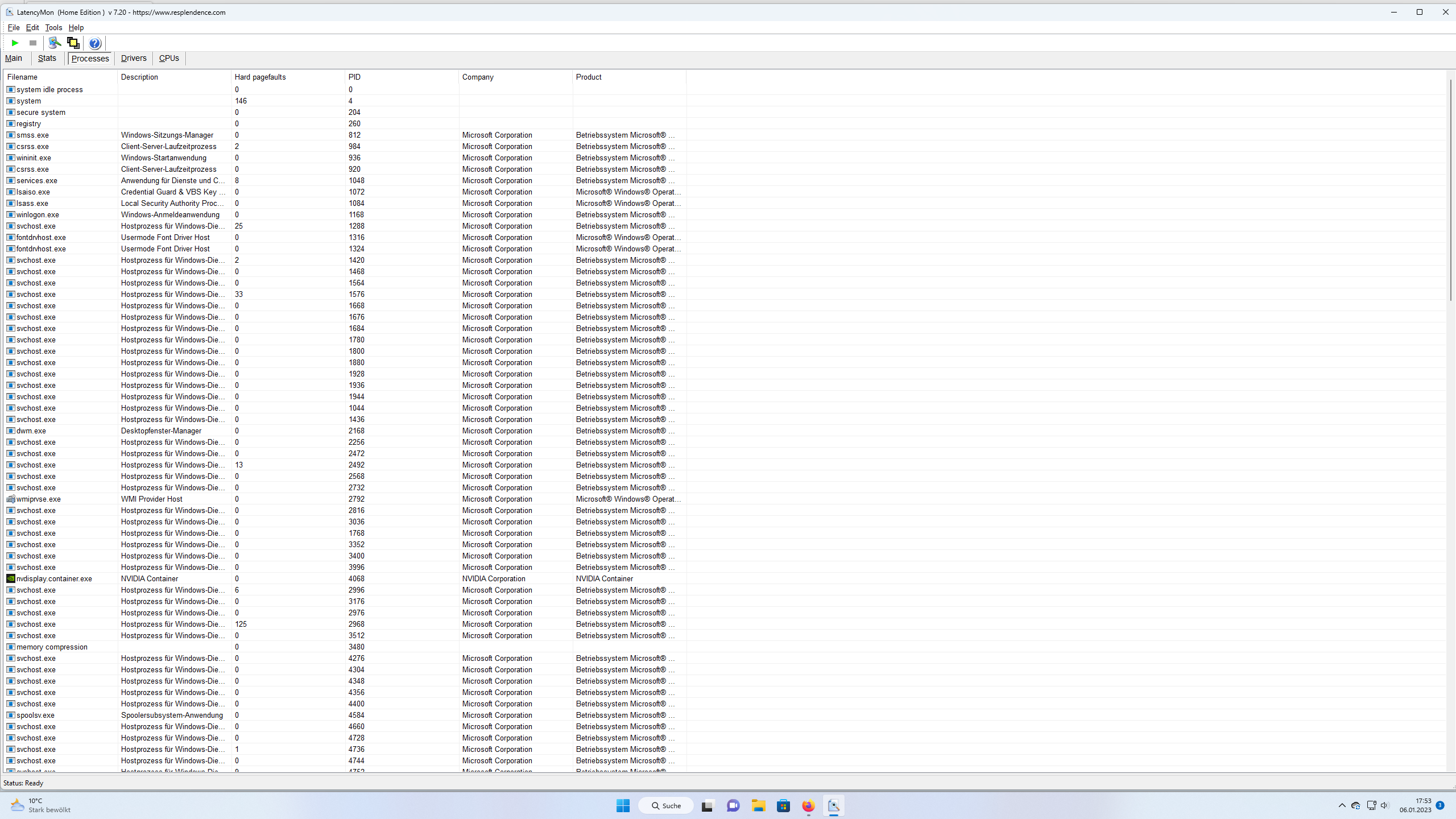

REPORTED HARD PAGEFAULTS
Hard pagefaults are events that get triggered by making use of virtual memory that is not resident in RAM but backed by a memory mapped file on disk. The process of resolving the hard pagefault requires reading in the memory from disk while the process is interrupted and blocked
from execution.
NOTE: some processes were hit by hard pagefaults. If these were programs producing audio, they are likely to interrupt the audio stream resulting in dropouts, clicks and pops. Check the Processes tab to see which programs were hit.
Process with highest pagefault count: msmpeng.exe
Total number of hard pagefaults 14319
Hard pagefault count of hardest hit process: 2462
Number of processes hit: 40

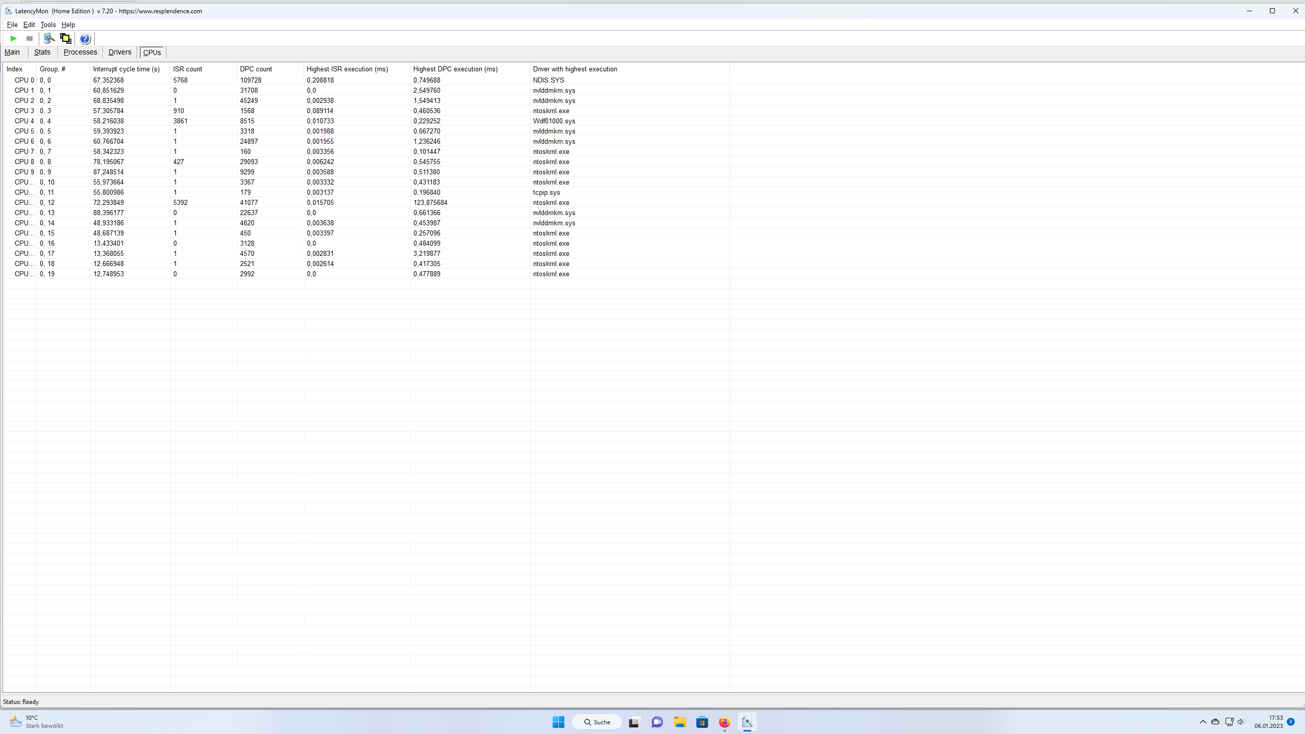

PER CPU DATA
CPU 0 Interrupt cycle time (s): 67,352369
CPU 0 ISR highest execution time (µs): 208,817708
CPU 0 ISR total execution time (s): 0,004941
CPU 0 ISR count: 5768
CPU 0 DPC highest execution time (µs): 749,68750
CPU 0 DPC total execution time (s): 1,200327
CPU 0 DPC count: 109728
CPU 1 Interrupt cycle time (s): 60,851630
CPU 1 ISR highest execution time (µs): 0,0
CPU 1 ISR total execution time (s): 0,0
CPU 1 ISR count: 0
CPU 1 DPC highest execution time (µs): 2549,760417
CPU 1 DPC total execution time (s): 0,411806
CPU 1 DPC count: 31708
CPU 2 Interrupt cycle time (s): 68,835498
CPU 2 ISR highest execution time (µs): 2,93750
CPU 2 ISR total execution time (s): 0,000003
CPU 2 ISR count: 1
CPU 2 DPC highest execution time (µs): 1549,412879
CPU 2 DPC total execution time (s): 1,166057
CPU 2 DPC count: 45249
CPU 3 Interrupt cycle time (s): 57,305784
CPU 3 ISR highest execution time (µs): 89,113636
CPU 3 ISR total execution time (s): 0,000877
CPU 3 ISR count: 910
CPU 3 DPC highest execution time (µs): 460,535985
CPU 3 DPC total execution time (s): 0,016613
CPU 3 DPC count: 1568
CPU 4 Interrupt cycle time (s): 58,216038
CPU 4 ISR highest execution time (µs): 10,732955
CPU 4 ISR total execution time (s): 0,002299
CPU 4 ISR count: 3861
CPU 4 DPC highest execution time (µs): 229,252367
CPU 4 DPC total execution time (s): 0,059405
CPU 4 DPC count: 8515
CPU 5 Interrupt cycle time (s): 59,393923
CPU 5 ISR highest execution time (µs): 1,988163
CPU 5 ISR total execution time (s): 0,000002
CPU 5 ISR count: 1
CPU 5 DPC highest execution time (µs): 667,269886
CPU 5 DPC total execution time (s): 0,053104
CPU 5 DPC count: 3318
CPU 6 Interrupt cycle time (s): 60,766705
CPU 6 ISR highest execution time (µs): 1,955019
CPU 6 ISR total execution time (s): 0,000002
CPU 6 ISR count: 1
CPU 6 DPC highest execution time (µs): 1236,245739
CPU 6 DPC total execution time (s): 0,376757
CPU 6 DPC count: 24897
CPU 7 Interrupt cycle time (s): 58,342324
CPU 7 ISR highest execution time (µs): 3,355587
CPU 7 ISR total execution time (s): 0,000003
CPU 7 ISR count: 1
CPU 7 DPC highest execution time (µs): 101,446970
CPU 7 DPC total execution time (s): 0,000843
CPU 7 DPC count: 160
CPU 8 Interrupt cycle time (s): 78,195068
CPU 8 ISR highest execution time (µs): 6,242424
CPU 8 ISR total execution time (s): 0,000329
CPU 8 ISR count: 427
CPU 8 DPC highest execution time (µs): 545,755208
CPU 8 DPC total execution time (s): 0,825263
CPU 8 DPC count: 29093
CPU 9 Interrupt cycle time (s): 87,248514
CPU 9 ISR highest execution time (µs): 3,588068
CPU 9 ISR total execution time (s): 0,000004
CPU 9 ISR count: 1
CPU 9 DPC highest execution time (µs): 511,380208
CPU 9 DPC total execution time (s): 0,304128
CPU 9 DPC count: 9299
CPU 10 Interrupt cycle time (s): 55,973665
CPU 10 ISR highest execution time (µs): 3,332386
CPU 10 ISR total execution time (s): 0,000003
CPU 10 ISR count: 1
CPU 10 DPC highest execution time (µs): 431,183239
CPU 10 DPC total execution time (s): 0,033695
CPU 10 DPC count: 3367
CPU 11 Interrupt cycle time (s): 55,800987
CPU 11 ISR highest execution time (µs): 3,136837
CPU 11 ISR total execution time (s): 0,000003
CPU 11 ISR count: 1
CPU 11 DPC highest execution time (µs): 196,840436
CPU 11 DPC total execution time (s): 0,001493
CPU 11 DPC count: 179
CPU 12 Interrupt cycle time (s): 72,293850
CPU 12 ISR highest execution time (µs): 15,705019
CPU 12 ISR total execution time (s): 0,004279
CPU 12 ISR count: 5392
CPU 12 DPC highest execution time (µs): 123875,684186
CPU 12 DPC total execution time (s): 1,531167
CPU 12 DPC count: 41077
CPU 13 Interrupt cycle time (s): 88,396177
CPU 13 ISR highest execution time (µs): 0,0
CPU 13 ISR total execution time (s): 0,0
CPU 13 ISR count: 0
CPU 13 DPC highest execution time (µs): 661,366477
CPU 13 DPC total execution time (s): 0,617223
CPU 13 DPC count: 22637
CPU 14 Interrupt cycle time (s): 48,933187
CPU 14 ISR highest execution time (µs): 3,638258
CPU 14 ISR total execution time (s): 0,000004
CPU 14 ISR count: 1
CPU 14 DPC highest execution time (µs): 453,987216
CPU 14 DPC total execution time (s): 0,044256
CPU 14 DPC count: 4620
CPU 15 Interrupt cycle time (s): 48,687139
CPU 15 ISR highest execution time (µs): 3,396780
CPU 15 ISR total execution time (s): 0,000003
CPU 15 ISR count: 1
CPU 15 DPC highest execution time (µs): 257,095644
CPU 15 DPC total execution time (s): 0,003132
CPU 15 DPC count: 450
CPU 16 Interrupt cycle time (s): 13,433402
CPU 16 ISR highest execution time (µs): 0,0
CPU 16 ISR total execution time (s): 0,0
CPU 16 ISR count: 0
CPU 16 DPC highest execution time (µs): 484,098958
CPU 16 DPC total execution time (s): 0,035156
CPU 16 DPC count: 3128
CPU 17 Interrupt cycle time (s): 13,368056
CPU 17 ISR highest execution time (µs): 2,830966
CPU 17 ISR total execution time (s): 0,000003
CPU 17 ISR count: 1
CPU 17 DPC highest execution time (µs): 3219,876894
CPU 17 DPC total execution time (s): 0,089339
CPU 17 DPC count: 4570
CPU 18 Interrupt cycle time (s): 12,666949
CPU 18 ISR highest execution time (µs): 2,613636
CPU 18 ISR total execution time (s): 0,000003
CPU 18 ISR count: 1
CPU 18 DPC highest execution time (µs): 417,304924
CPU 18 DPC total execution time (s): 0,036754
CPU 18 DPC count: 2521
CPU 19 Interrupt cycle time (s): 12,748954
CPU 19 ISR highest execution time (µs): 0,0
CPU 19 ISR total execution time (s): 0,0
CPU 19 ISR count: 0
CPU 19 DPC highest execution time (µs): 477,888731
CPU 19 DPC total execution time (s): 0,051425
CPU 19 DPC count: 2992
:heul:

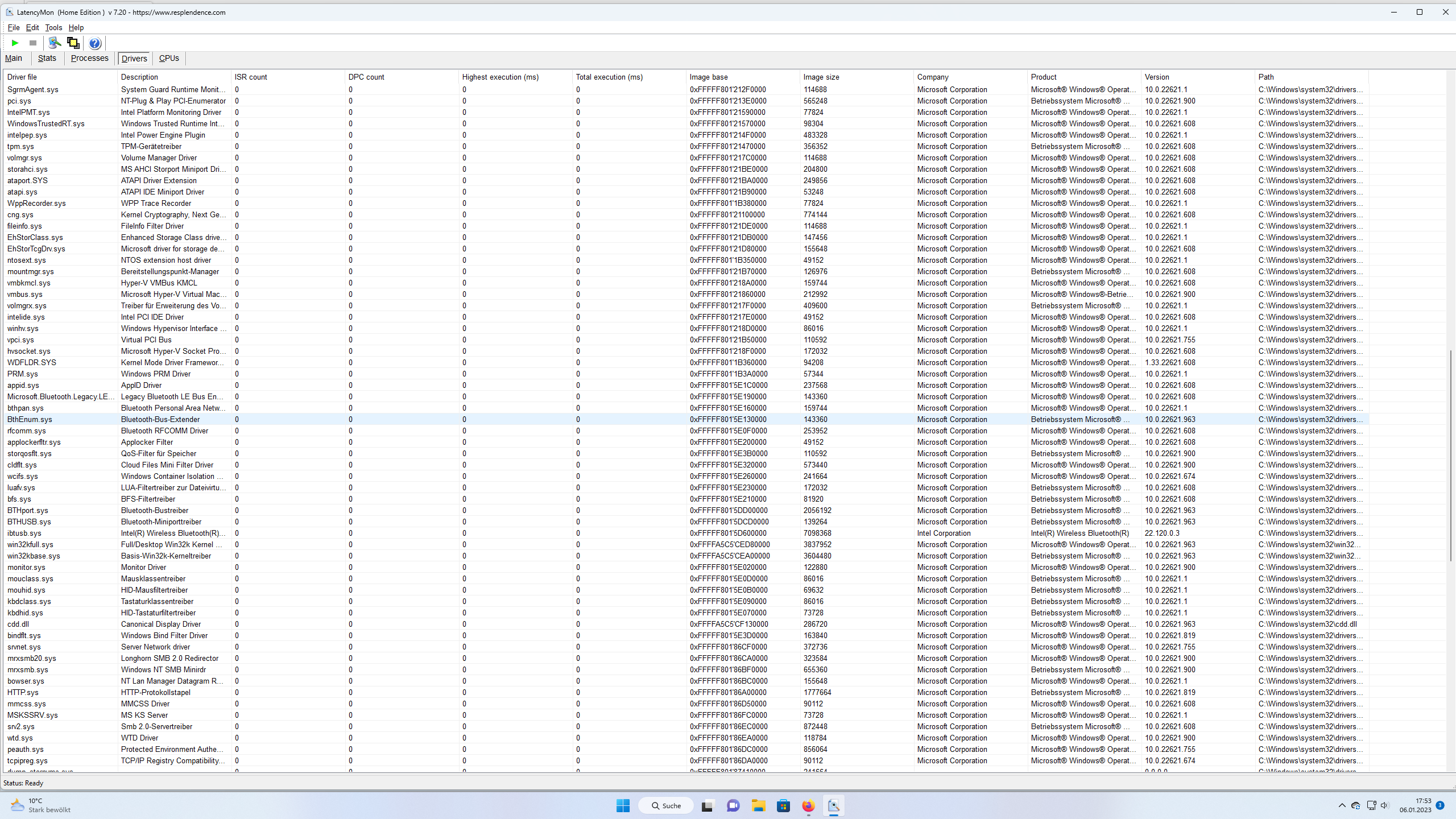

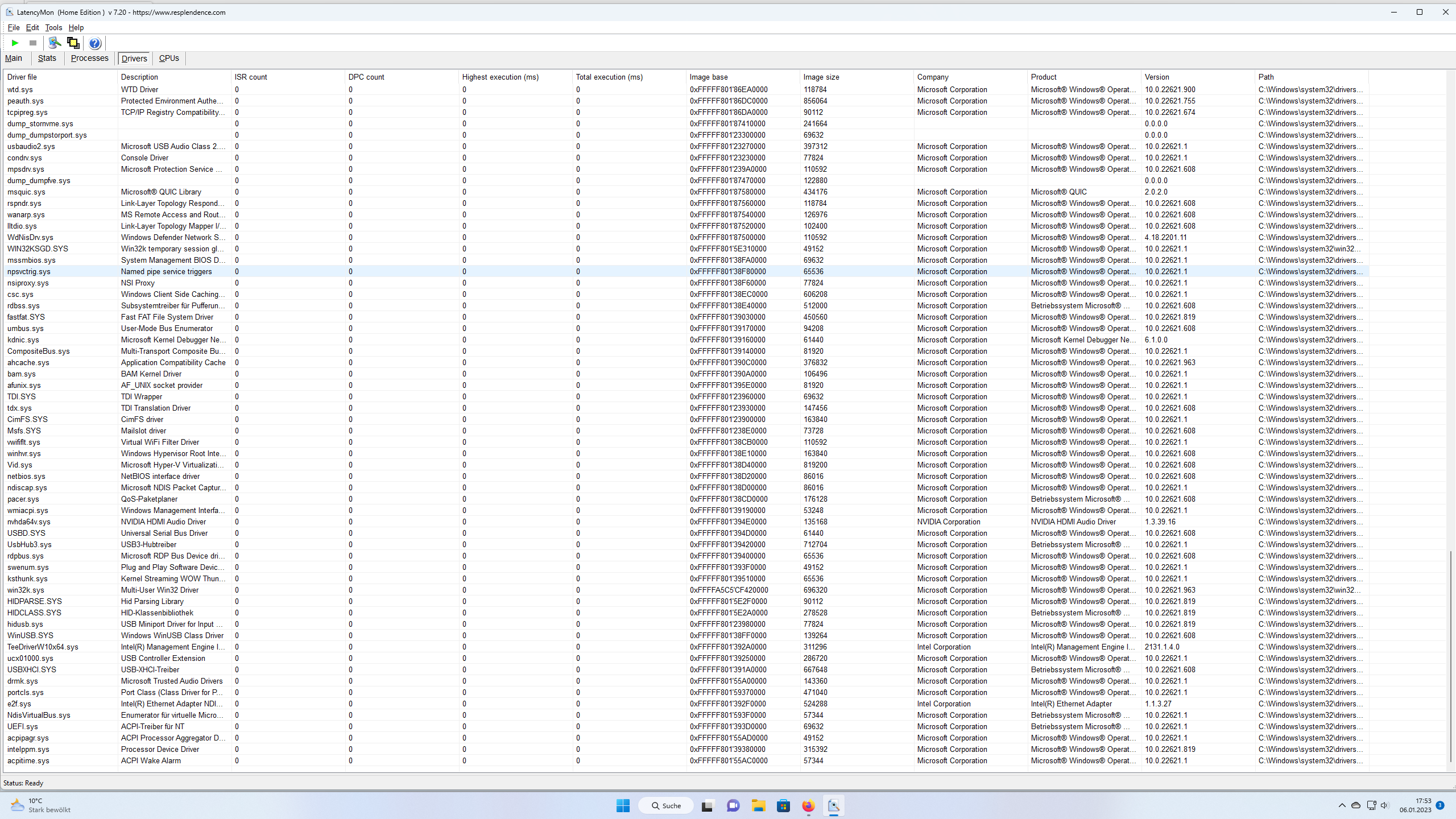

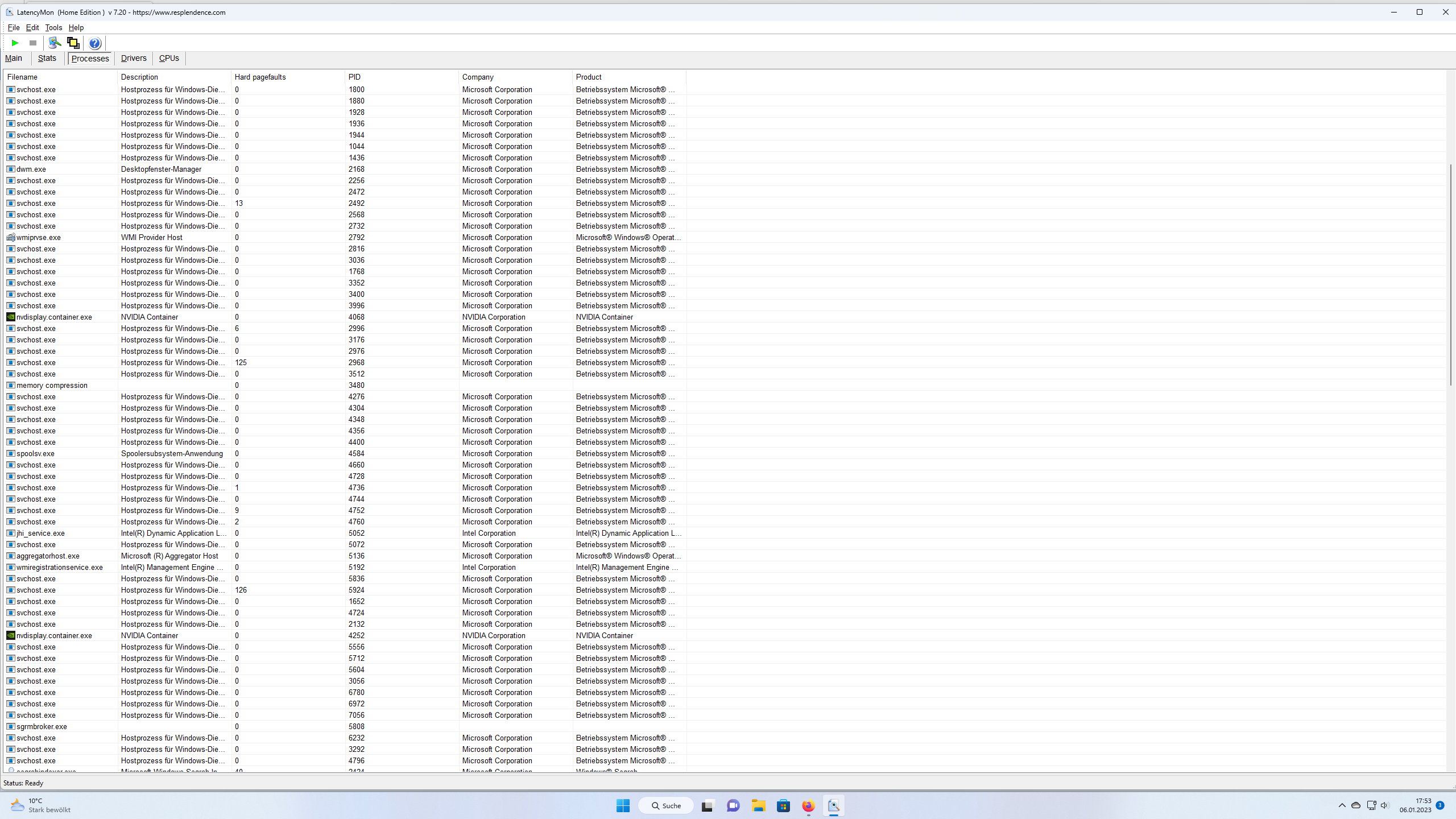

Es ist wieder das gleiche wie bei captiva->pc ist an, ich ziehe displayport kabel raus, ruckler sind weg wenn ich den wieder reinstecke.
ich starte pc neu: ruckler sind wieder da. displayportkabel rausstecken und wieder dran machen, ruckler weg
also ein ausgetauschter displayportkabel hilft auch nicht. also war der captiva rechner doch nicht schuld. -.-
ich muss dann jedes mal wenn ich ein spiel gestartet habe den kabel neu reinmachen aber das schadet wahrscheinlich oder?
Ich würde das probieren, was Alexander2 in seinem letzten Post (#199) vorgeschlagen hat.
Den Guide von IgorsLab befolgen und die Graka in MSI Modus laufen lassen.
Lesen, Jedes Wort.
Ich hatte da noch kein Problem mit und muss ehrlich sagen ich habs noch nicht komplett durchgelesen. es geht aber um Latenzen und durch umstellen vermeiden der gleichen.
Und jemand anderes hats auch schon geschafft, nachdem ich ganz minimal gestupst habe mit dem Hinweis, da ist noch ne Seite 2.
Also Bitte von anfang bis ende durchlesen <3
